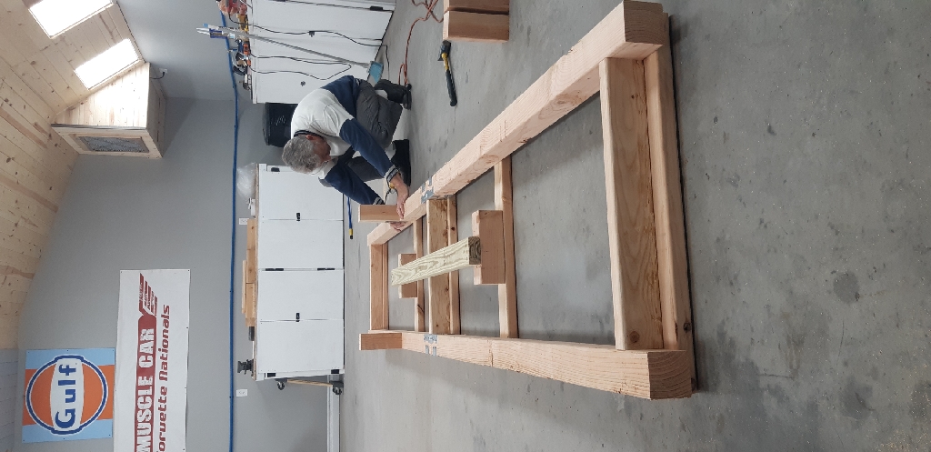

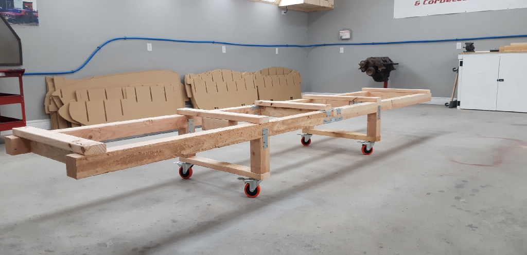

Now that I'm back home and Crusty is down for the count with a bad main harness, I turned my attention to the 507 and getting the buck fabricated up. The buck frame consists of 4x4 posts and after a few hours, voila! A gurney! Wait, that's not exactly PC right now. There's 15 stations and all are exactly 10" on center. I marked them all and as you can see with the drill marks provided by the 3D scanning company, there's a corresponding number to indicate the position. It slipped right in! Woohoo!
I should have this built today...two weeks until paint! More to come!!
Cheers
Dave

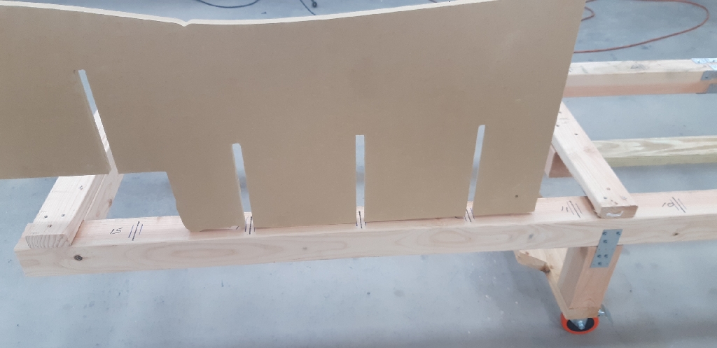

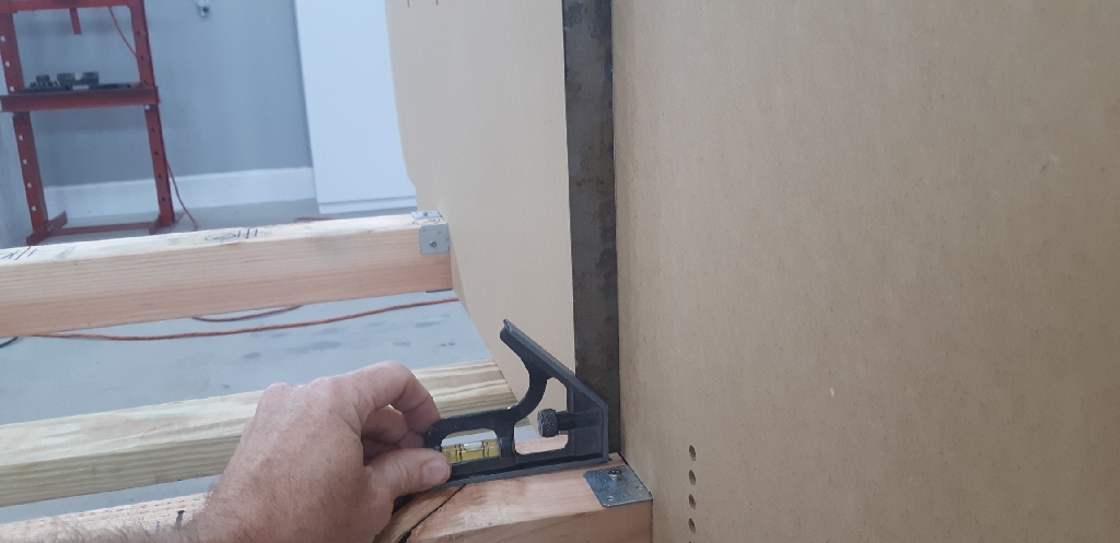

So with every panel being 10" on center, I laid that all out but still wanted to verify everything before I started assembling the buck. Using one of the longitudinal stations, I double checked the 10" marks. Also, once positioned I checked to make sure the stations were square. They are tight on the frame so they hold in position well. If that didn't happen I think I'd be chasing a set of very large Dominos!
Cheers
Dave

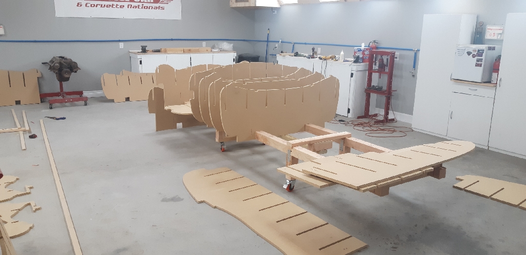

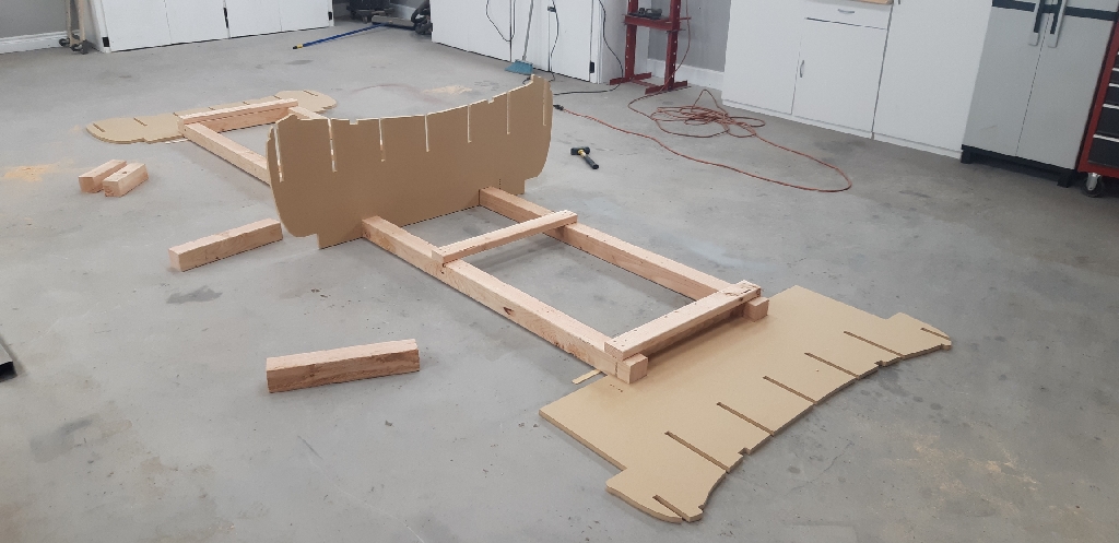

I started in the center and built outwards. Seems to be the best balance on the gurney, er.. body dolly .
Once the stations were lined up I used the 1.5" stringers to hold them together while I installed the longitude stations. Some banging and taping here and there, but they all interlocked pretty easily! I'm just so pleased with this design!
Cheers
Dave

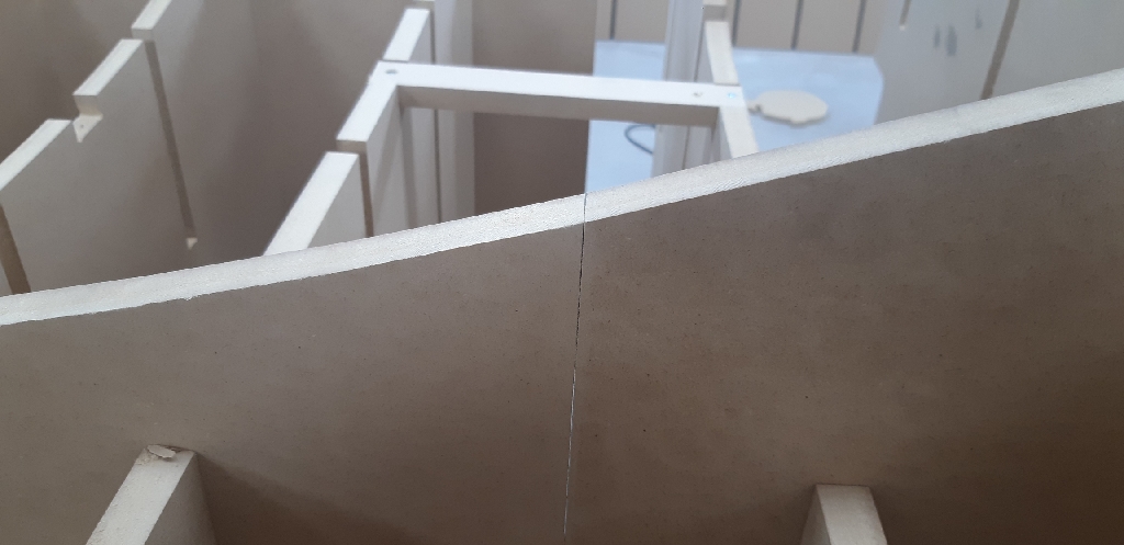

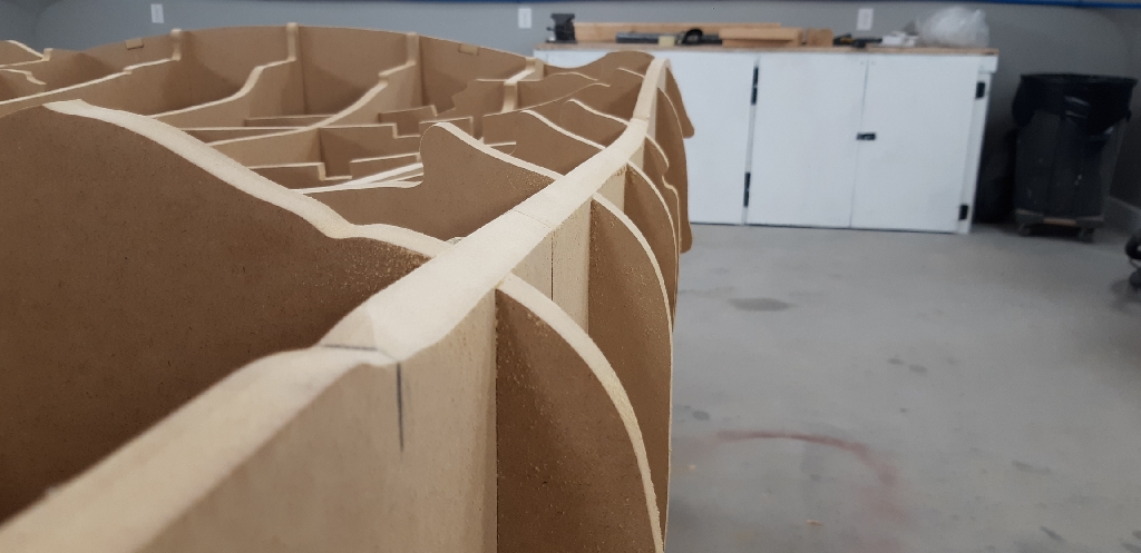

The parts came came together so precisely that there's maybe 1/16th of a gap on the front and back sections. I mean, if that's not adhering to BMW exacting standards, I don't know what is!
The initial stage of the buck is complete but there is some detail work that needs to be done now. Where the stations come together the angle is sharp and needs to be sanded flush. You can see this in my photos of before and after. This will need to be done all around the car. After that, I'll use some stringers and outline the interior, wheel wells, and then the front and back of the body will be formed from solid wood.
