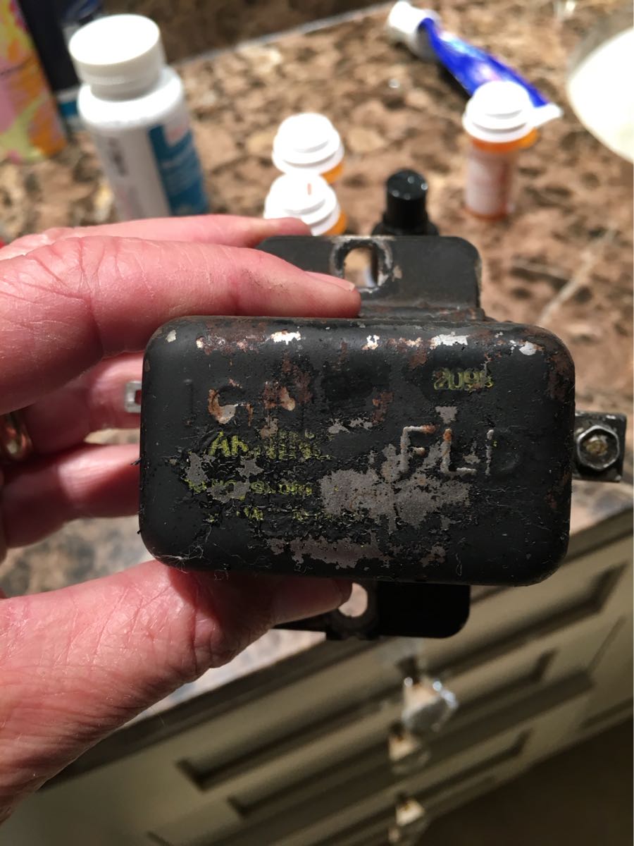

Here is my VR after I removed the rattle can paint. Notice the font, I said it looks green in an earlier post, but meant yellow. Car was built early November 68.

Is the upside down # to the right 1608?? If so then I'm confused Chrysler used 3 digit in 61-9 Example 349 would be 34th. week of 1969.
Also if you need wiring you have to go through Year One or Classic since M+H doesn't sell direct for Mopar.
I used to buy these with electronic guts and then buy an NOS and swap covers.

Ron thanks for the help. Lots of good info.
Not positive what the date code is on the VR. Now that I look at the number it may be 209. Would that be the 20th week of 1969? If so then a replacement?
I have bought all new wiring for the car mostly from Year One except for one wiper harness and automatic transmission harness which those came from Evans via Dante's.
Yes, I have seen the electronic VR's and considered switching the tops especially for my 69 Camaro's. Easy and cheap, came with the mid year Vettes.

Yes your right your date code is 209 so must have been replaced early on in life.
