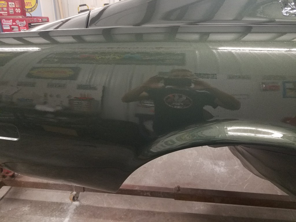

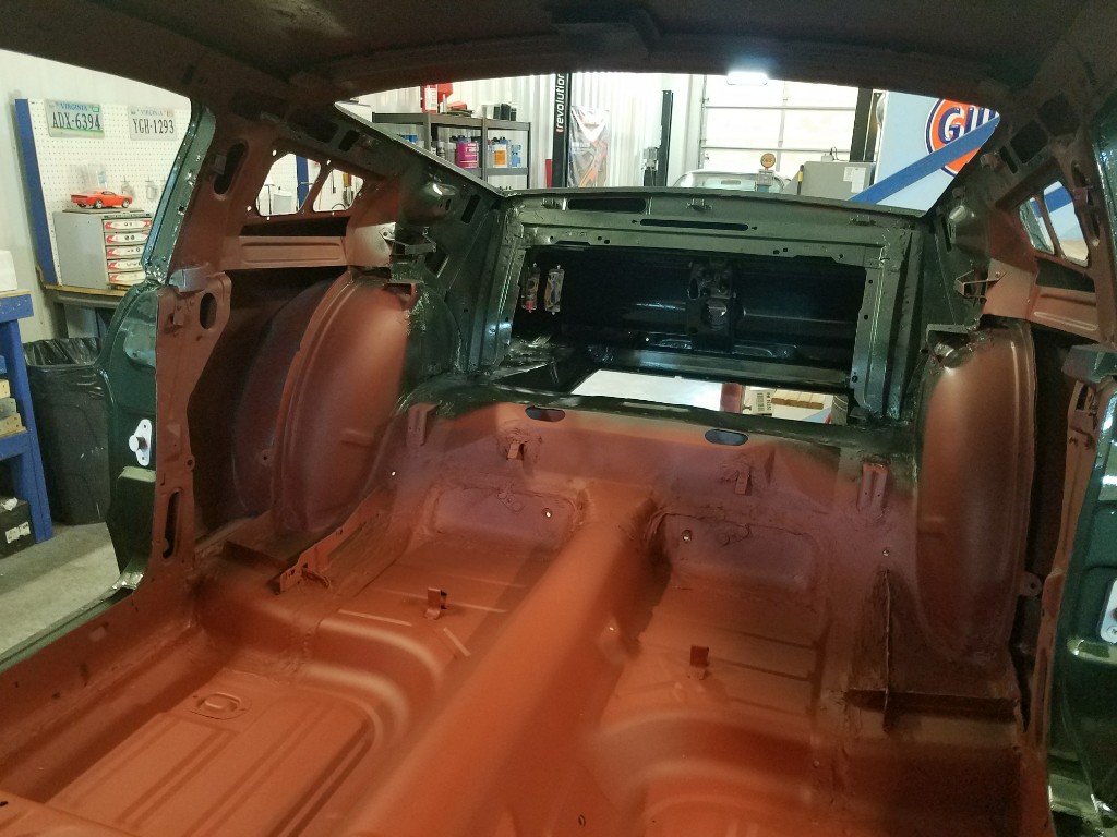

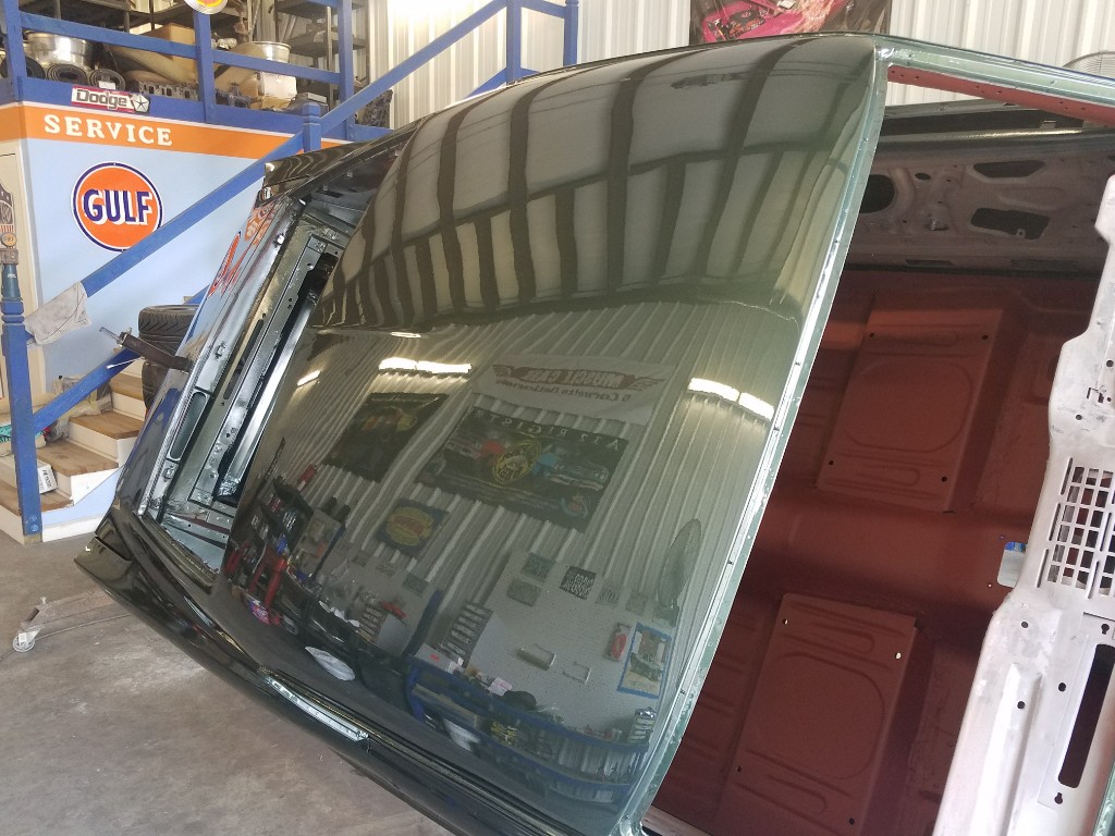

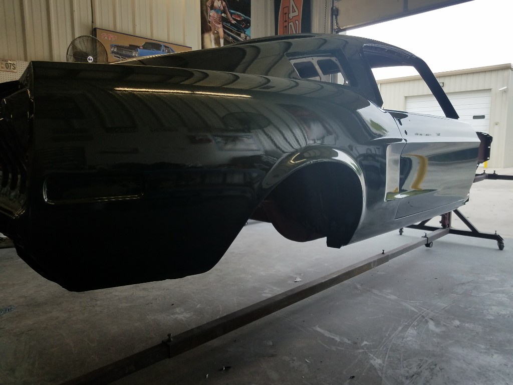

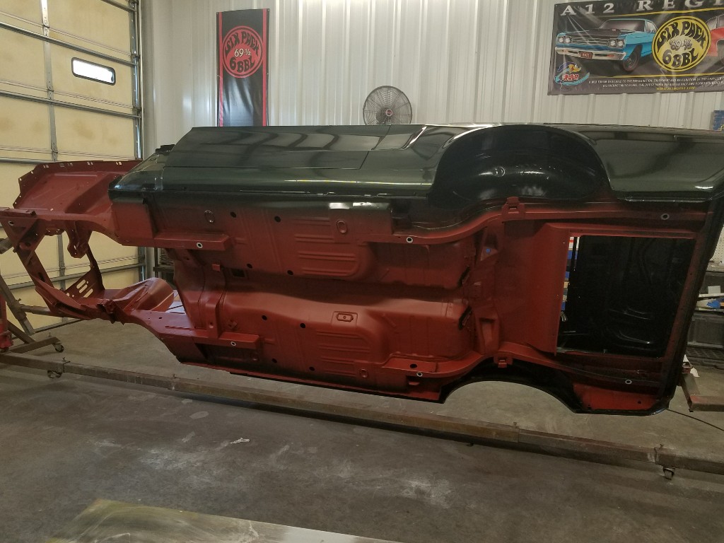

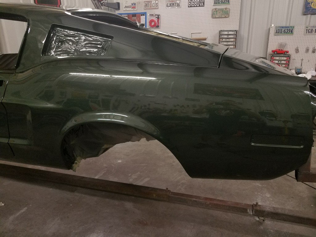

Pa...pa....pa...paaaaaaiiiint!!
You'll all be happy to know, that the run on the fender, matches the run on the quarter.... which matches the run on the trunk.... which matches the run on the other door! But seriously, just two runs to sand out in the last coat of clear. DCU2021 Mike..Medium reducer. This time, no Mothra landed in the paint! Why you ask? Remember.... he's already entombed in the Bee's fender!
I did a few details on the undercarriage too. Painted the primer circles on the frame areas where it was bolted to the assembly line jig for paint. Also used a brush and more neatly applied the pinch weld blackout.
More later this week when I spray the engine bay and sound deadener on!
Hope you guys like!

Kind of hard to photograph this Highland Green..... can't wait to get the fenders back on and cut and buff!
