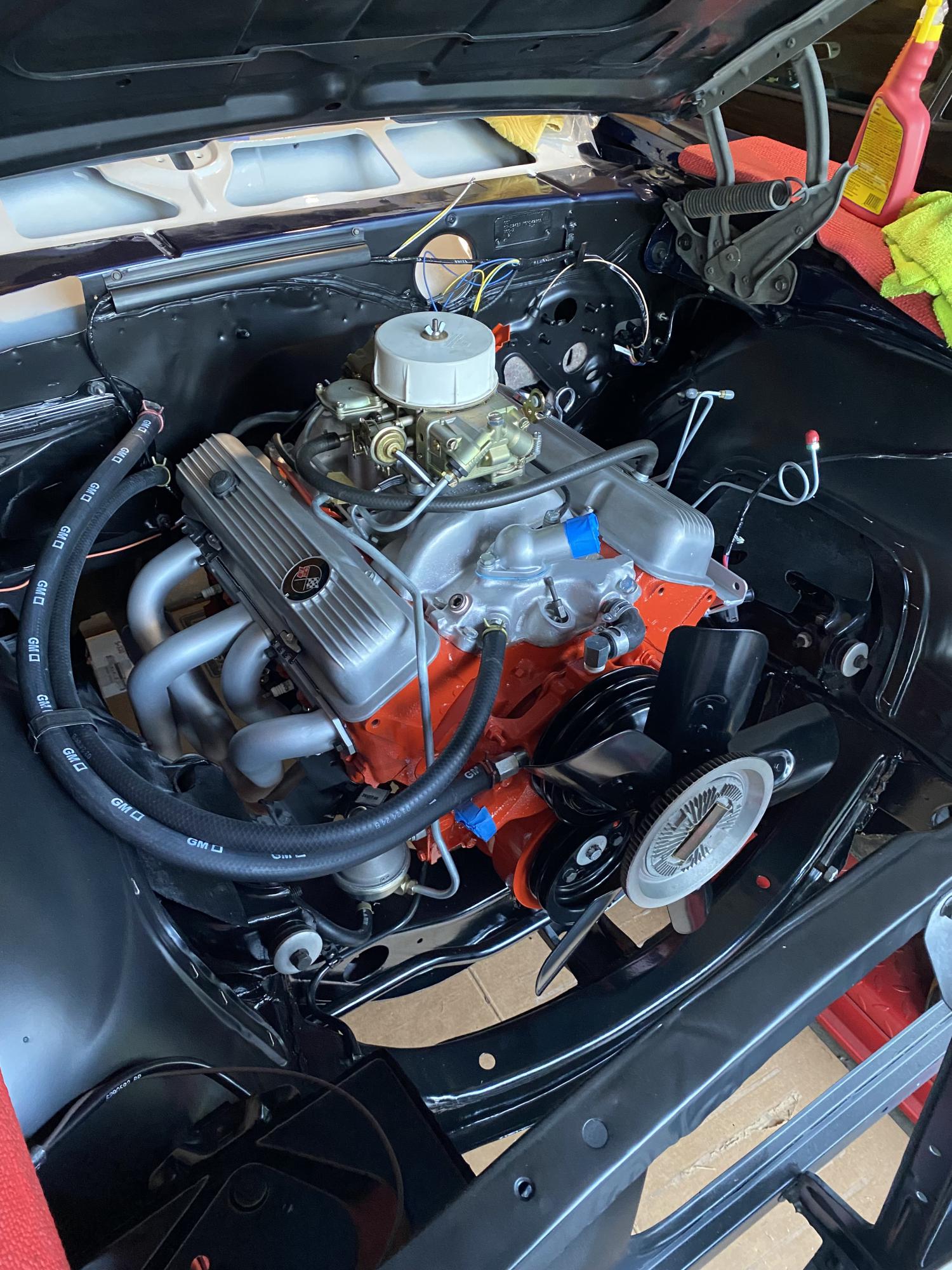

It’s coming along nicely, Tim. Just finishing up on the wiring and will then dress the engine compartment. Just got a call from my stainless/chrome guy and my plating is done….need to pick it up and (ugh) pay. I’m terrible at documenting the progress and posting pics. I’ve been taking short videos and sending to the original owner.
On a separate note, I’m thankful this project came with three tubs of NOS fasteners. I didn’t realize how hard it is to find some of these like speedometer cable clips as an example.

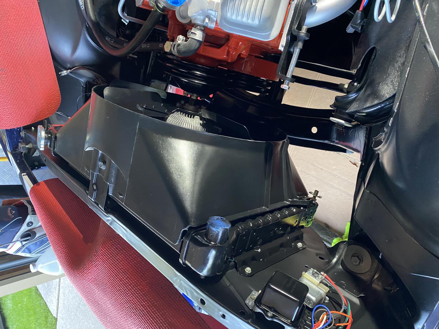

Making progress slowly but overall pleased so far:

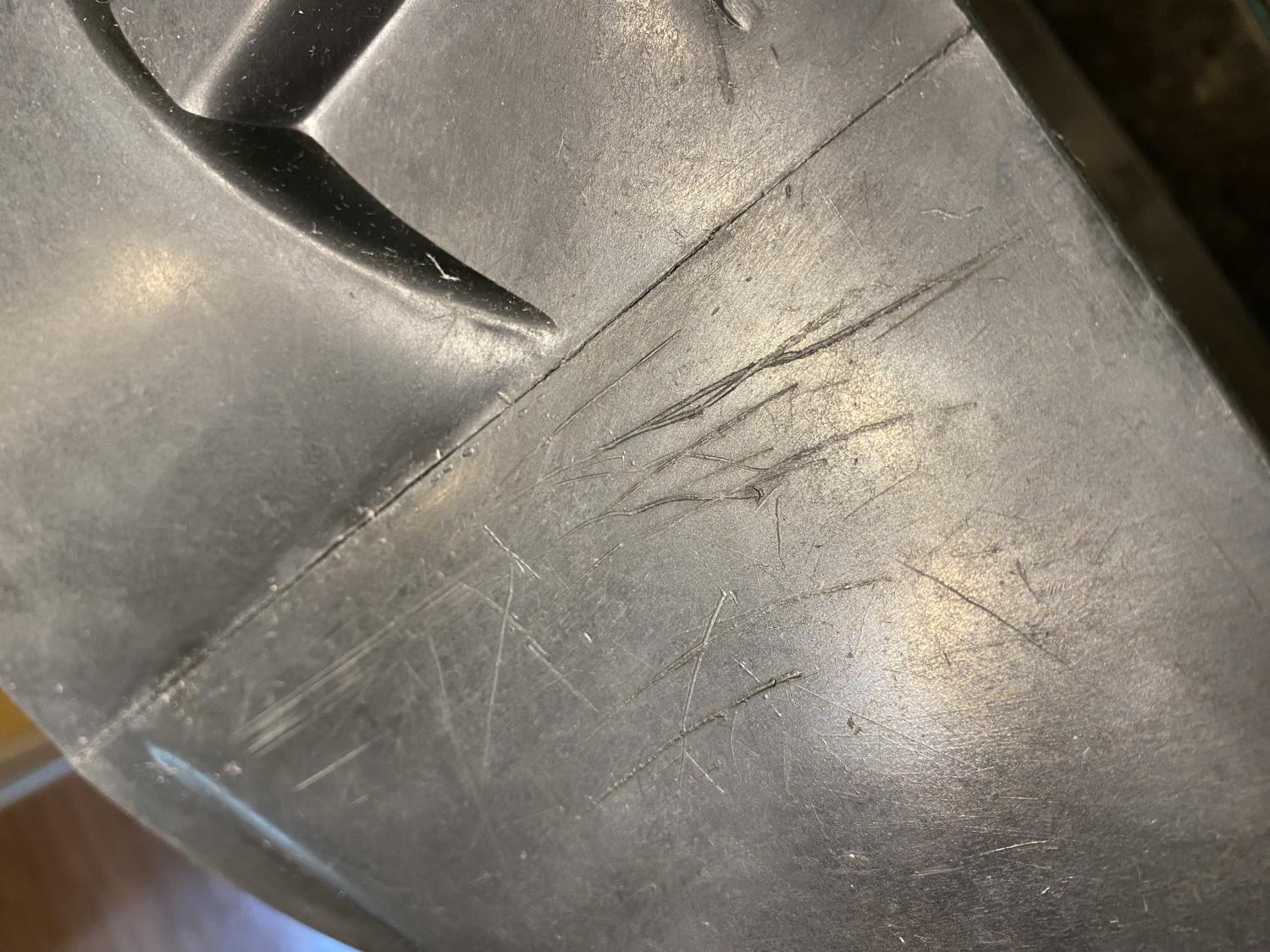

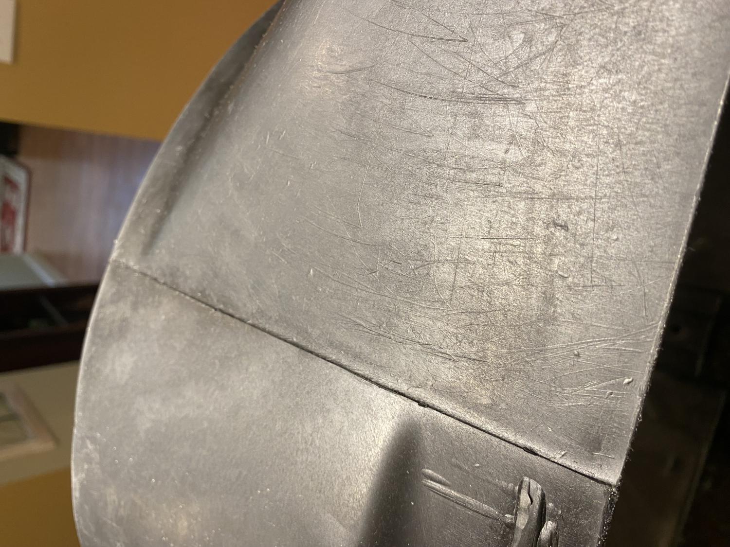

Looking for some ideas on my fan shroud. No damage other than scratches. Has anyone had any luck with reconditioning these?

I would try successive fine grades of wet dry sand paper on a block to attempt to smooth the gouges however I think you can not remove enough material to eliminate them.
another option
https://www.gmpartsdirect.com/oem-pa...shroud-3893812

I'd try that on an old part first. I don't think you'll be able to duplicate that molded finish.
Thinking the same thing. I've tried to "clean up" plastic parts in the past and it never turns out well. The gouges are part of it's history and should just be left to live on with the car. If it needs to be concourse for show, find a mint used, or NOS shroud.

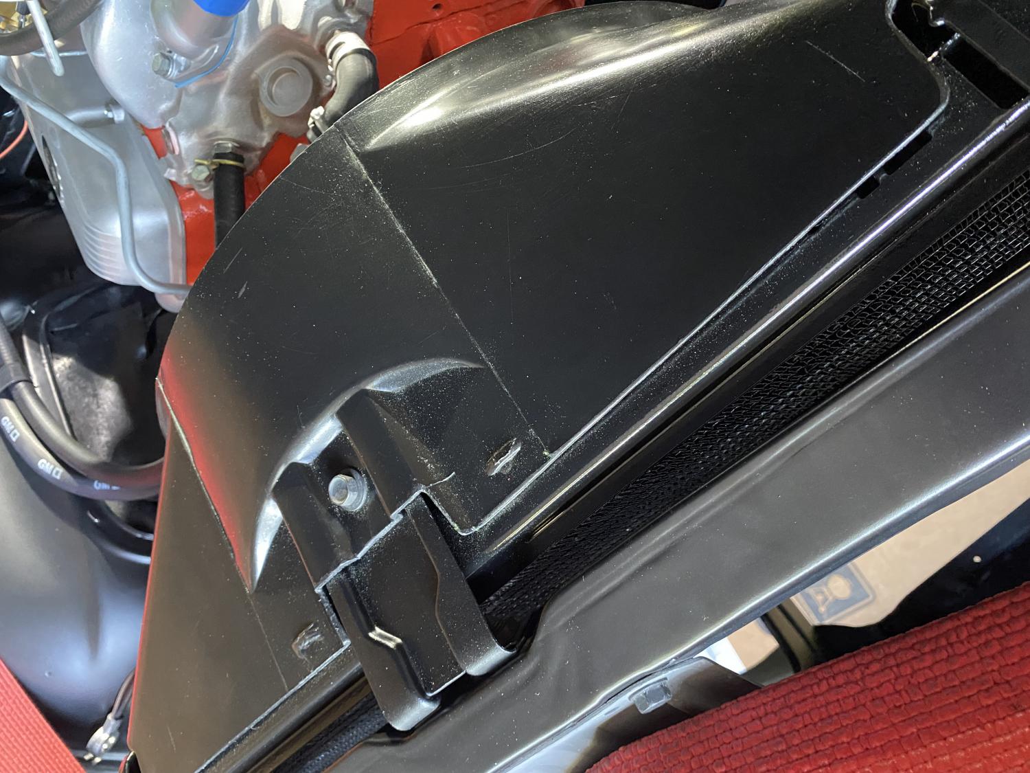

Okay, sanded many of the scratches out of the fan shroud, experimented buffing with various compounds and was not fully pleased with the results. I then thought about the black trim restore stuff for exterior trim. Tried a spot on the inside of the shroud….not bad. Here’s the results (sorry for the dust/schmutz from installing).
