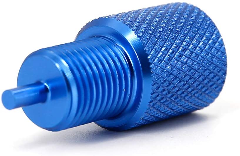

I bought this tool and I'm told it should will re-center the valve in the casting without needing to remove the casting from the frame, just remove the pressure switch (may be harder than it sounds) and screw this in its place. Once valve is centered I think you can leave it in while bleeding to make sure it does not move due to pressure differences while bleeding.
I would have thought you would need to use a small screwdriver or pick to move the valve prior to inserting this but maybe not?

I believe the piston is tapered inside.

So the tool should self center when screwed in due to the taper?

Hopefully...
I would put a mild radius on the very end, so it isn't such a sharp edge.
Yes, leave it in until done bleeding.

Yes
