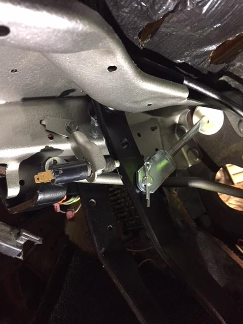

A couple questions on the a-body clutch and brake pedals. Is the clutch pedal supposed to be about 2" higher than the brake pedal? Does the rod from the booster belong in the bottom hole of the brake pedal? If it's in the top hole it looks like it will bind. I know the nova clutch pedal is up a little from the brake pedal but not this much.

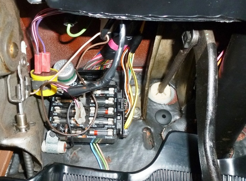

Clutch is higher sitting than brake pedal based on what the adjustment is. Here's a photo of my old T/A. Brake rod appears to be parallel to the support bracket and straight shot back, from the master cylinder. Photo from the SD455 with automatic. ( I don't know if the pedal assembly is different in an F-body. This one does not have a hole but instead has a stud where the rod's "banjo" end attaches with a retaining clip)

The automatic pedal I have from the parts car which had the power brake option used the bottom hole. I read some where last night on the web, for the manual brake cars both pedals would be equal and disk brake cars the brake and clutch pedal would be offset. I guess the manual brake cars would use the top hole because its a straight shot to the master cylinder and the power brake cars would use the bottom hole as the booster is slightly angled. I was just trying to get confirmation on this. I actually never noticed this until I read it last night.
