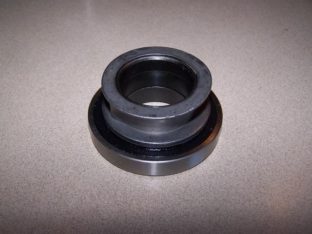

Then it was time to stick the trans in. It shouldn't really be a big deal, just put it up there and push.....right? Well I spent 2 hours trying to drive it in that last 1/2" .......no way it was going to go in. I finally decided to pull it back out and look for the problem. Well I found why.
The cheap piece of $hit throwout bearing fell apart. I can believe Summit would sell this piece of junk. My fault for not paying close attention to the bearing that cam with the clutch package. Lesson learned I guess. See pic below. The bearing had a cheap tin foil ring pressed on it, to hold it in place, instead of a steel one piece bearing.
Lesson: Don't use the cheap bearing that comes with the clutch kit!!!
This is what it looked like before it fell apart.
This is after it broke off.

Those are made by Luk. Not perfect though. It's getting tough to find a throw out bearing that does not have a plastic collar.

Steve....The clutch kit is a Ram. It's not a thousand dollar clutch, but it's a good street clutch. It was $400 for the clutch, pres plate, and &quot;throwout bearing&quot; I sent Summit pictures, and let them know how much time it cost me. We'll see what happens.

Thanks Sal, but I already have a Centerforce bearing ordered. I should have it on Monday. I have 2 Centerforce bearings on other cars, with no issues.

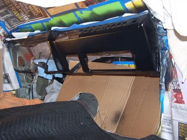

Lots to do in the mean time. It took all day today to do the fairly simple job, painting the metal parts of the dash, clove comp, ash tray, etc.
