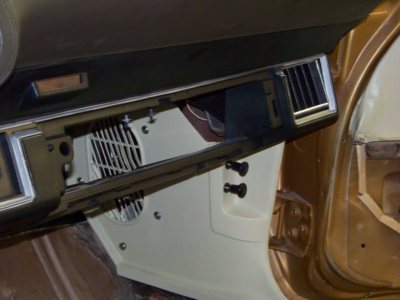

Working away, installed the kick panels, the rest of the vent assemblies and defroster ducting.
Placed a large order for carpet and under-layment, the plug wires, battery cables, rad rubber insulators, tons of misc little parts valve cover rubber elbow, etc...

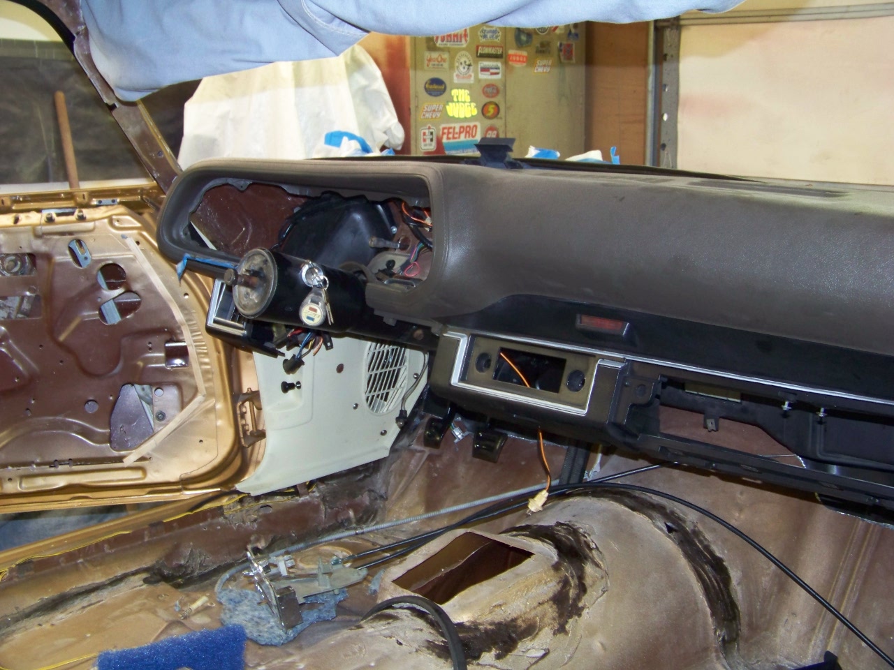

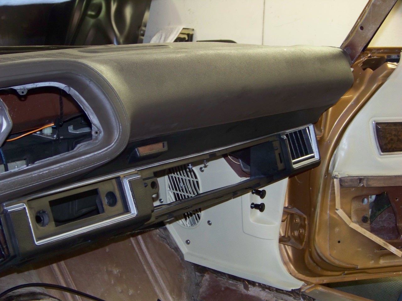

On your dashpad, is the area around the gauges black or te brown of the dashpad? I always thought that on the original pads the area around the gauges was supposed to be black.
