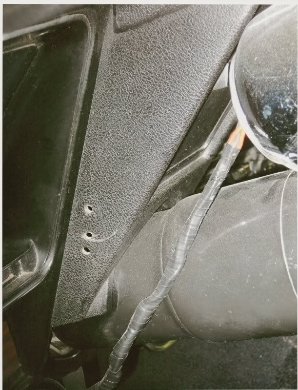

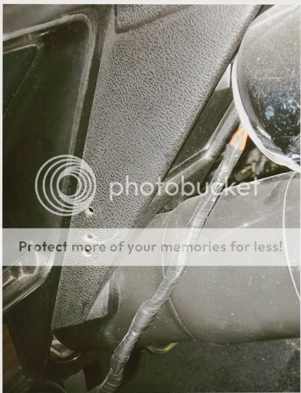

No one's questioning if the dash carrier or VIN number are indeed from a Yenko car, as that's already been confirmed by several. It's notion that the body is original to the car that has many people a bit skeptical, as at least one hidden VIN has been confirmed to be from a different car. I'm anxiously awaiting more pics of the body itself as I think it should be fairly easy to determine if it is indeed the original Rally Green Yenko body or one from another Camaro.

Hey Joe - Thanks for posting. Can you share who those several people are who have confimed the dash carrier? I wasn't aware that anyone mentioned the SW tach mounting provision. I'd like to speak to them. You can PM me if you wish. Thanks
