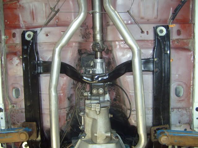

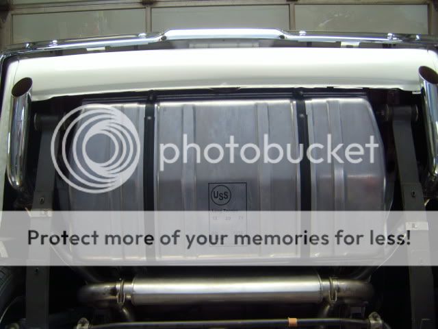

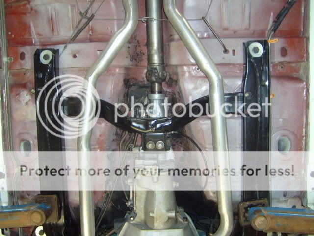

Drove her over to my buddy's garage this morning and got some underside shots, since all I have to this date are the ones taken from a creeper 6" underneath the car when it was on jack stands.

Swell underside Steve. Very nice!! [img]<<GRAEMLIN_URL>>/beers.gif[/img]

<div class="ubbcode-block"><div class="ubbcode-header">Originally Posted By: mockingbird812</div><div class="ubbcode-body">Swell underside Steve. Very nice!! [img]<<GRAEMLIN_URL>>/beers.gif[/img] </div></div>
yeah, I can hardly see any AC comp fluid [img]<<GRAEMLIN_URL>>/biggthumpup.gif[/img]
