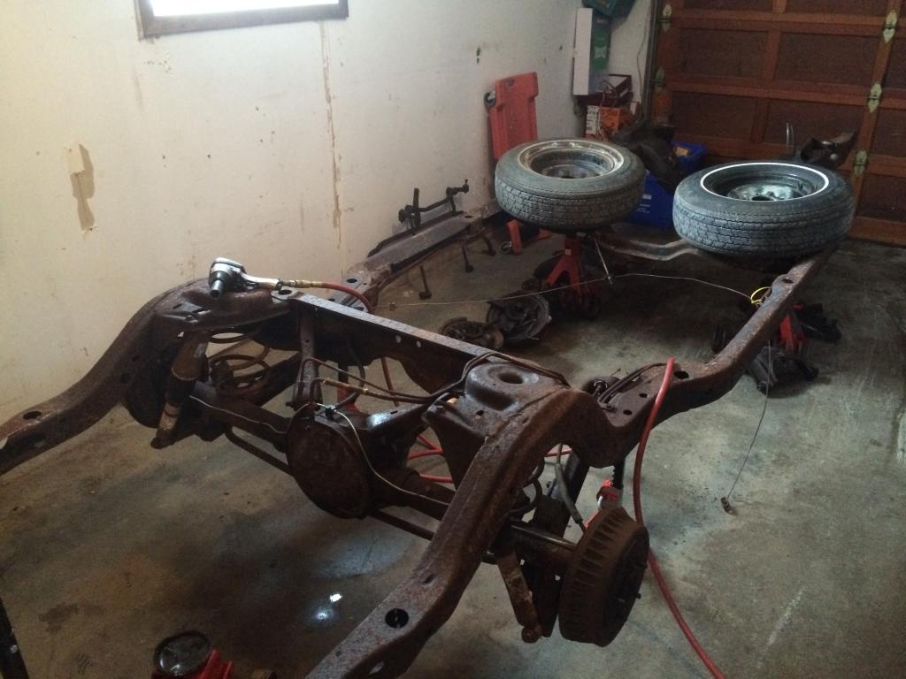

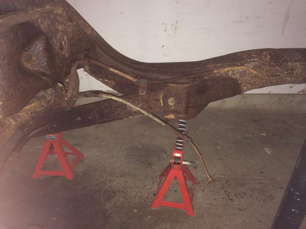

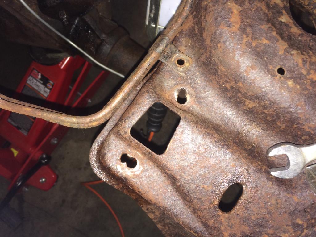

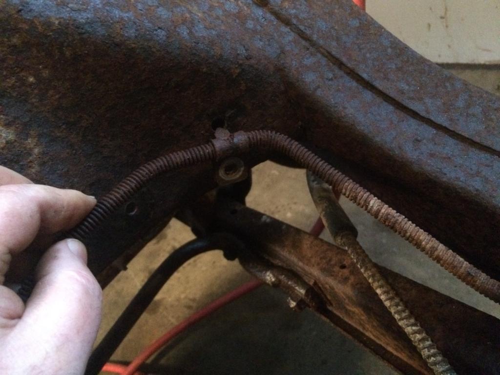

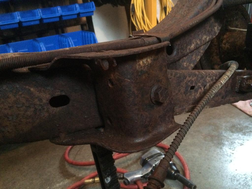

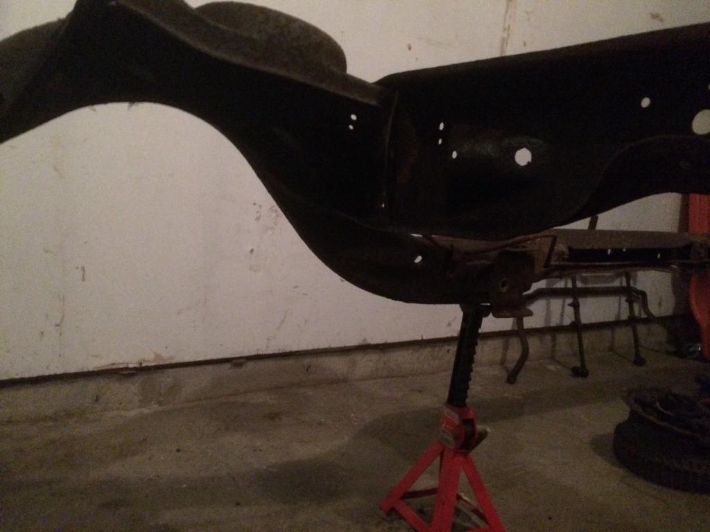

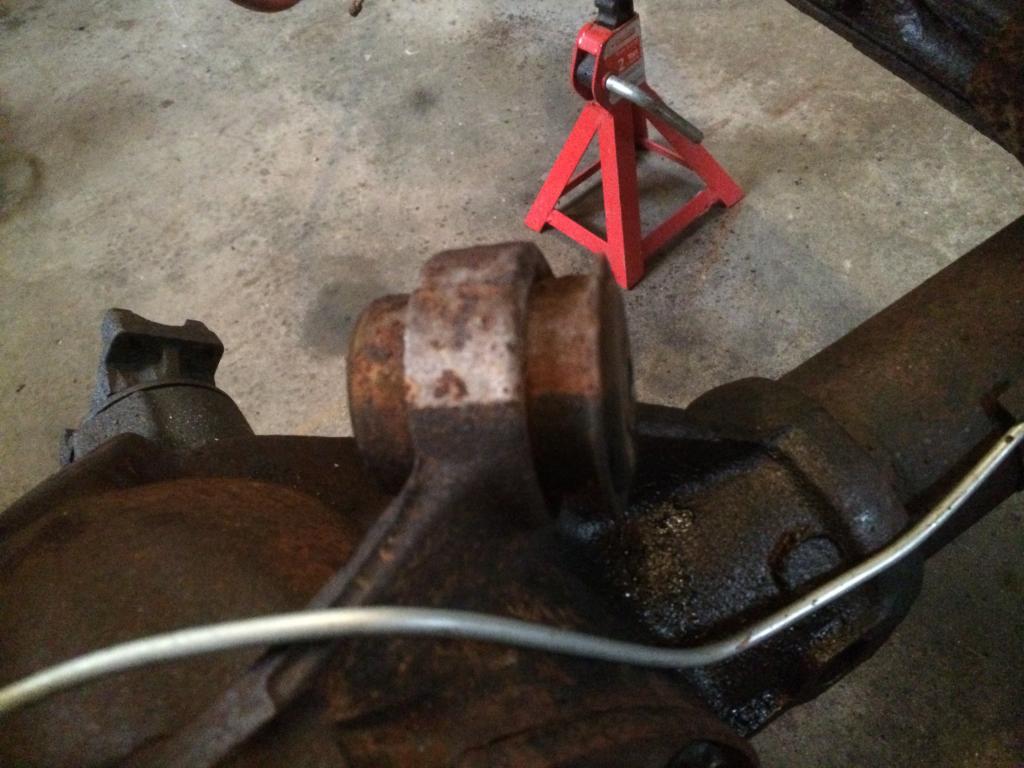

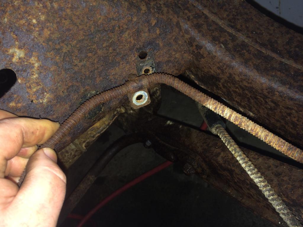

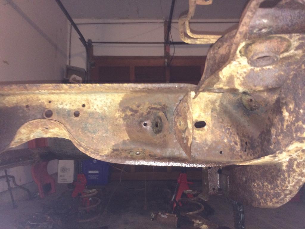

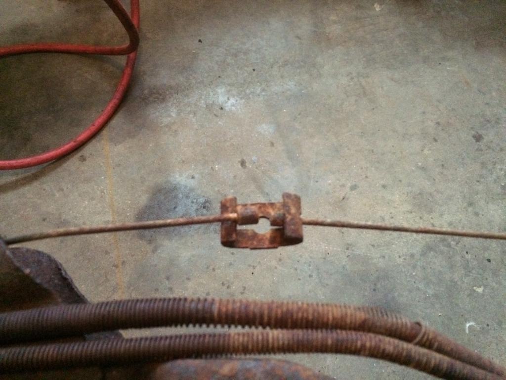

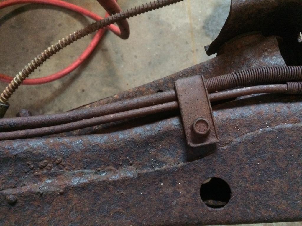

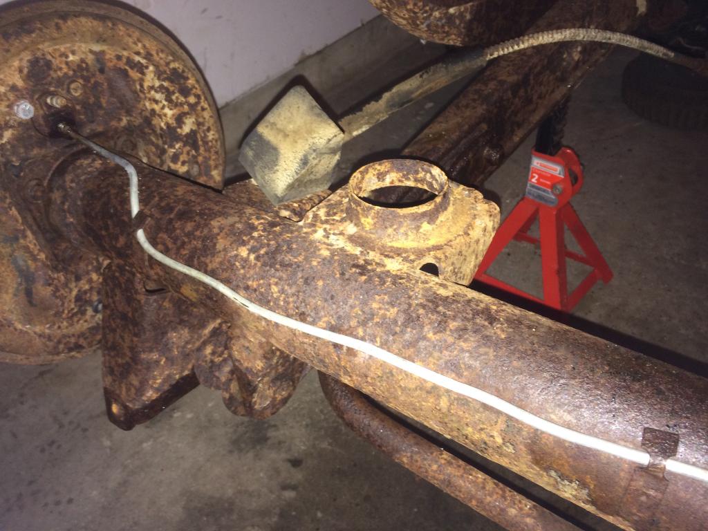

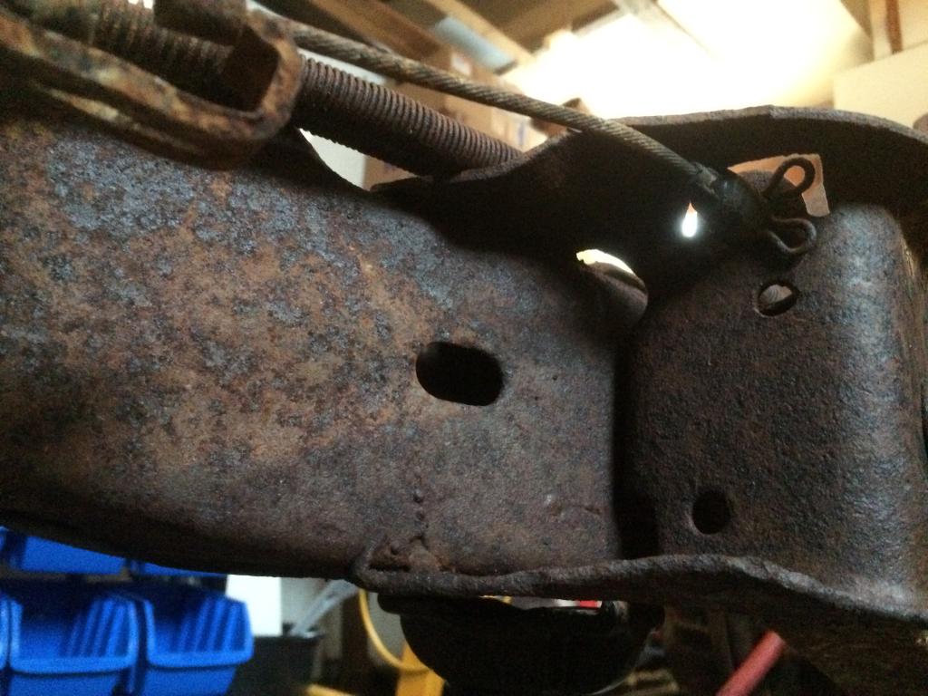

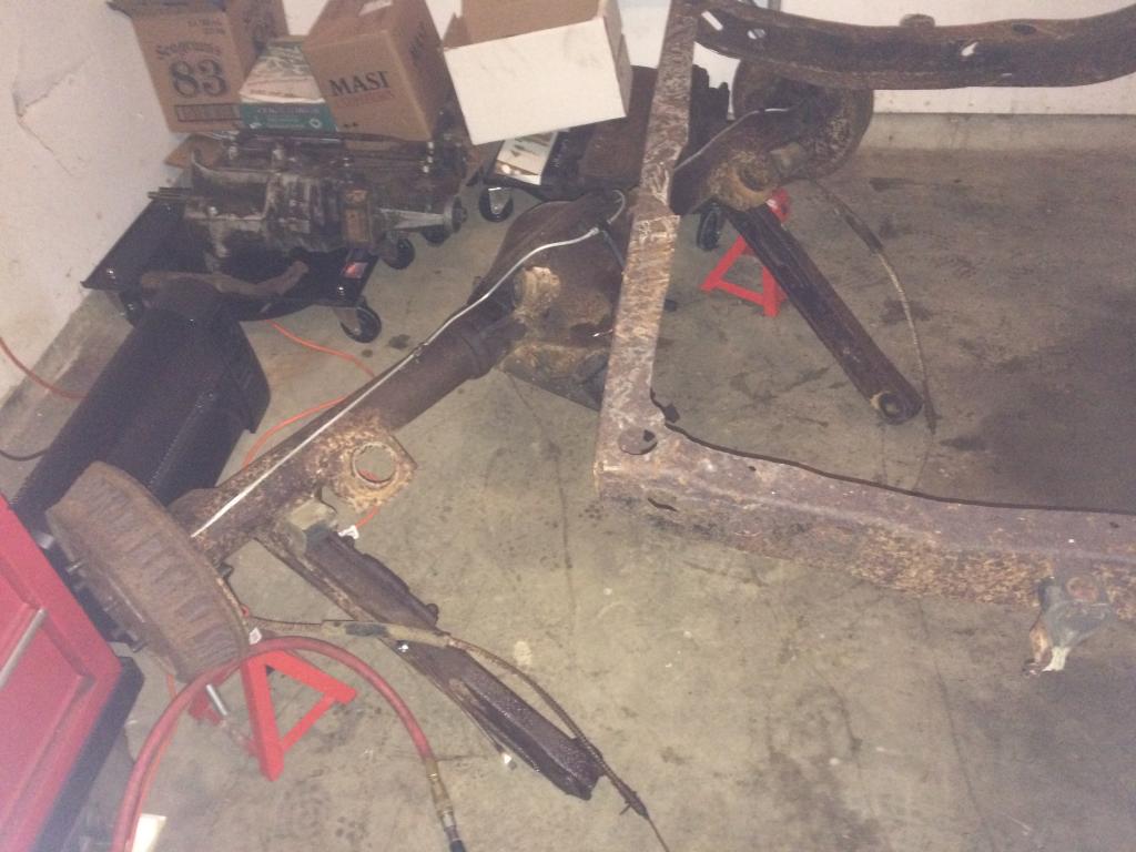

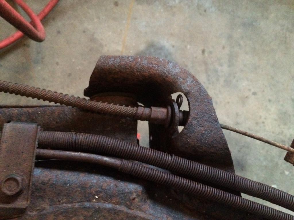

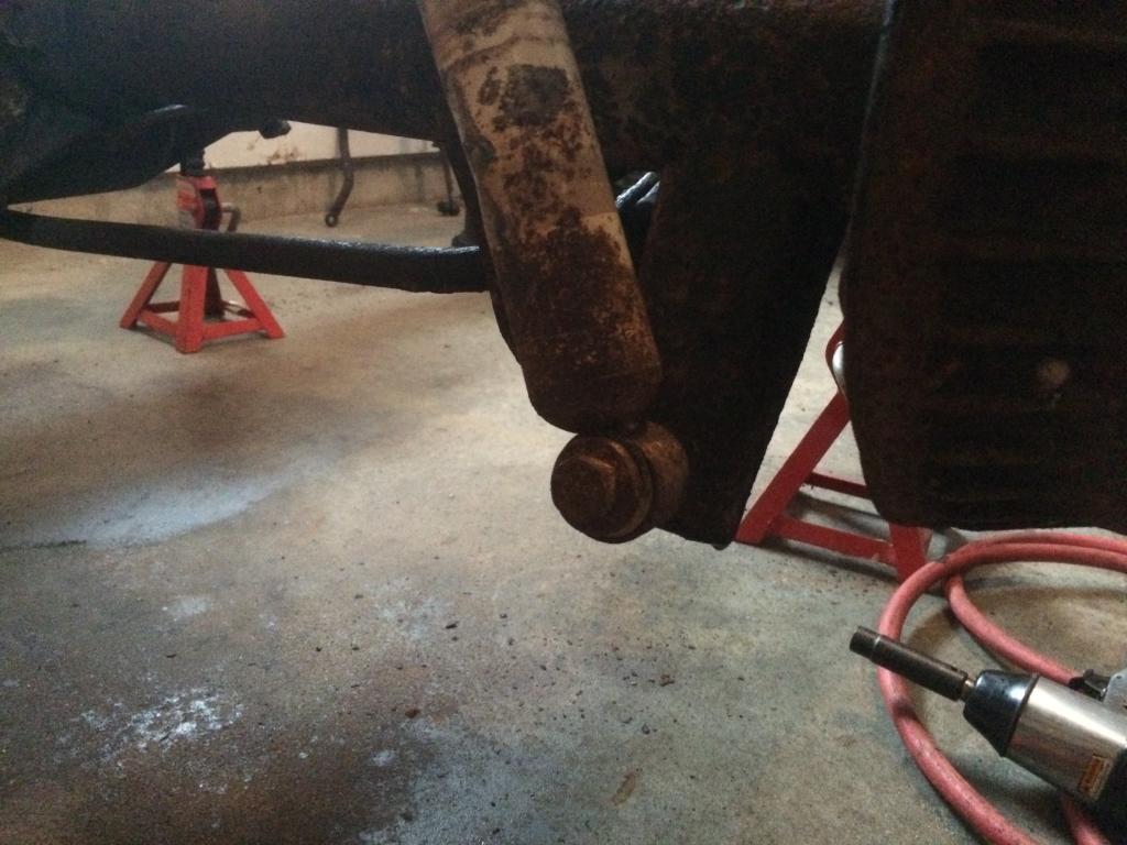

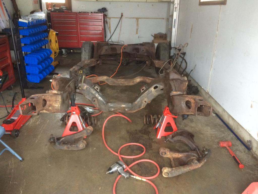

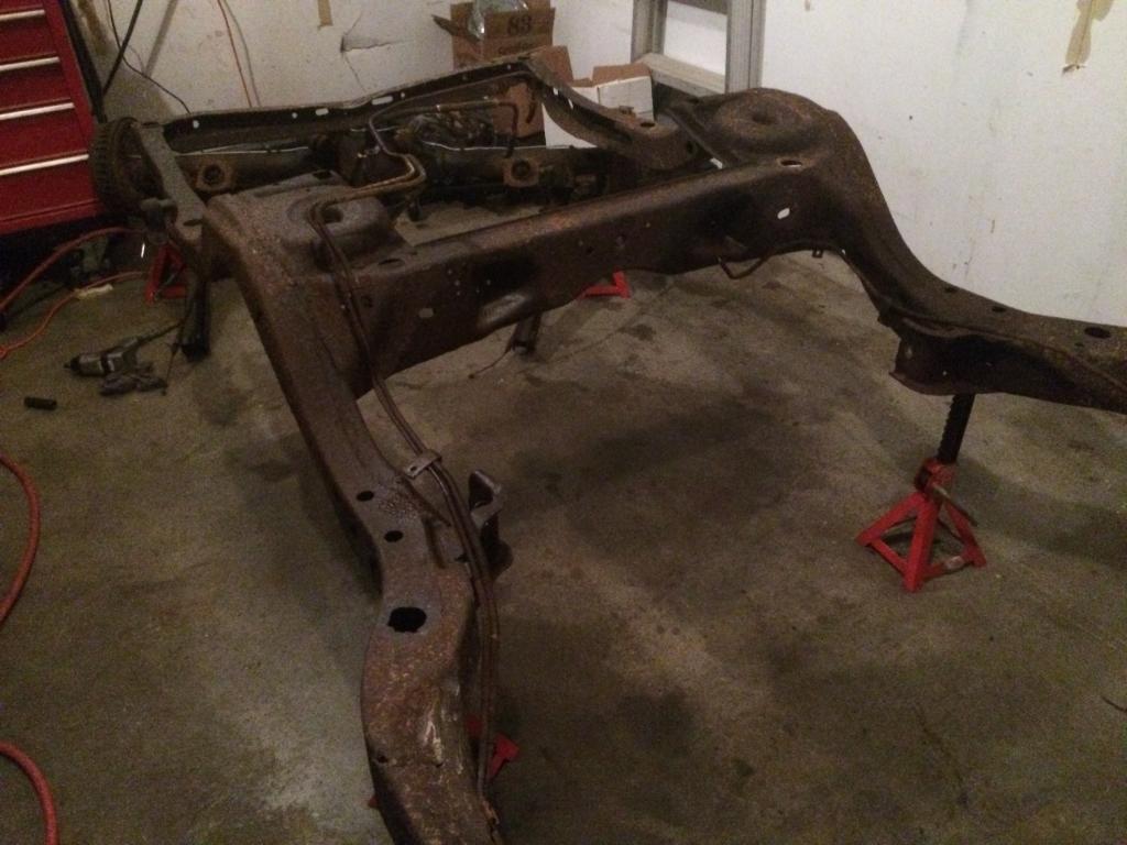

Decided to go back out this afternoon and again after dinner.
I got the rear end out of the car!!!
Ryan

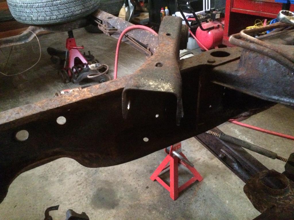

Starting point

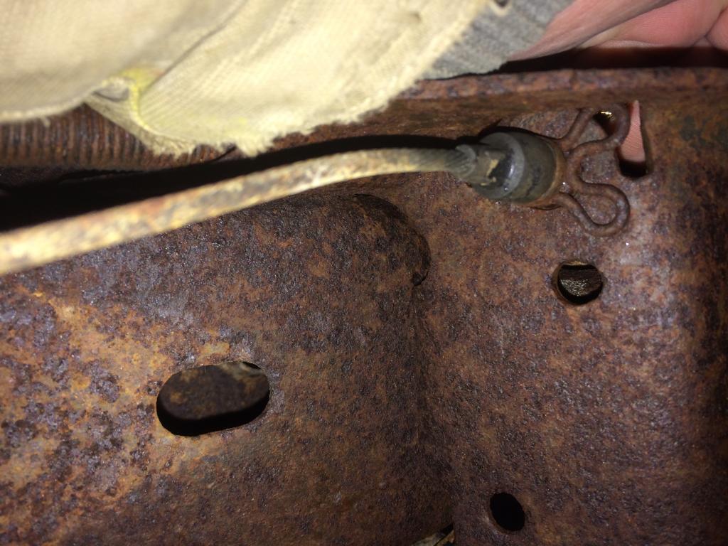

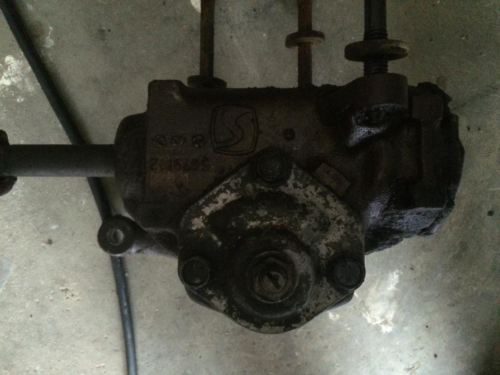

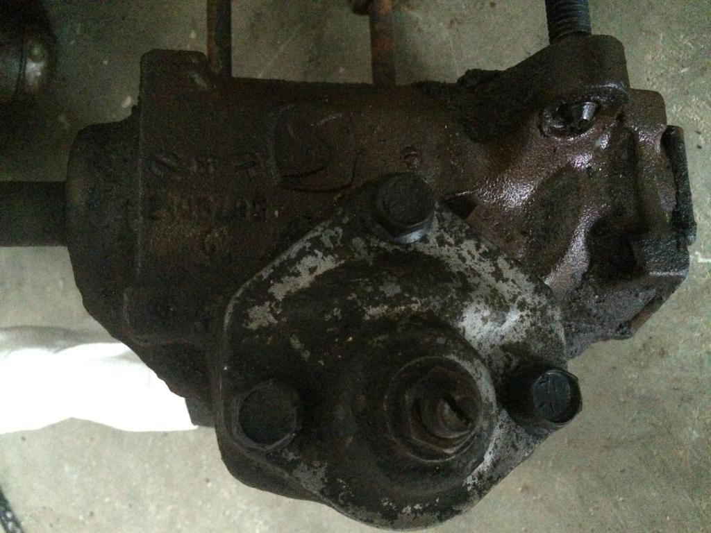

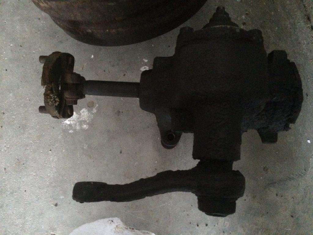

Here are some steering box pictures Bob D' (crappy cell phone)

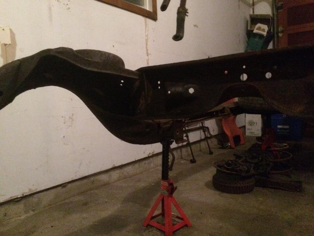

I put a couple rims on the frame up front as I could easily push the back of the frame down and do a jack stand wheelie.

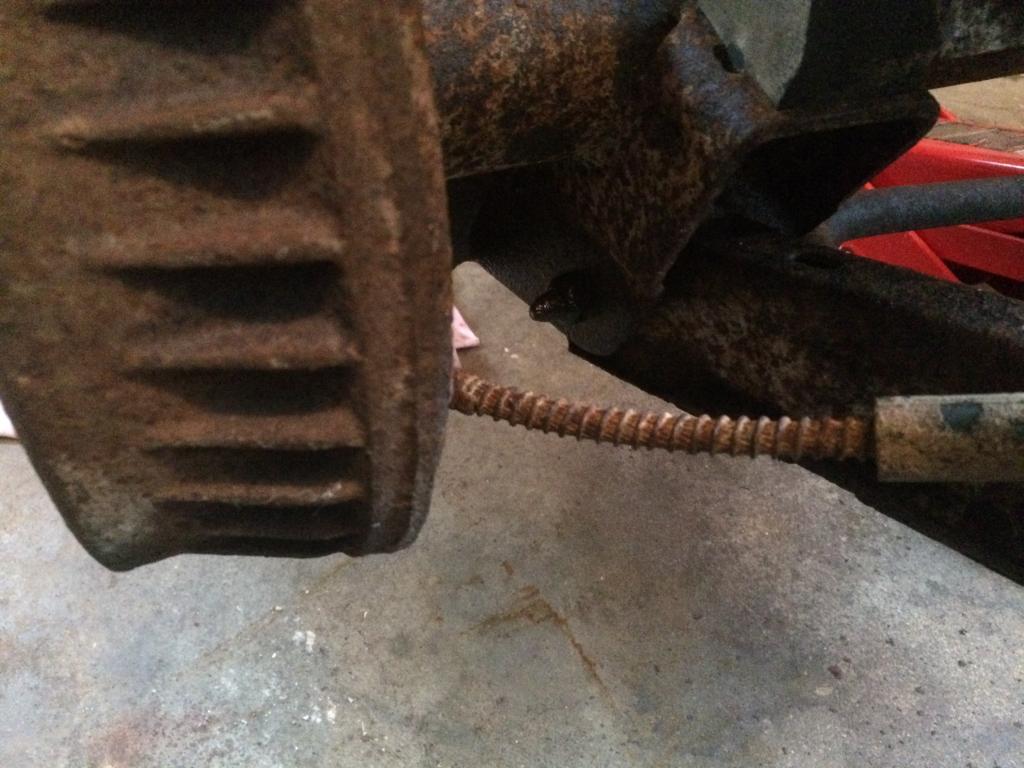

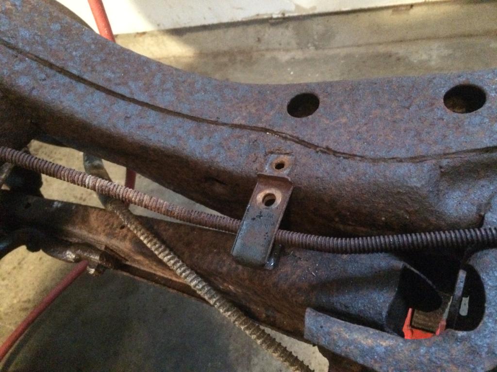

Parking brake cable disconnected.

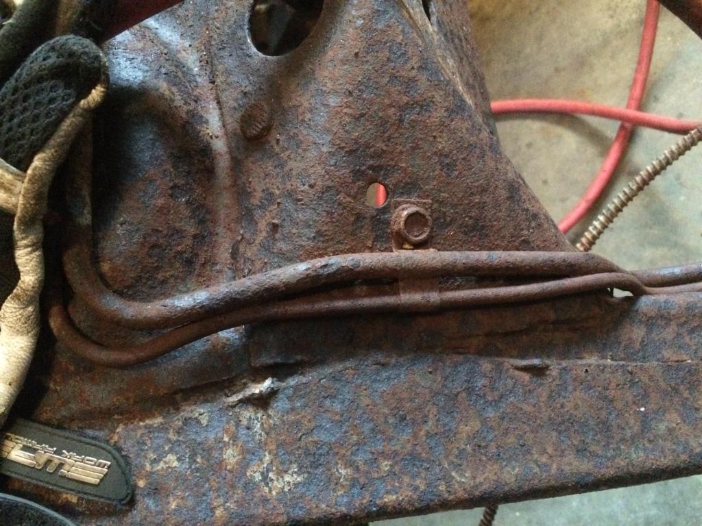

Fuel line clips

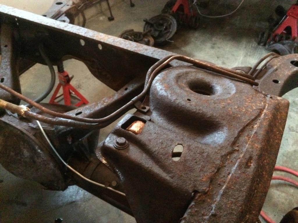

Shock bolts
Lower control arm bolts

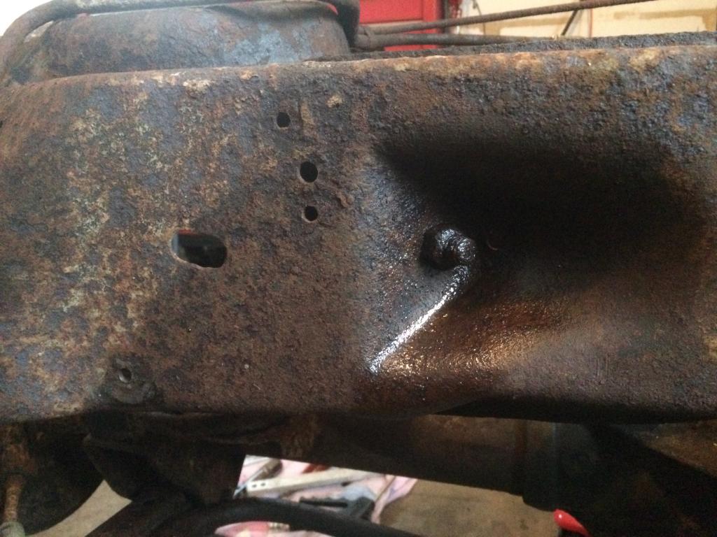

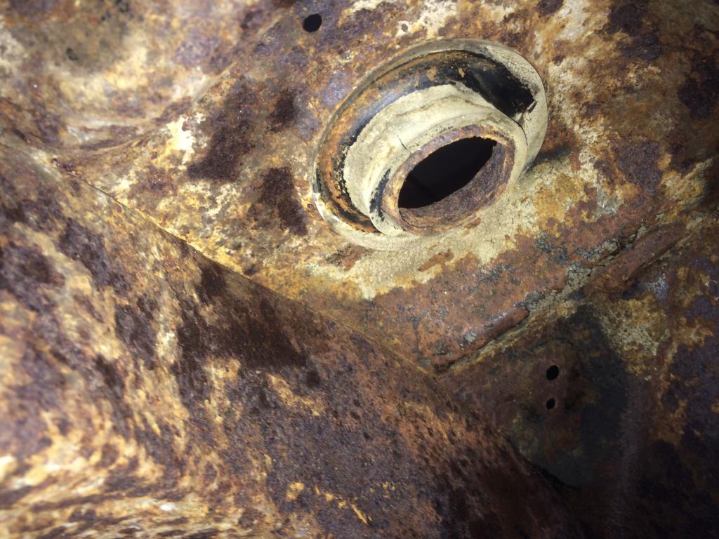

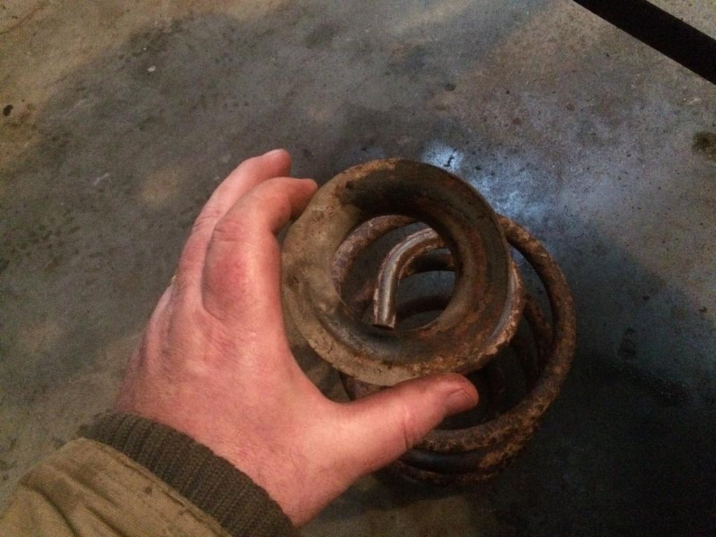

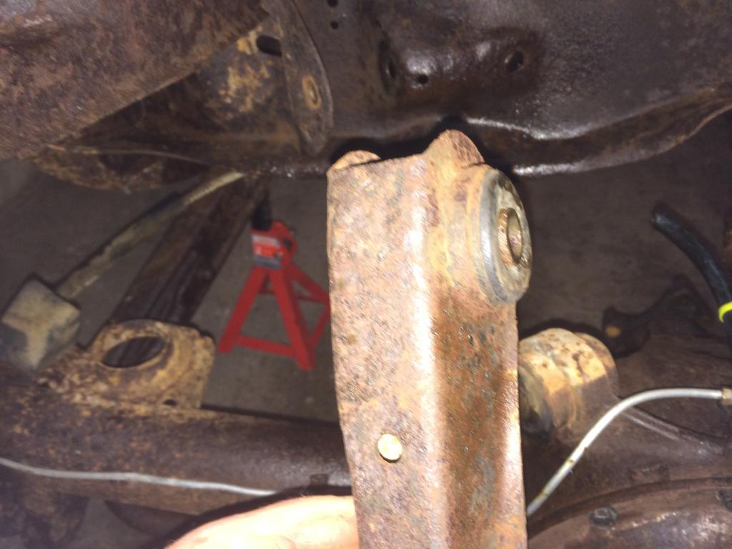

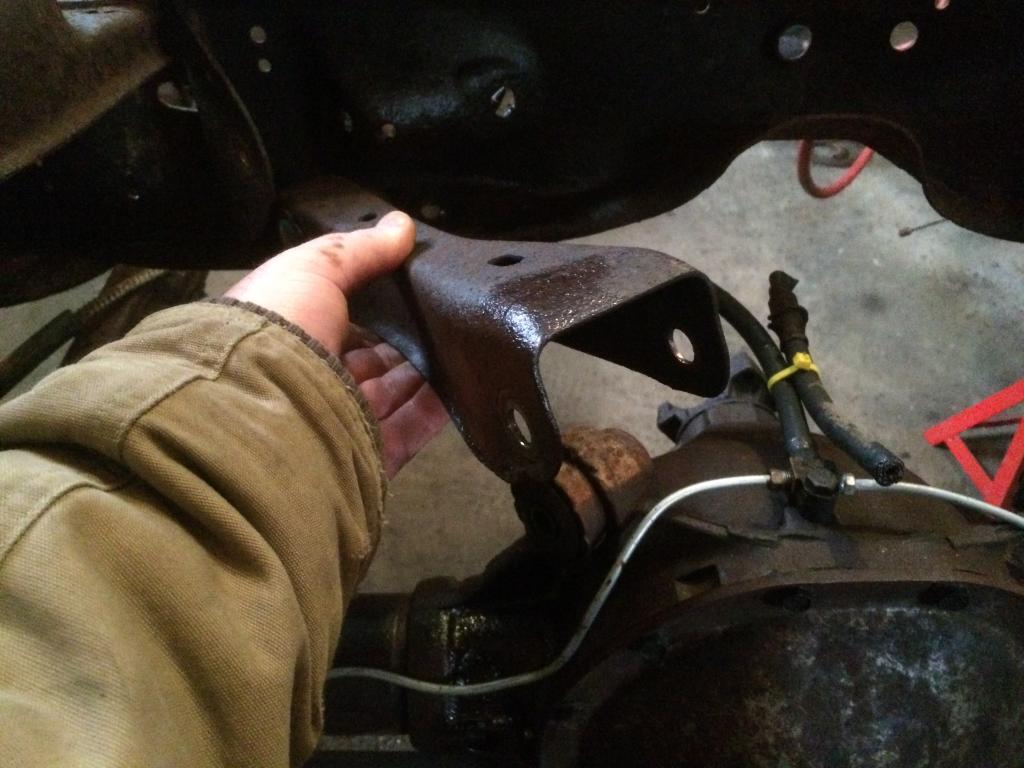

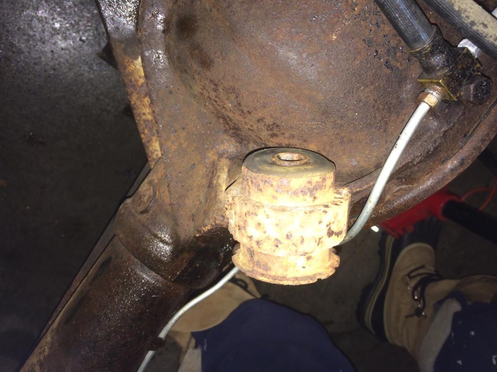

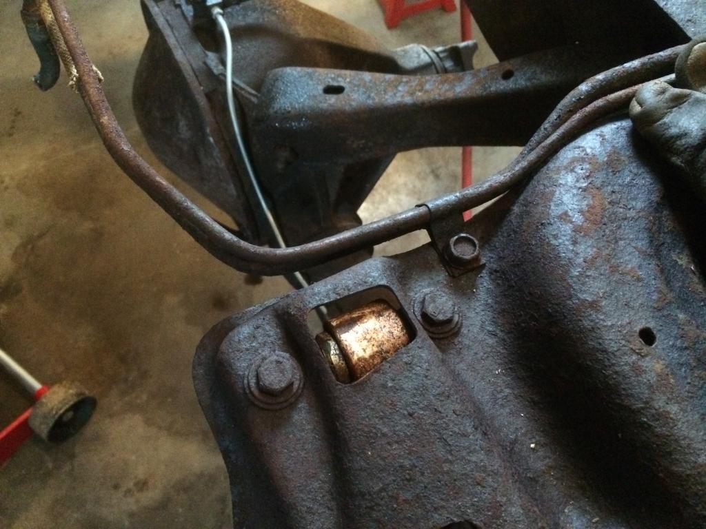

Upper control arm bolts

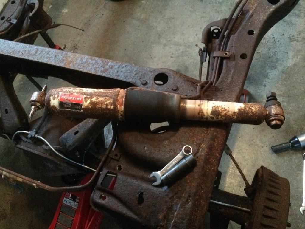

Shocks out, passenger side has slightly modified holes? (probably to get the air shocks in)

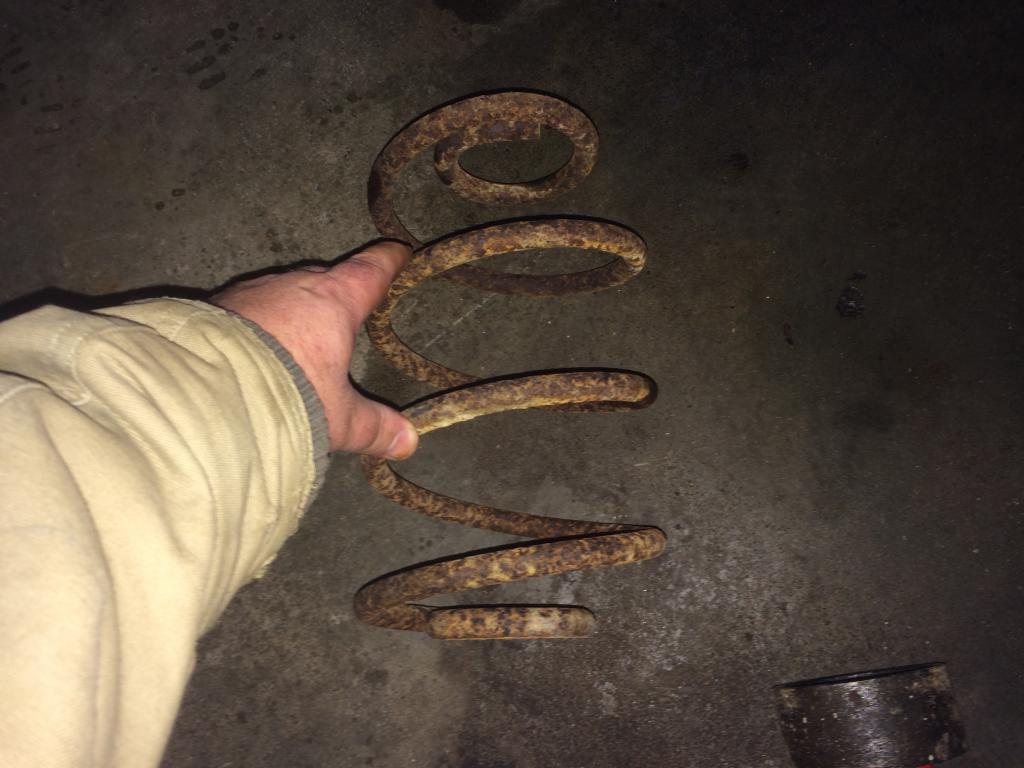

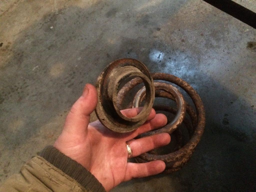

Springs out, nice isolators up top:-)

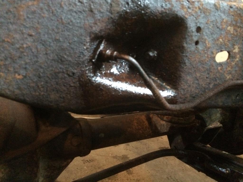

Brake line disconnected

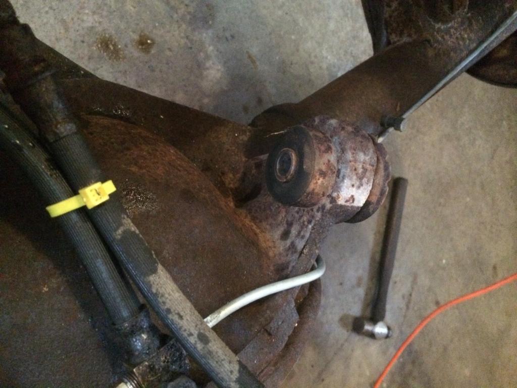

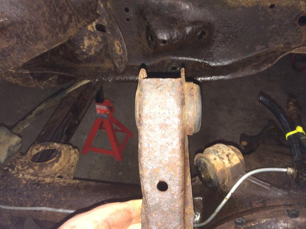

Upper control arms out

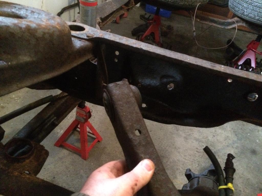

Lower control arms disconnected, one bolt just would not come out, I could get it half way, eventually cut the head off and pounded it out the other way, problem solved:-)
