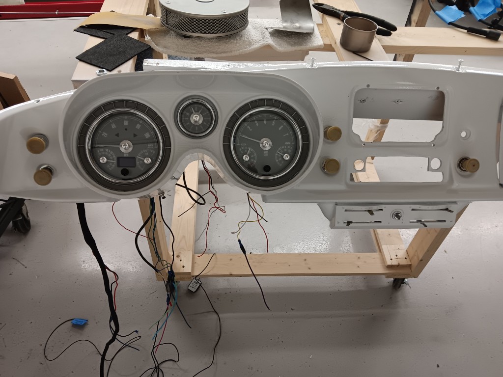

OOO....that last photo makes my head hurt. Here's a more clearer one.
Dash being pre-wired. I'm attaching all the heater lines before installing so there's less contusion and convulsing under the dash for me. After some hard work, it was off to HEB (our Texas grocery store) where I stumbled across my ultimate favorite beer: Shock Top Twisted Pretzel. This beer has the aftertaste of my beloved Snyder's of Hanover sour dough pretzels. I have three cases in the shop and another five at the house. Last time they came out with this is was seven years later until they made it again. Go try it...you'll love it!!!!!!
