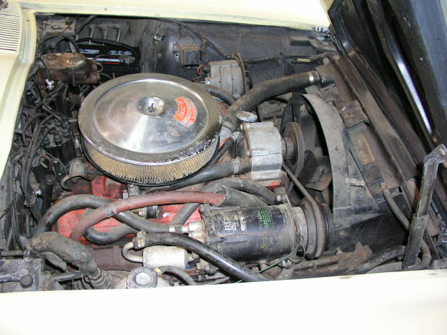

Today I rebuilt the carb, changed the plugs, scraped the glaze off the inside of the distributor cap and changed the oil in the yellow 67. It starts and runs great. Needed 2 quarts of auto trans fluid. Still has the orig dated plug wires on it and what looks like the orig GM smog pump belt. It still has the canister type oil filter and there happened to be a new Kmart filter in the silver car. Still have to stop by using the parking brake but.......

keep 'em coming, does the a/c blow cold?

Ha...I actually tried it but the compressor would not kick in. Evacuating and recharging is last on my list....way last.....

those Vettes were notorious for freezing the pistons in the cylinders on the dual piston disc brake calipers as I am sure you are well aware. New stainless steel sleeved calipers and you should be good to go.
