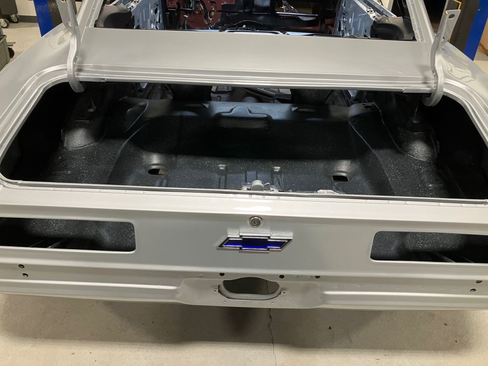

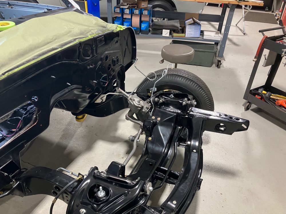

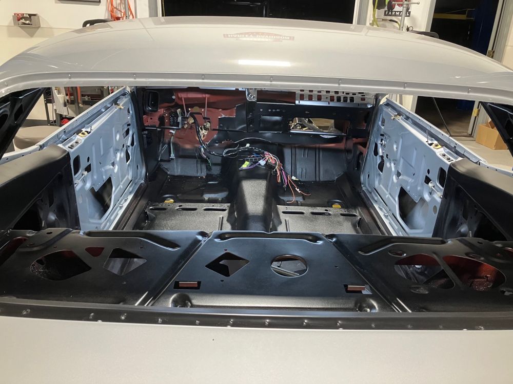

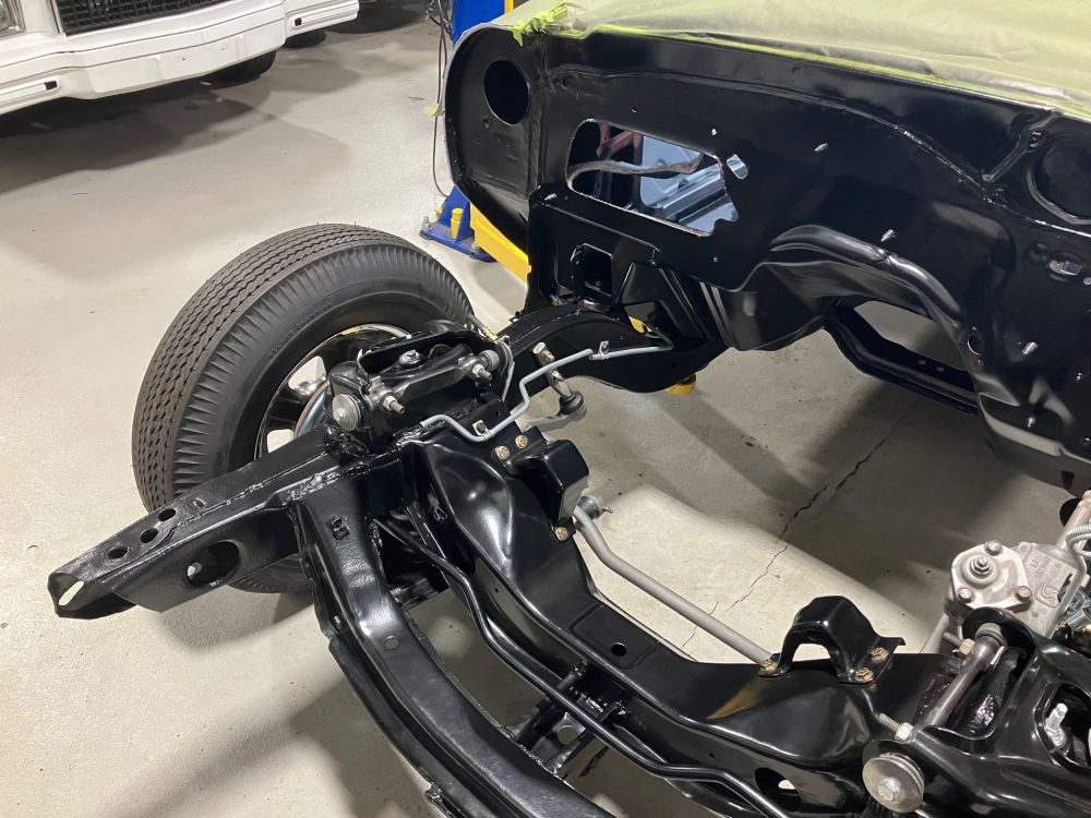

Finally getting around to putting some parts on this car. Fuel lines, brake lines and subframe connectors are also in.

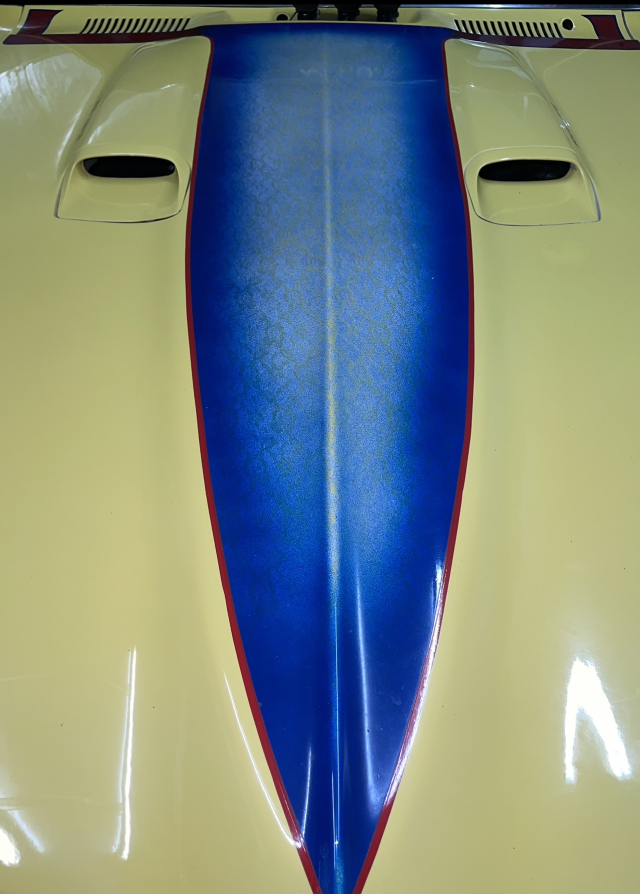

Love this car and project but seriously think it’s needs an amazing lace or candy paint job And that silver is a spectacular base for just such paint
Obviously do as you wish it’s your car but feel it would throw it right up over the top!
Either way I love the car and what you’re doing with it I like the clean look too but just think it’s begging for this kind of paint.

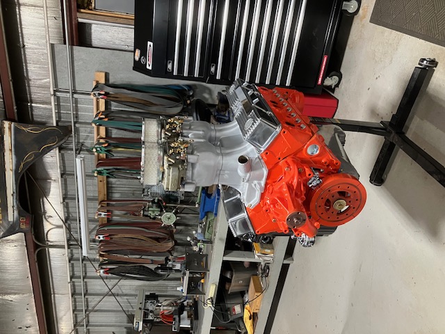

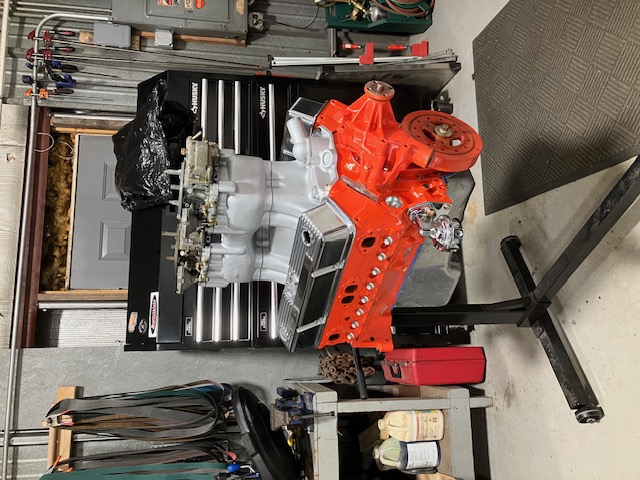

Default Motor update

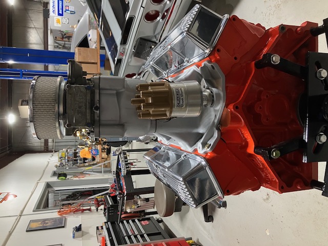

Back from the machine shop
MO 302 motor
186 heads machined for 2.02 valve and screw in studs, comp cams roller rockers
Eagle crank, pink rods, 11 compression
30/30 camshaft
Edelbrock tunnel ram 600 cfm carbs
Cragar Super Spark dist.

Looking cool Dan. Is it just me...or is that a really tall looking tunnel ram?
That distributor is perfect too.

Agree it looks tall It is just and Edelbrock TR1X

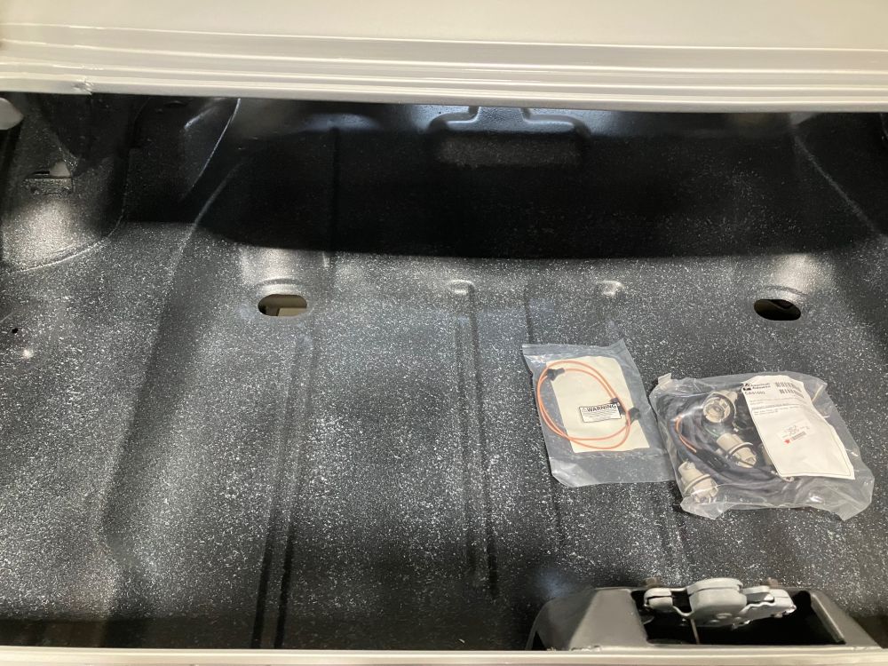

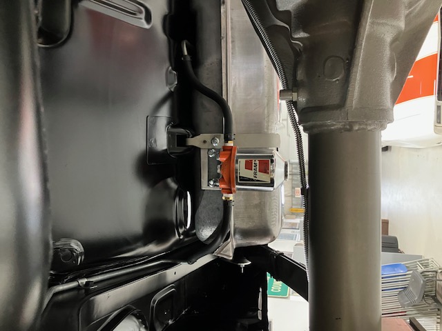

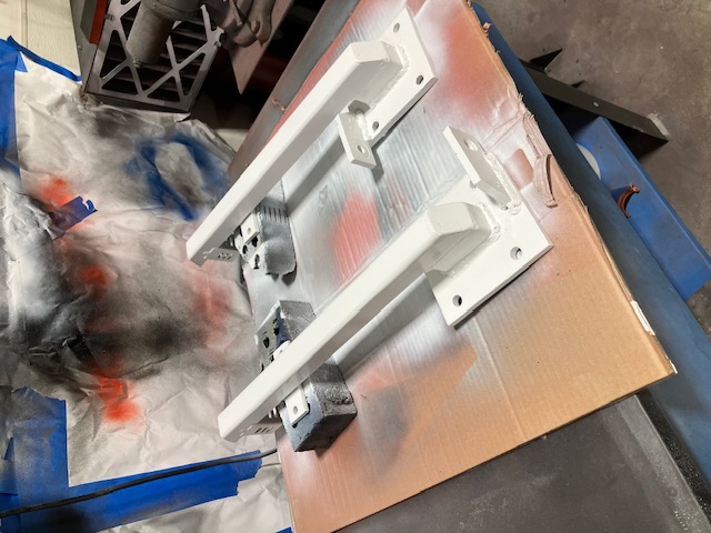

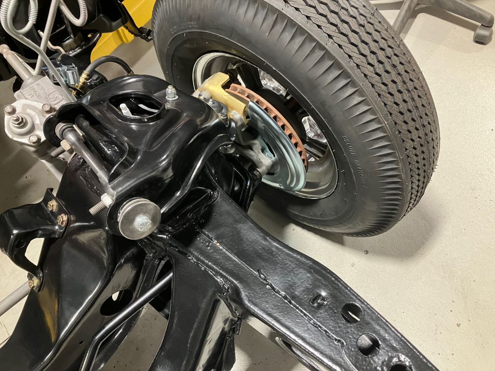

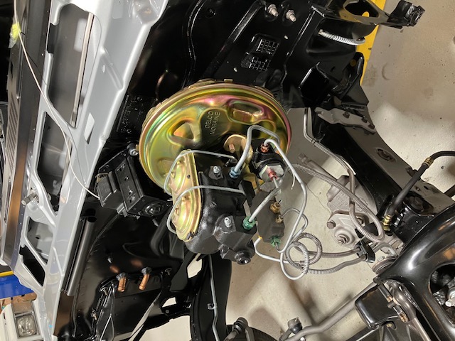

Finally got to do some odds and ends. The fuel filter is mounted, the brake lines and parts are completed, the booster is just a place holder with the original one is being rebuild and plated. Decided to use my Drag dimensions traction bars, just freshing up the paint on them before I put the new decals on.
