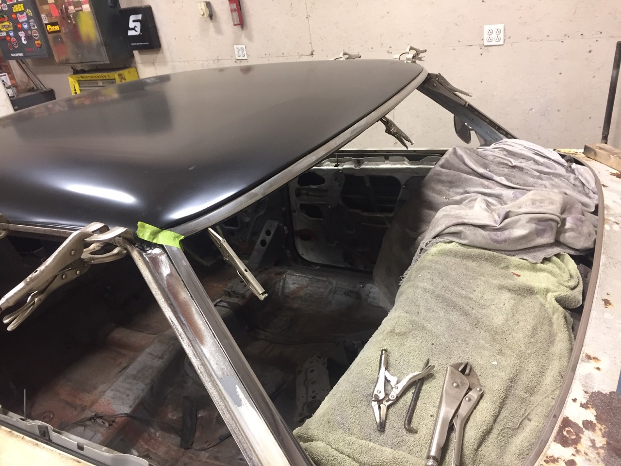

I have Jeff's Big block Monte Carlo in the shop for a make over. Overall the car is in very good shape but the New Jersey winters did a number on some of the usual spots. The car will get new wheel wells, quarters, rear window filler panel and most likely a roof skin. The car was a vinyl top car and was removed on the last repaint. The way they filled the holes with brazing and then dimpling the fill holes was the way they did it back them. The skin will need a lot of blocking to get it flat again. To save on labor its way easier just to replace the skin. I just received the sheet metal last night this is where the car is as of today.
