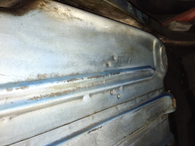

A trip to MCACN yesterday "super-charged" my motivation to keep going on my project so I went back at it today. I posted a few questions over in the preservation forum so I don't clog this thread up. Here's a couple of shots of where I'm at with the teardown as well as the underside of the cowl panel showing the original Lemans Blue overspray. The original foam dividers are still in place and you can see where a few exterior gauges were once mounted - holes were welded shut by the guy who painted the car in 1978/79. I'm not sure what gauges were mounted there, but am assuming a fuel pressure gauge - what else would have been typical back in the day? I think the tach was mounted on top of the dash. Also posted a shot of the cowl VIN stamping - not sure if I posted it before or not.

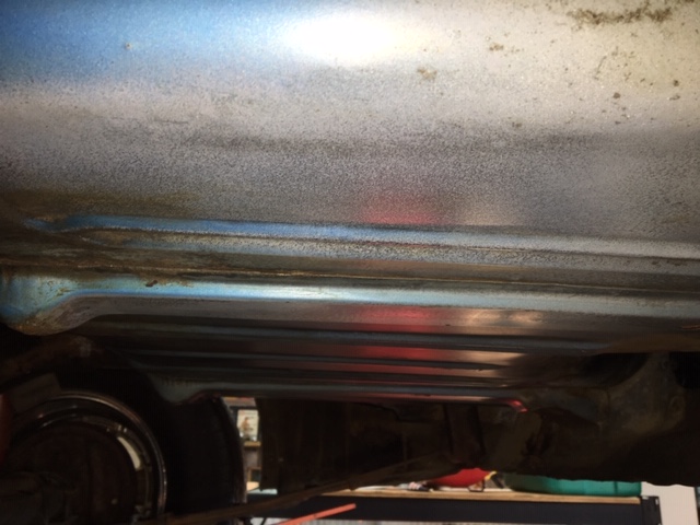

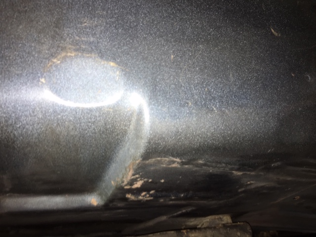

Default Looking for some feedback from the community....

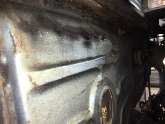

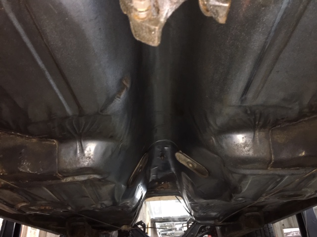

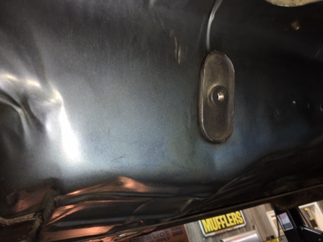

Did some more teardown and made a quick attempt at cleaning some of the frame and undercarriage areas. In general, the vertical surfaces have a good amount of original paint, but the horizontal surfaces have most of the paint gone. Here are a few pictures....

Also found a couple of "week" stamps on the firewall and cowl - both stamped "38" which are the same week as one of my rear quarters. The top sides of the suspension where the gloss black was not sprayed, seem to have most all their original finishes intact. Any thoughts, tips, or suggestions on direction are welcome!

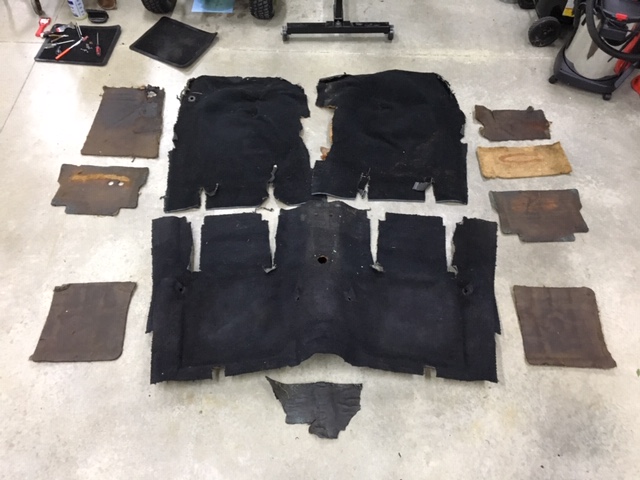

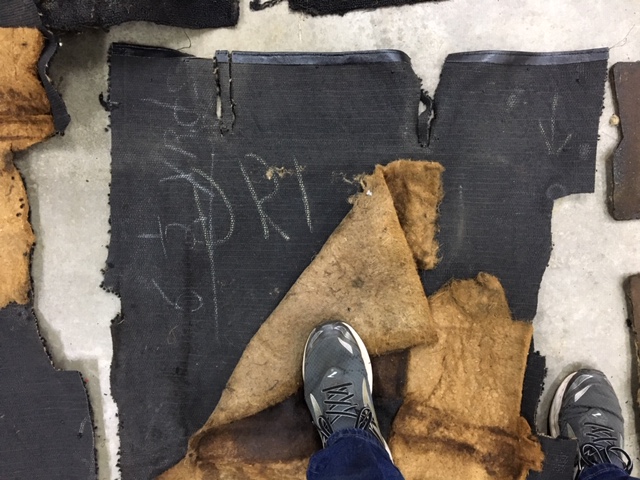

Took the interior out today...found some more interesting stuff, at least to me. PO stated original carpet yet so I was able to check it out more closely with it out of the car. It looks to me like the front is original, but the back was replaced. Tag on the back has what looks like a date code of 8 8 79, which times out about right for when the car was done in its black/gold scheme. The backing looks different from the front as well. Found some chalk writing on the front carpet....anyone see that type of thing before? PO hacked up the front carpet pretty bad when he put the auto in so it won't be saved.
