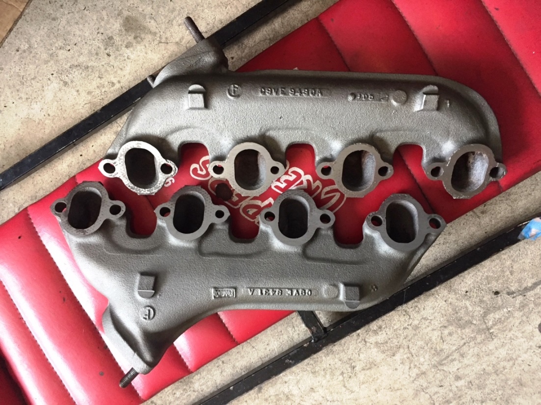

Picked up the major stuff today today. I dropped off the exhaust manifolds to get surfaced. Years of blown out exhaust manifold gaskets pitted the mating surface on the manifolds. As you may have guessed it, the dealership would just charge my father for replacing the donuts in the exhaust pipe to manifold flange and call it a day, completely ignoring the actual cause of the exhaust leaks...and the noise.

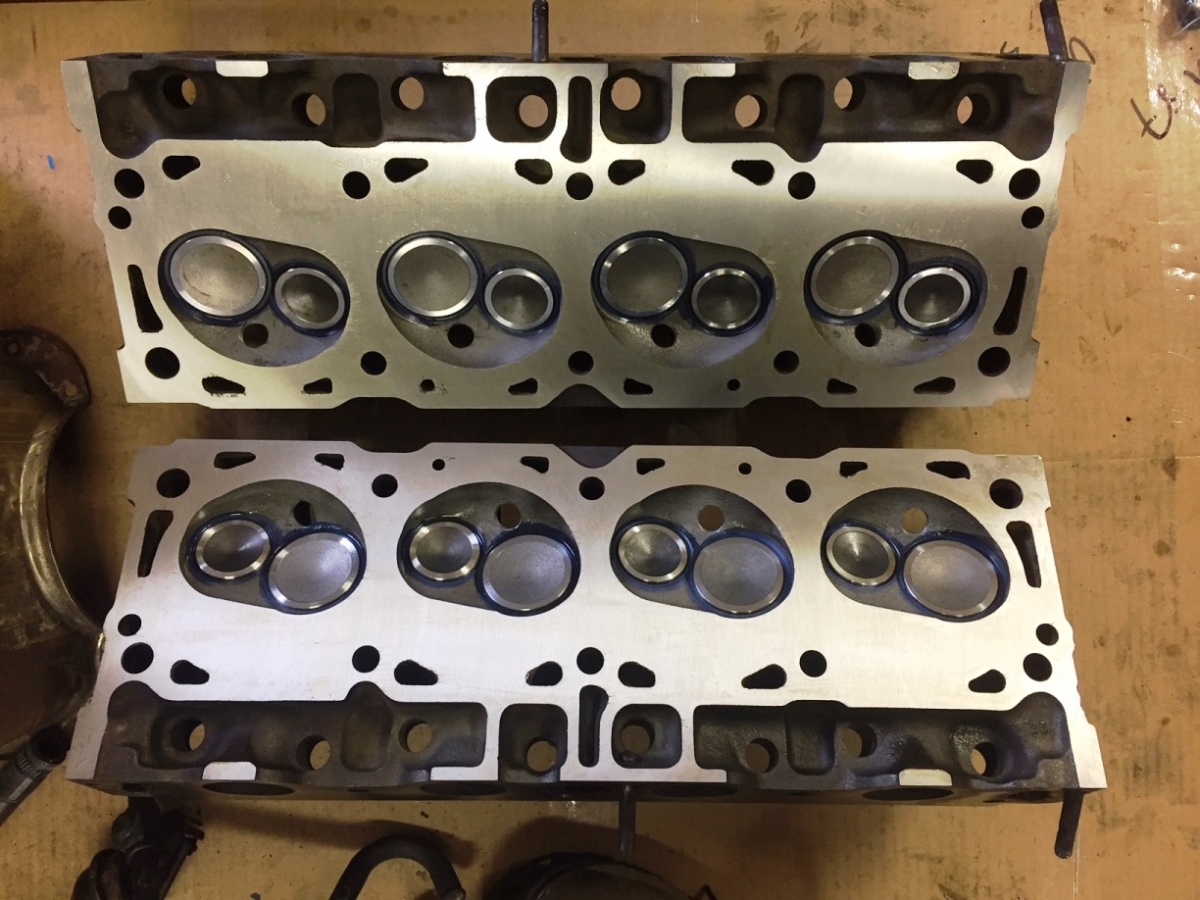

Don't you just love the look of freshly machined parts?

They smell good, too! I had to oil them all down quickly as it was raining when I got home with the parts today.

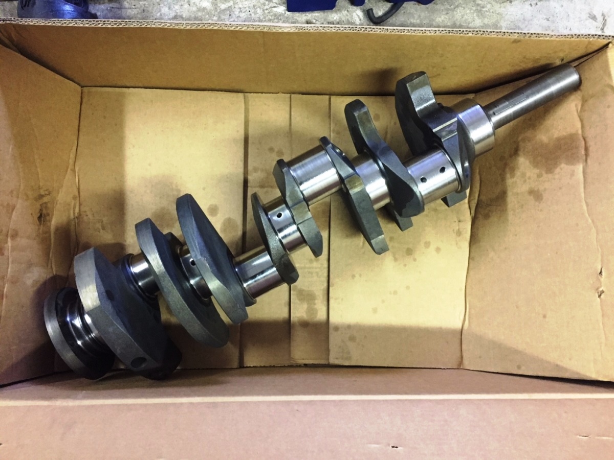

Got these back from Rogers Speed Shop today. They were able to clean up the flange area nicely. They should seal well now. The Clevite 77 main and rod bearings arrived as well as all the new cast iron rocker arms (@ $16 each - that hurt! This engine uses a unique style of rocker arms instead of the $5 stamped steel rockers). The ARP hardened oil pump drive arrived via Amazon this afternoon. I think I actually have all the parts to assemble this now.

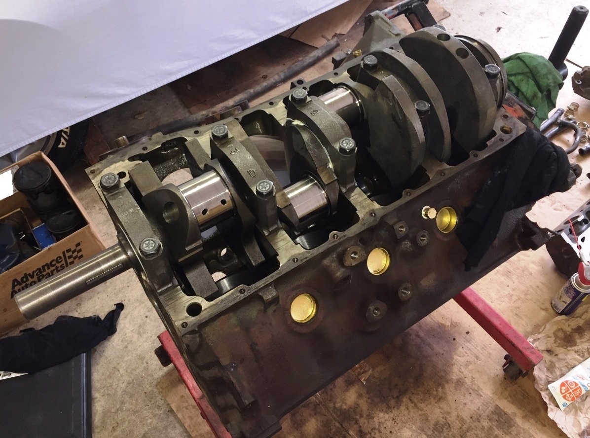

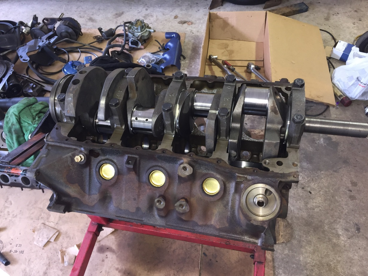

Chased all the threads in the block this morning. Then I installed the rear main seal, bearings and crank today. Oil clearance is .002, checked with the old Plastigage green. Nice, leisurely day in the garage.

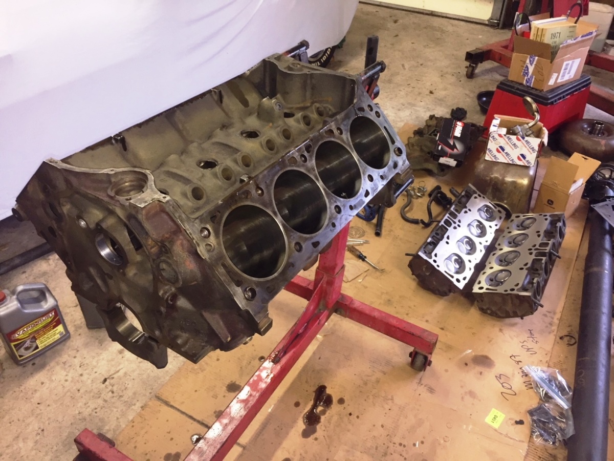

I checked all the ring gaps in the cylinders today. All top rings were .024 gap. All second rings were .028. Got everything ready for piston/rod installation this weekend.
