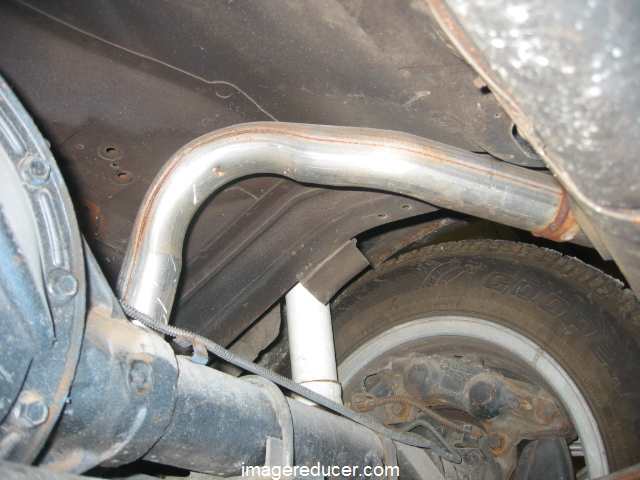

I've been following this car on Ebay and thought I would share it here since I won't buy it anyway. It says it has a 69 Camaro disc brake axle. I wrote to the guy and he said it is a BR code from what he can see. He sent a vague picture of the JL8 setup which I have attached. Seems like a cool car if the hood was changed.
Check it out:
68 Firebird convert with JL8

a BR axle is a 68/69 3.07 12 bolt posi axle, it's did not come equipped with JL8 brakes. A PR axle is a 68 12 bolt posi axle with 3.23 gears (as stated in the ad), it also did not come with JL8 brakes or rotors. Someone added the calipers and rotors to it.
