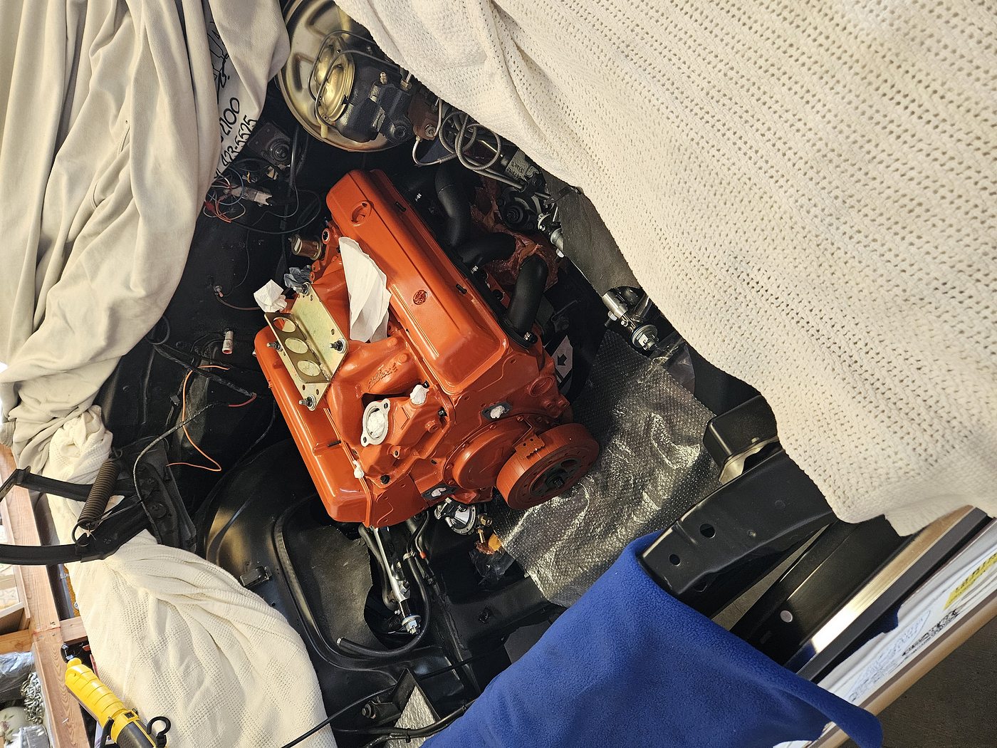

And after what seemed like months (because it was!!), it was time to install this little beast!!

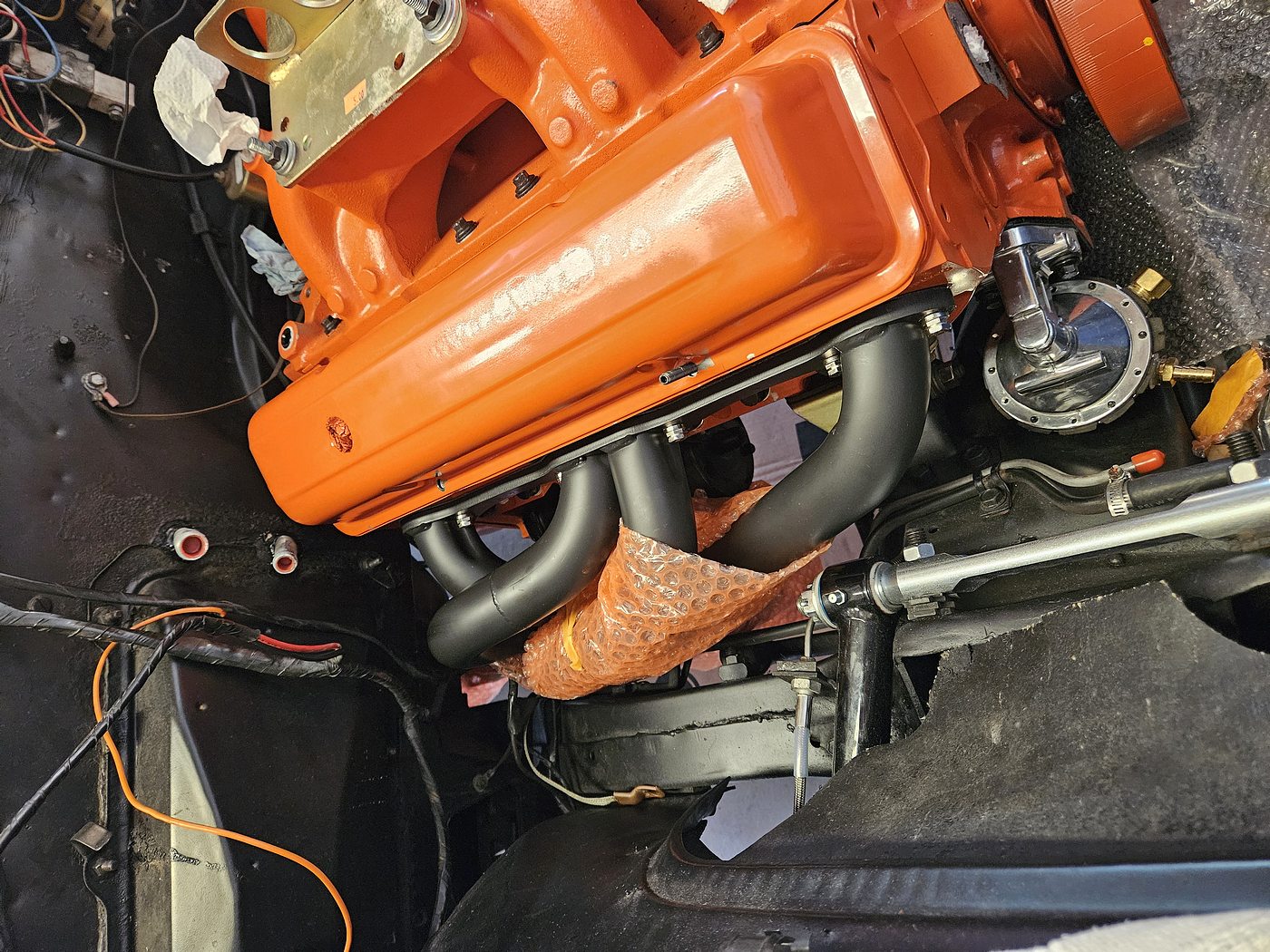

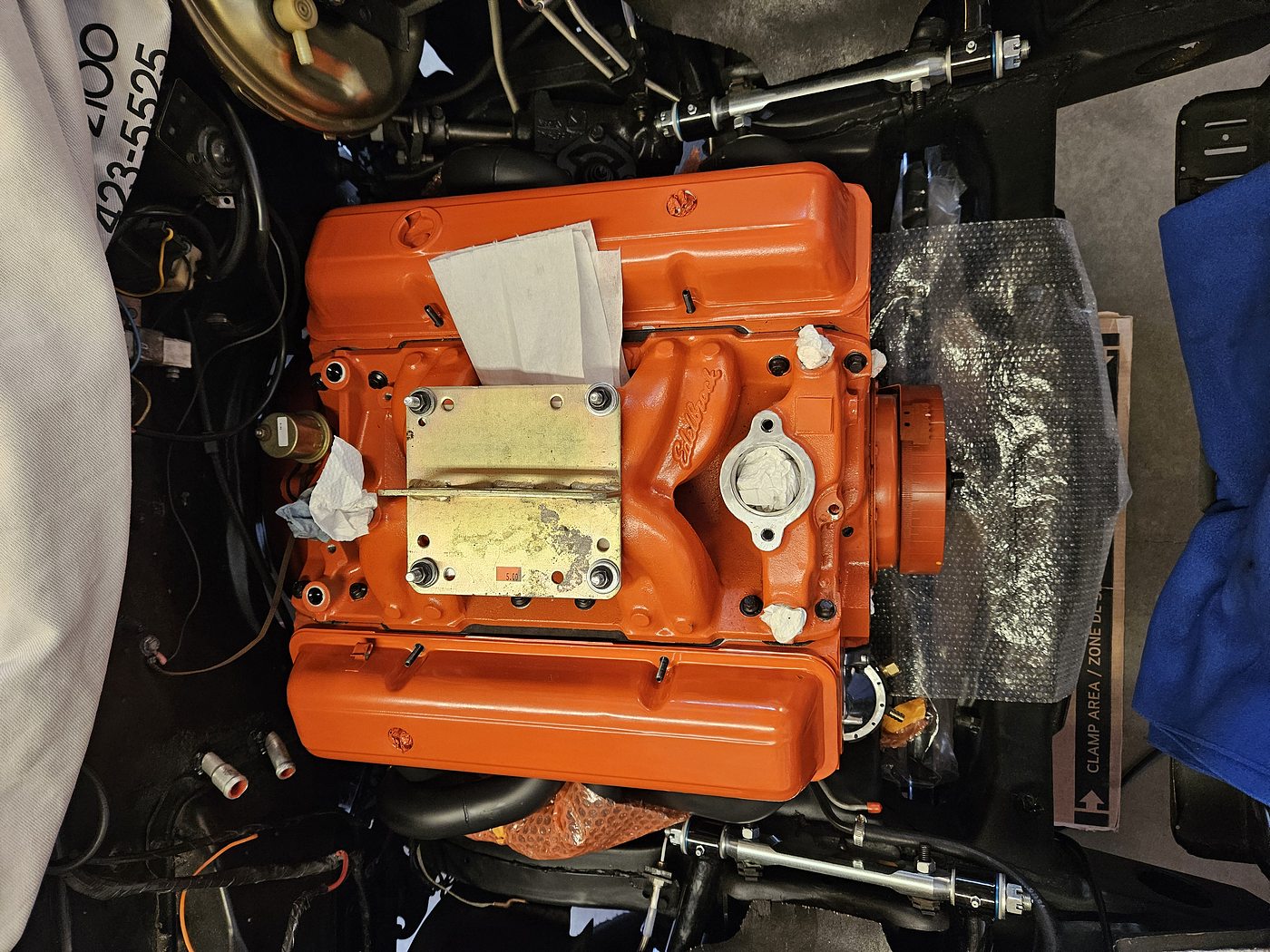

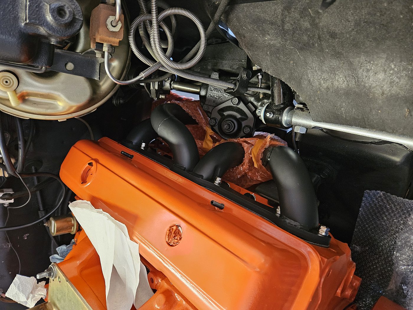

Looks snug as a bug in a rug!! Header clearance was amazing especially considering their size, 1 7/8”!!
