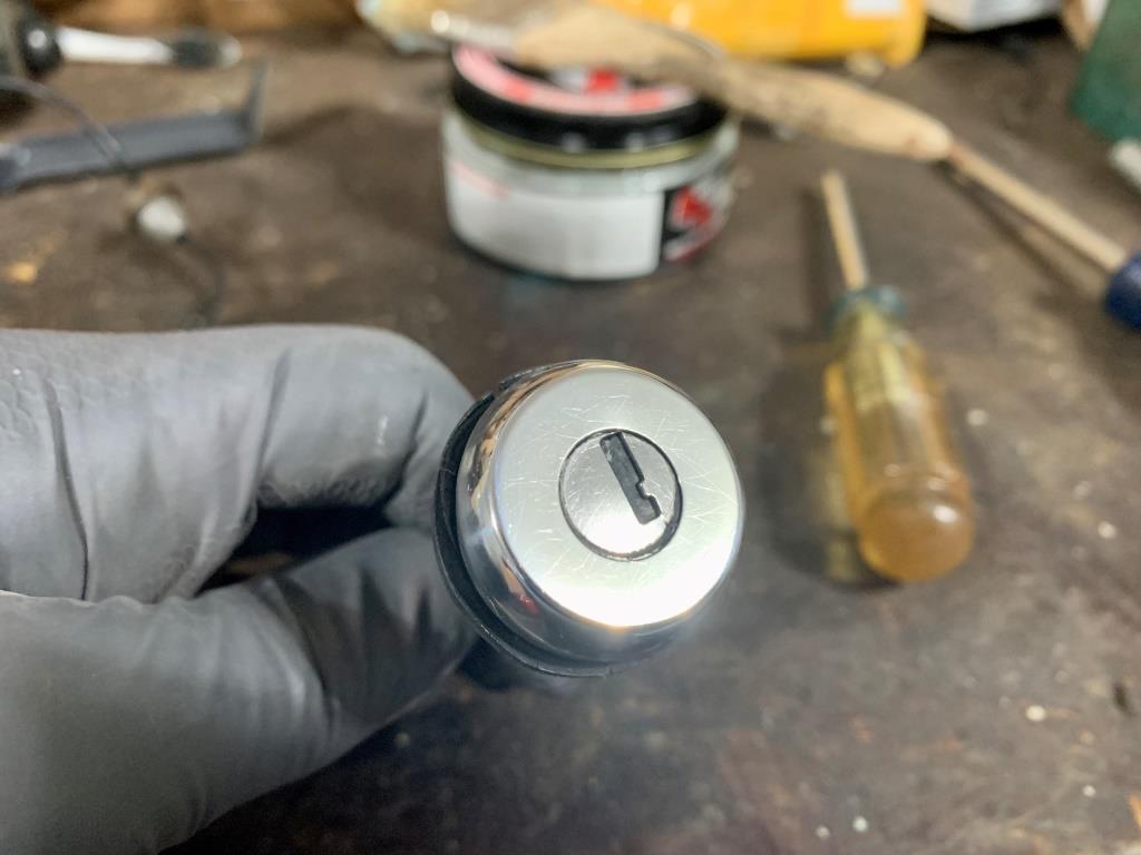

Photo 30 & 31 - While the trunk lock is out I went ahead and did a cleaning and polishing of it. Granted there is some residue in the key hole after polishing but will be removed and clean when reinstalled.

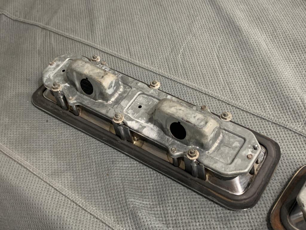

Photo 32 - 33 - Also while out I cleaned the tail light bezels and housings. Bezels were done with Zep Citrus Degreaser (can be purchased anywhere I'd assume but I get it at Home Depot) and a hand polish. Then the housings I did the same Zep cleaning and after wiping them down I used #0000 steel wool and a soap water solution and cleaned the galvanized. I think they turned out ok being originals.

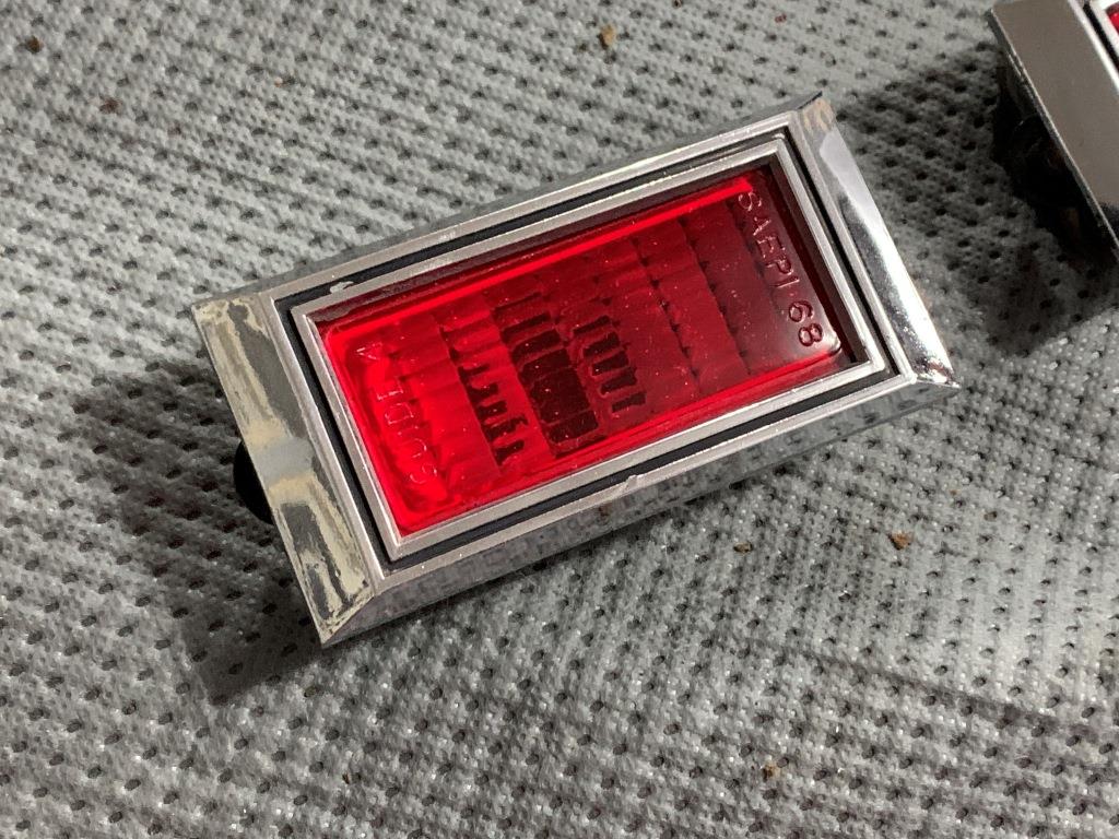

Photo 34 - 37 - Rear side marker lights were soaked in dawn soap and hot water to get them cleaned and then I used the da polisher and #205 to clean up the lenses. Sorry no before photos on these.
