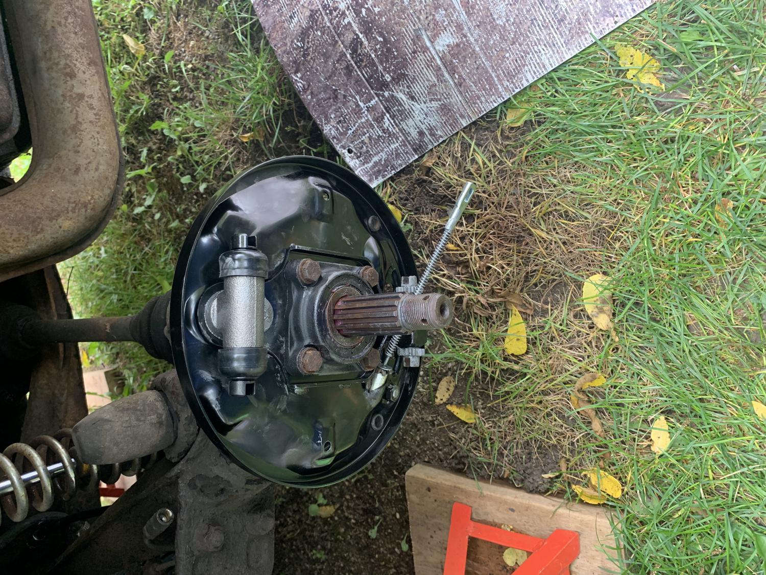

I got a bit of time working on the Beetle today.
Replaced park brake cables and assembled the rear brakes on one side.
Getting closer and closer.
I hope to have it ready for a drive or two before winter so it’s ready to go in the spring.

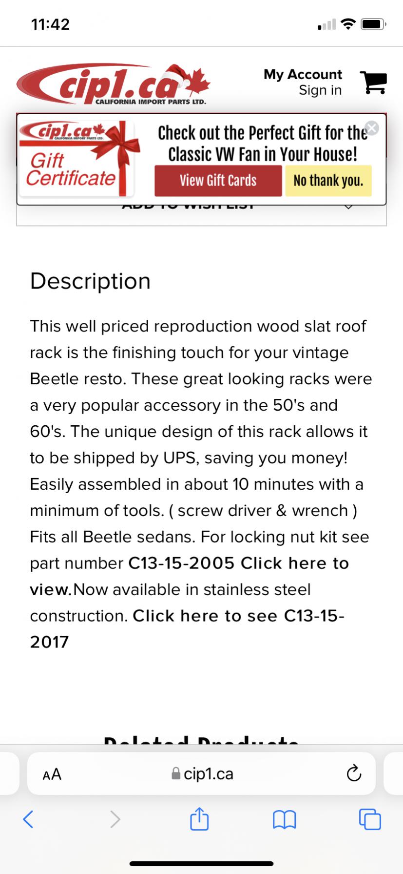

Amy gave me a stainless steel roof rack for my Super Beetle :-)
Can’t wait to install this contraption!!!
My Mom works/volunteers at a local “new to you” store,
She will keep an eye out for vintage leather suit cases or a Coke cooler or similar items to lash to my new rack :-)
