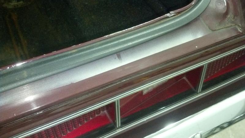

Here is the other side. I am pretty sure the car was never painted or they would have done the front stripes where the carb fire burnt the hood stripe. I can check with the original owner. I did think it was weird how it looks to have a taped area.
This is a non spoiler car also. If the decklid was on the car during stripes, which it about had to be to get gaps and stripes to line up, they would have had to have taped off the back of the car somehow
Bill

Totally correct. Decklids were installed before paint. Brain fart.
But again, weatherstrip after paint and I've never seen overspray there.
