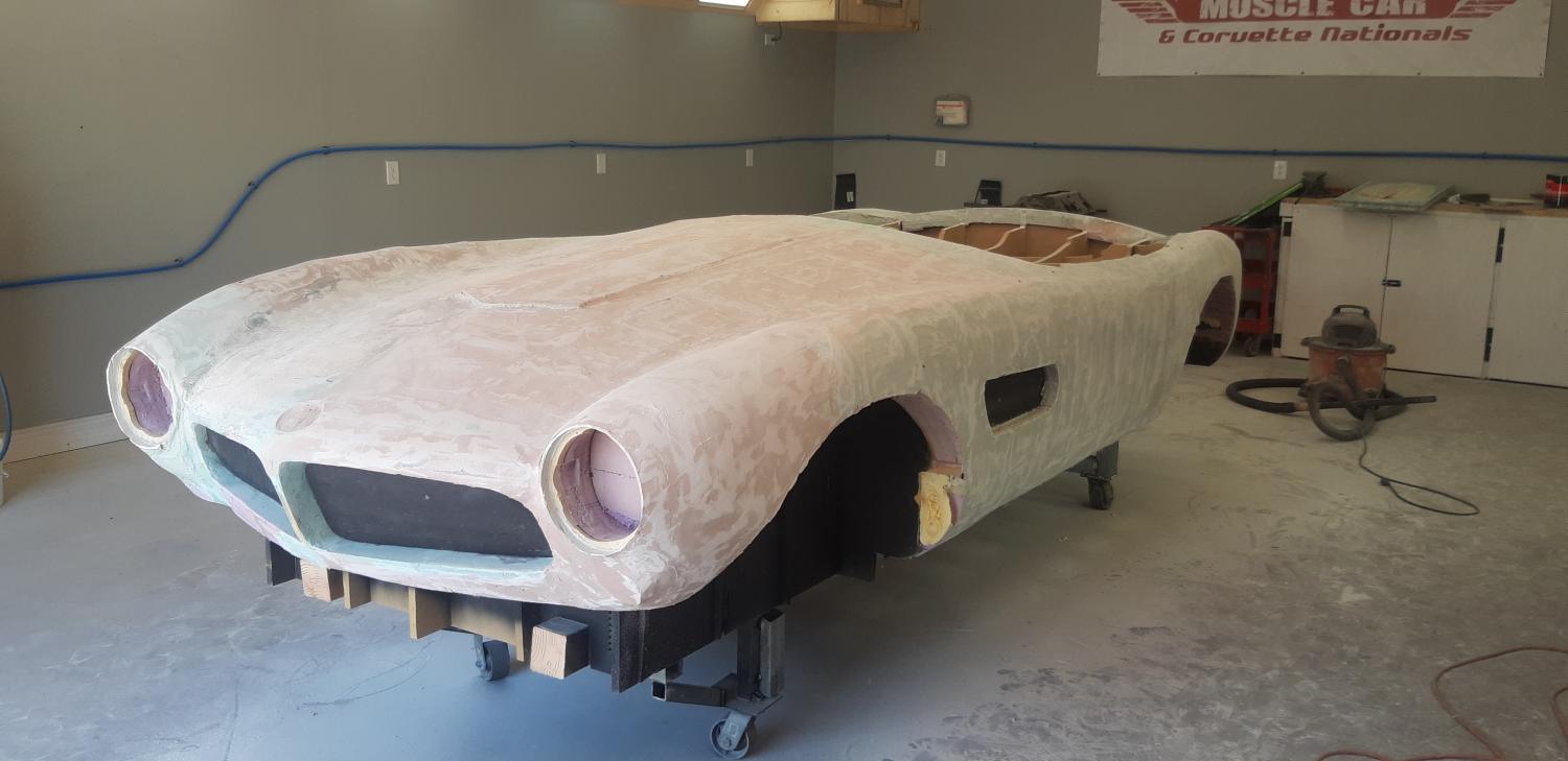

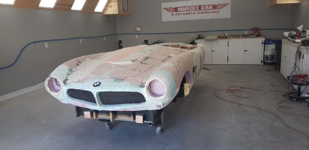

Back in the workshop, and the sculpting continues. The back end is starting to look like a car sgs the curves are matching up nicely!
More to come.... Cheers Dave |

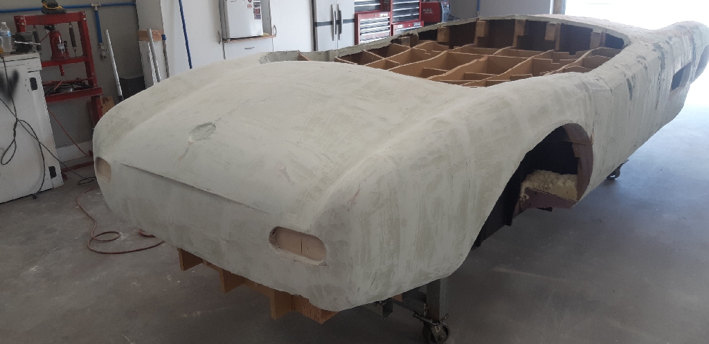

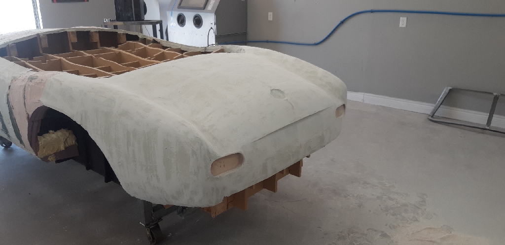

More refinement of the body plug. I'm back on the kick to make the body out of metal, but still think I should make a fiberglass one for the fun of it!
I'm hoping today to spray the first round of primer on. Cheers ![]() Dave |
