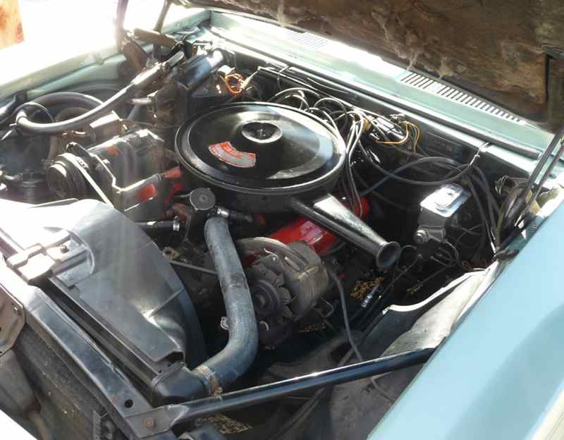

Has anyone ever seen the A/C compressor mount like that, that's not the way my 327 A/C car is nor any others that I've seen

This car had smog originally. The pump is missing but the bracket is there. On smog cars with AC this is correct.

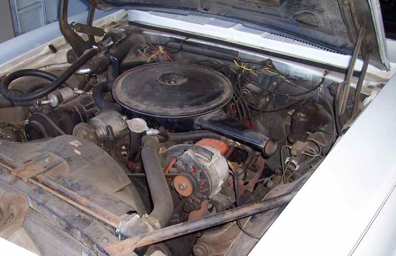

Same L30 engine in a '67 Camaro built a month earlier and coincidently from the same dealership. The K19 AIR system is intact on this one and missing on the car in the ebay ad.

Here's the ebay car's engine compartment...

Pretty crowded on the front top side of the engine with a/c, smog, & alternator!
eBay car master cylinder looks.....different.

Nice side by side shot to show where the smog pump would have gone.

Looks like the same air cleaner as on the 67 327 Impala.. Now I know why the snorkel curves upward to give room for the smog tube...
