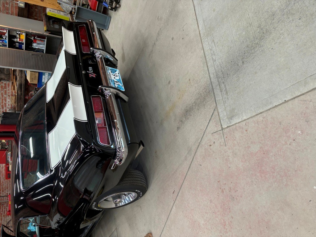

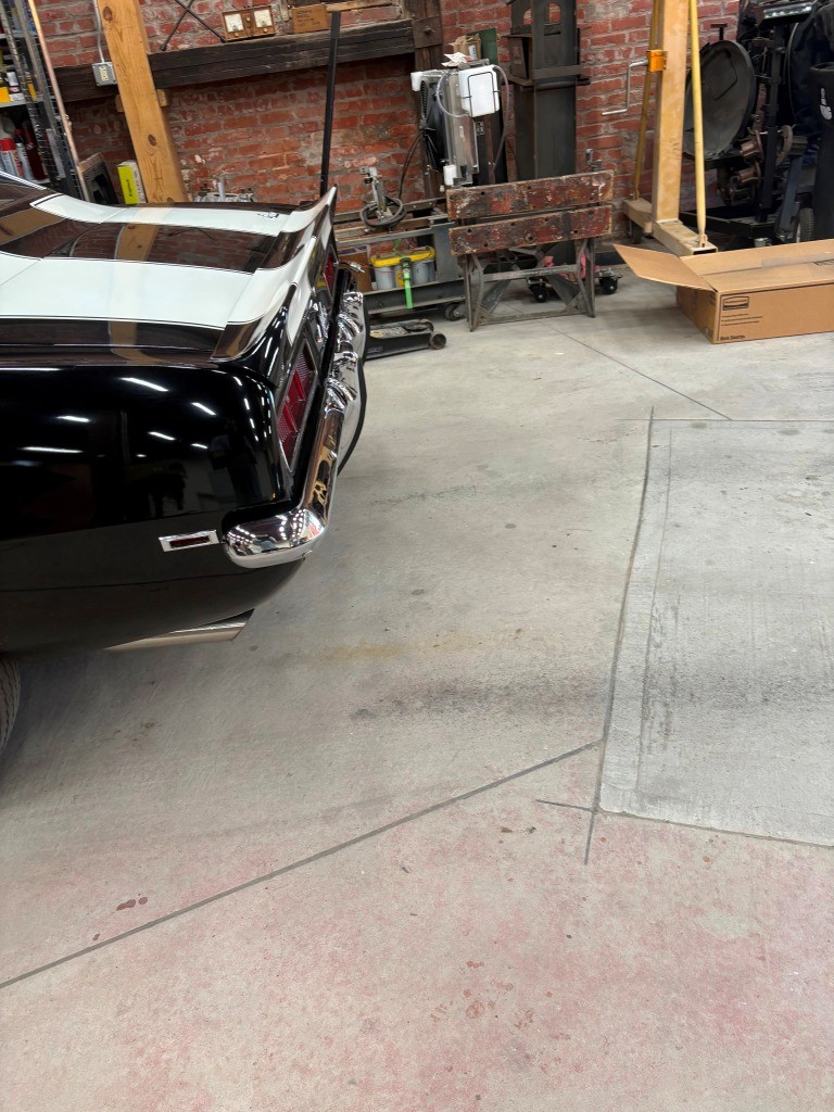

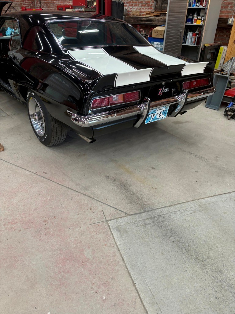

69 Z.
Late 10 10 car that actually came with the ducted hood.
Got seats put in today. No pics.
Put the subframe and front suspension on yesterday. No pics.
Put in a temp steering linkage from a 70 Nova so I can push it in and out while I detail the original steering linkage. No pics.
Worked on the undercarriage. Turns out there really is a right and left of the shock plates. Had to swap them. Finally, took some pics.
Fuel line in place (missing little clip at the back end). Went with stainless. I know it isn't original, but a worthy update. No rust. Going with stainless brake lines as well. Consider that a safety issue.
Plan to pull all the retainer clips off and detail them.
Park brake cables front and rear. My undercarriage was painted light gray in the back and got darker just ahead of the rear axle. So that is what I replicated. Color is pretty darn close. Man, it is getting dusty under there. You can even see some of my hand prints. Need to clean up the cob webs.
Took one shot showing the date code stamped in the floor pan, right rear.
Kind of cold out in the garage. Sherri and I are planning to build a workshop as soon as this thing is road worthy. Think I need a radiant heat floor. Hmm.... maybe should have built the workshop first. Sure am making a mess in the garage.
You can tell I don't know squat about photography. Just point the Nikon and hope it is smarter than me.
Attachments - The Supercar Registry side.web.jpg side.web.jpg Rear.web.jpg Rear.web.jpg
