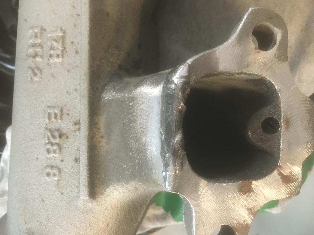

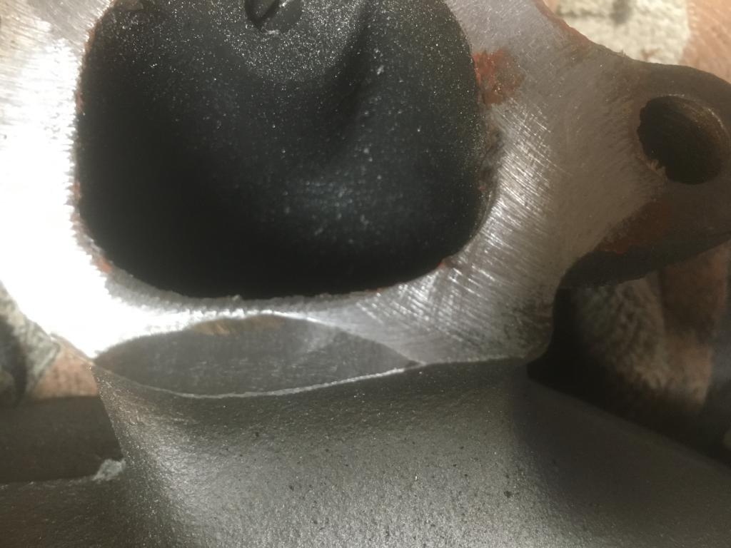

been plugging away at some nuisance items..fired and ran for a minute, wasnt very good [img]<<GRAEMLIN_URL>>/frown.gif[/img]..seems ARP head bolts interfere with the stock manifolds..had to remove them and add/grind some clearance on the back side...all coming together soon I hope. [img]<<GRAEMLIN_URL>>/rolleyes.gif[/img]

OK..fixed the exhaust leak/leaks
fixed the manifold I skrewed up [img]<<GRAEMLIN_URL>>/rolleyes.gif[/img]
found the dead cylinder..forgot to adjust no 3 exhaust [img]<<GRAEMLIN_URL>>/rolleyes.gif[/img]
replaced leaking intake gasket..antifreeze [img]<<GRAEMLIN_URL>>/frown.gif[/img]

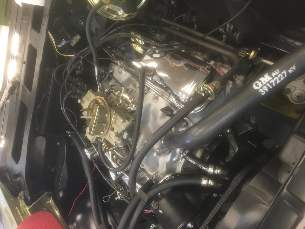

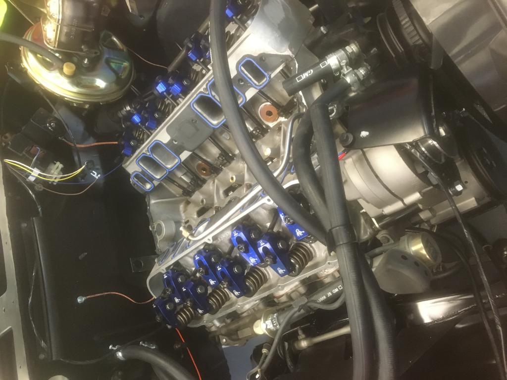

Nothing like raw gm performance. Looks good,did you modify the rocker lock nuts,set screws and studs to clear valve covers.

no..using the new &quot;cheater&quot; valve covers...1/2 inch taller! [img]<<GRAEMLIN_URL>>/naughty.gif[/img]
