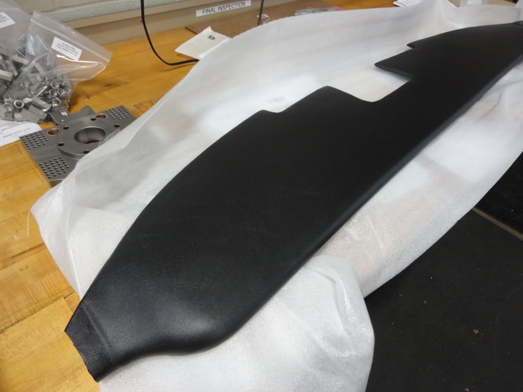

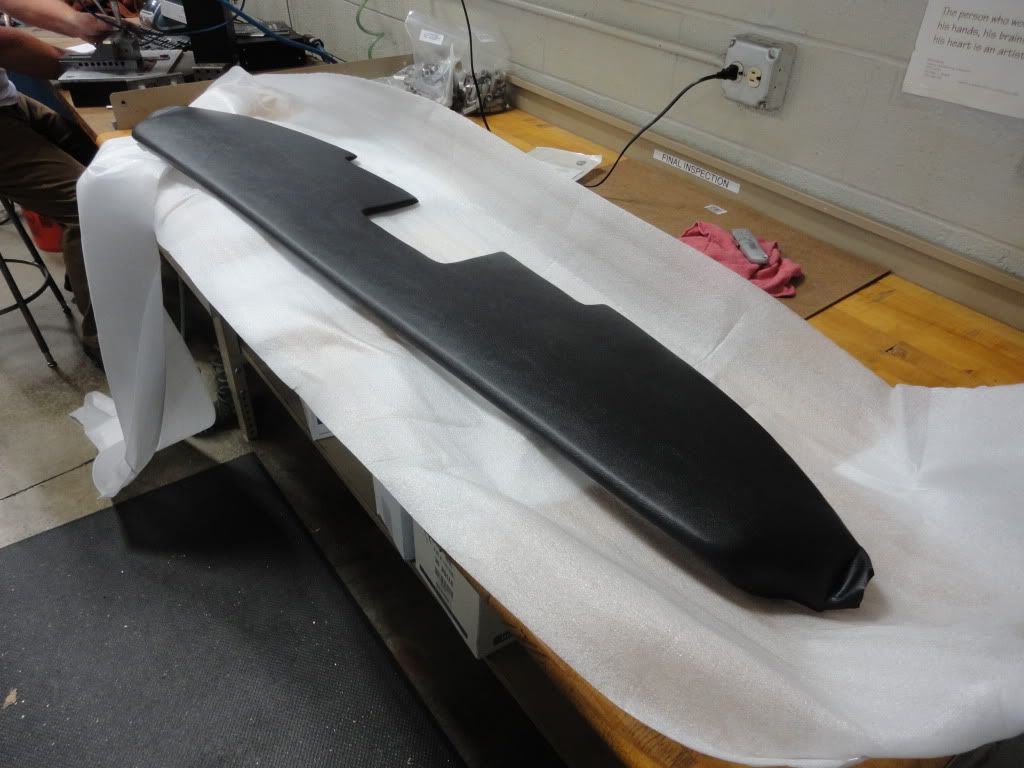

Got another package today in UPS from Just Dashes...........Just keeps getting better ......

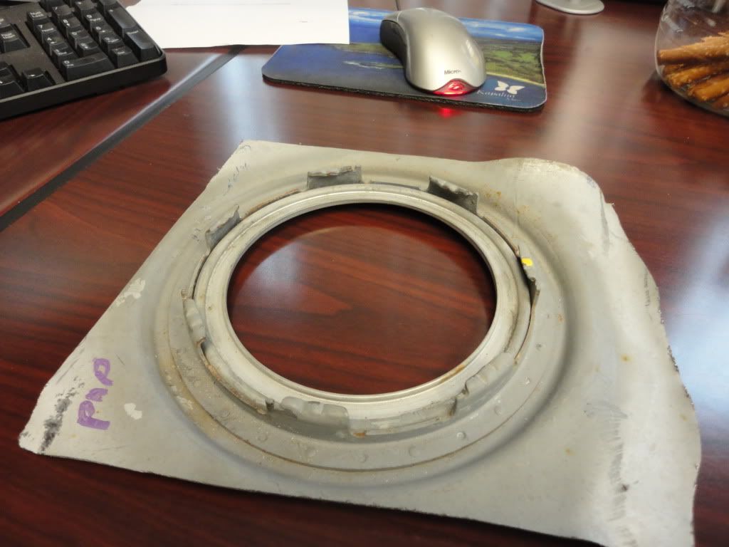

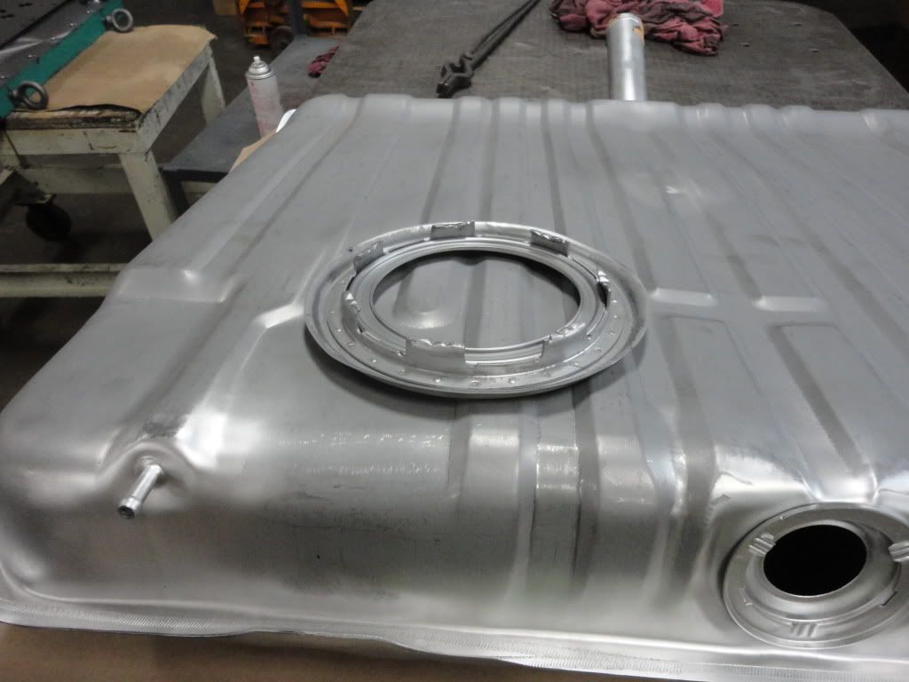

I also got my Fuel Pump assy mounting flange that was cut out of a GTO tank so I can continue with the fuel system/Tank modifications ( got it from Cleveland-Pick-Apart.....great people to deal with)

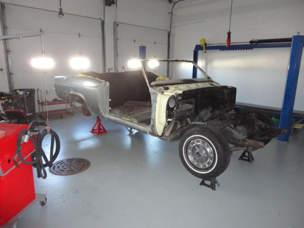

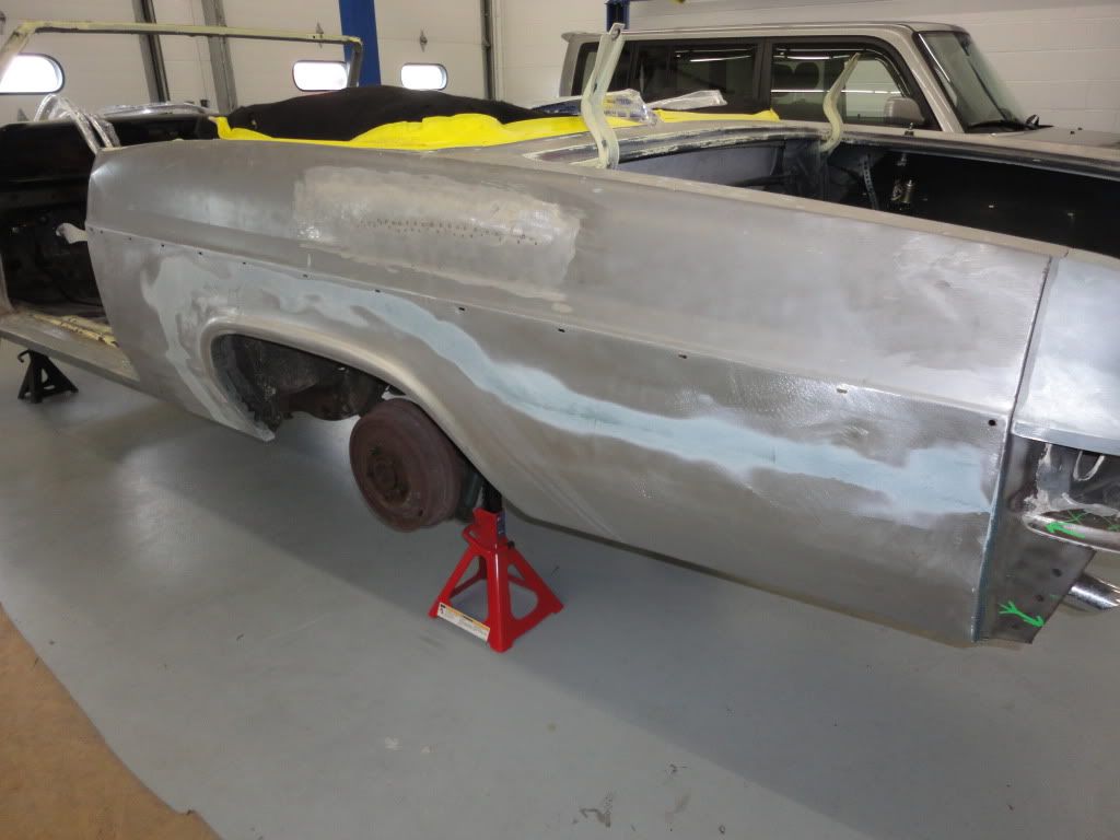

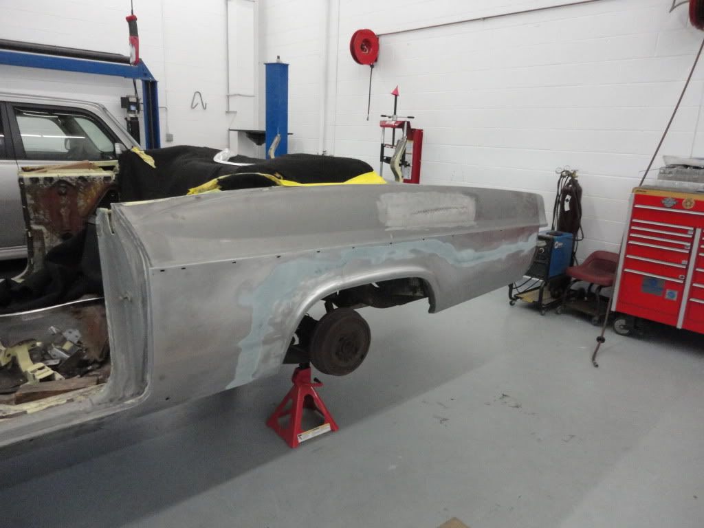

And.....I stopped at Pulera's to see the progress that George had made on the car.......He's gonna be on vacation for a couple of days this week so nothing's gonna happen till later in the week....But, he got the quarters pretty much finished last week........here's some pic's....

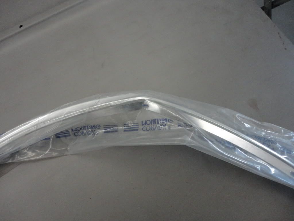

I also received a set of repro wheel opening mouldings that had one of the pieces damaged, called the vendor ......and here we go again.......Nuff Said!!

Wow...nice body work!

I also stopped at Pulera's today as it was Georges first day back this week........he has the passenger side quarter ready for priming........
And.....at the shop the next task at hand.......Getting the GTO pump assy to fit in the 66 Tank......More Pic's to come...
Right now it's a big mess, but......there is a plan.......

George was a busy boy today.....He got the passenger quarter pretty much finished and was doing some minor sheetmetal repair to the driver side wheelhouse today.......
