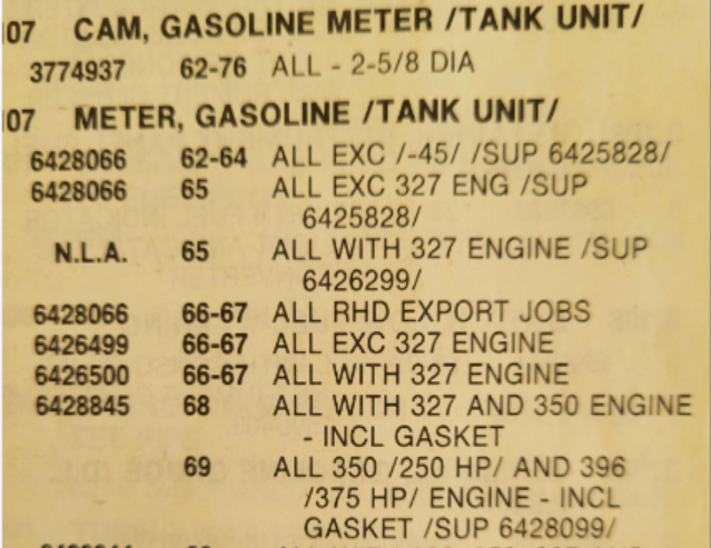

I found 6428845 as the part number for the 1969 Nova L78 sending unit in my parts catalogue (as shown at bottom of picture) Good luck !
