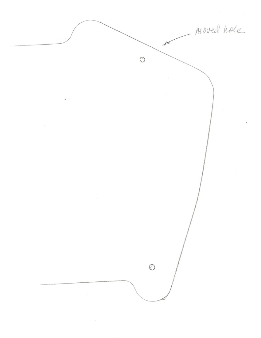

<div>There is a problem with the reproduction plates with this hole.&nbsp; Apparantly GM made several plates through the years and the 67-69 Camaro was different.&nbsp; I compared an original 67-69 plate with the reproduction plate and there is a difference.&nbsp; <br></div><div><br></div><div>I made a tracing of a reproduction plate I modified and have attached the image. &nbsp; You can make a countersink hole punch to duplicate the original holes.&nbsp; I Tig welded the original hole and repainted the plates.&nbsp; There were no prepunched holes on the firewall.&nbsp; See the C48 description in the Assembly Manuals. &nbsp;&nbsp; <br></div><div><br></div>

Thank you so much.
I knew someone would have the answer.
