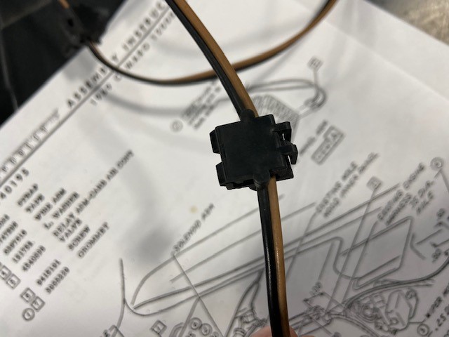

Does anyone know where I can source these clips for the wiring harness?

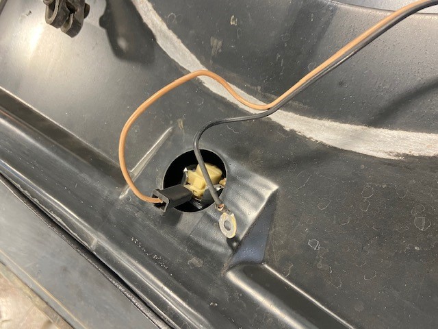

Also does anyone know where the ground wire attaches for the solenoid?

I believe the solenoid "ground" is the hood. Never seen that style connector on the end of the tan wire. Looks more like this with a rubber grommet.

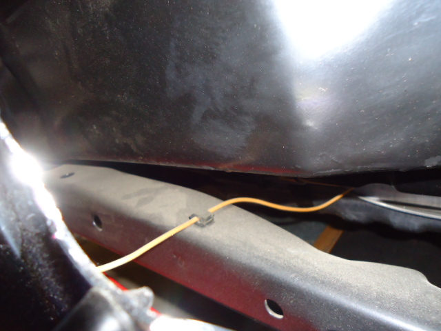

1969-72 Chevelles used that black clip on their tan fuel sending power wire as it routes down to the sock float sensor under the trunk floor.It holds it securely to the drivers side of the frame,behind the rear license plate door.
I used to pluck these off of every one I saw in junkyards and had amassed nearly 100 of them,but no longer have any as I sold most of my inventory off last year.
Here it is on my '70 L-78 Chevelle today.

I think it may just be easier to get a repop wiring harness that try to use what I have here.
All the clips are broke but 1.

I've got an original ZL2 harness right beside me... there is no ground ring on it, AND the leads through the firewall are PINK and TAN.
I am wondering if the one pictured is for a 73 up Corvette - because the hood is Fiberglass it needs it's own individual ground circuit.

That could very well be. After laying this harness out, it doesnt look to be an original for Camaro. Or else maybe its just a different harness altogether.
