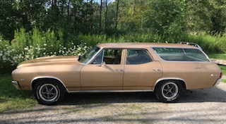

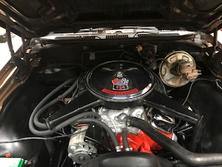

I put a ‘70 LS6 in my ‘70 Chevelle Wagon a few months ago. I used the original intake manifold and dual snorkel air cleaner mainly for looks, and I’m amazed how hard it pulls to 6500
