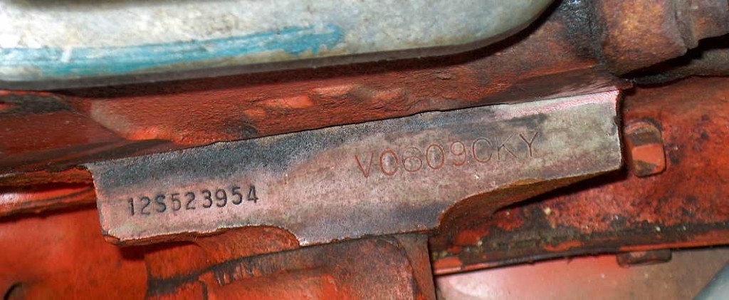

I asked for verification on the vin like you guys mentioned. Here is what we have: "The VIN is 1Z37L2S570383, and the engine pad has the number sequence stamped (12S570383), along with the larger font "(square)901 C K Y," which is also relevant. Here are a couple of pix of the data tag and the pad stamp."

----Could the 1 in your 12S570383 be a small cap L? Then it would match exactly. Im not the biggest 72 guy but the black book says it should be a large cap L to match the VIN. Dont understand for a minute how a small cap letter would have been substituted but maybe the L got damaged and they used a 1 for the L until another L was procured?.......Bill S

Bill I asked and here is what Kim said.
<span style="font-style: italic"><span style="font-weight: bold">&quot; I can barely see a shallower capital L in front of the 1, off to the left and more forward just slightly--but it's there. The 1 in the 12Sxxxxxxx is definitely a 1. Here's a picture--I don't have a good zoom lens for my camera, but I think you can see the L.&quot;</span></span>

Certainly a ground VIN on the pad, this is not unusual from the factory. Judging could verify that the VIN is is legitimate even with a ground pad. I had a 16,000 mile '65 with a ground pad. It happened.

<div class="ubbcode-block"><div class="ubbcode-header">Originally Posted By: olredalert</div><div class="ubbcode-body">----Could the 1 in your 12S570383 be a small cap L? Then it would match exactly. Im not the biggest 72 guy but the black book says it should be a large cap L to match the VIN. Dont understand for a minute how a small cap letter would have been substituted but maybe the L got damaged and they used a 1 for the L until another L was procured?.......Bill S </div></div>
I don't understand. This car's vin stamp follows all partial vin stamps for Chevrolet engine pads. 1= Chevrolet, 2= 1972, S= St. Louis, followed by the sequence.

....Matt,,,Im constantly learning, even at 65 years old, but why would the engine stamp have a 1 when there isnt even a 1 in the serial #? Im not saying it couldnt, as I just dont know. Please understand that I fully believe this to be the engine that came in the car new for other reasons (the ground pad), and am in no way trying to knock it.....Bill S

Bill, here's a stamp from another 1972 LT1.
