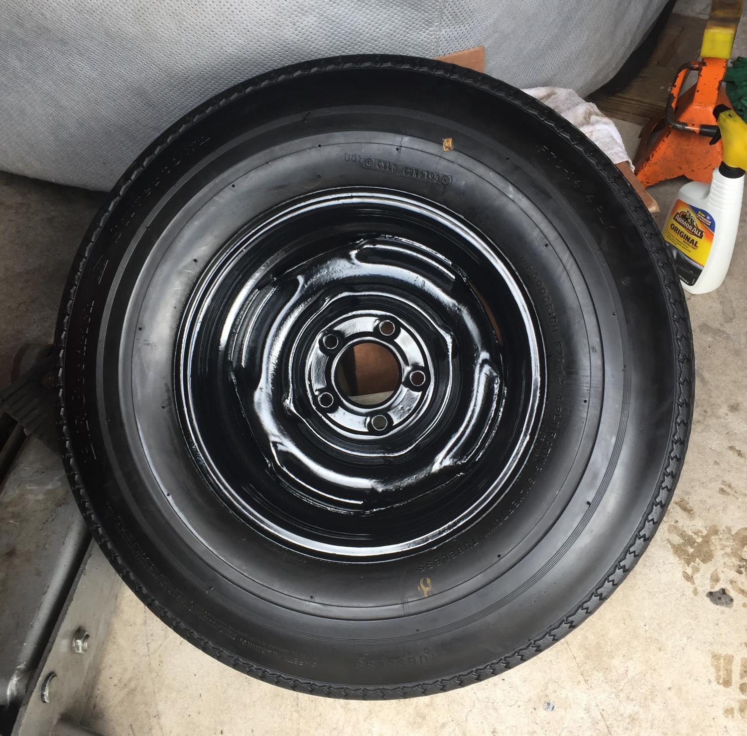

Thanks to 67Novaboy I have a F70x14 bias ply to use as my spare tire.
I was able to find a correct sized (though rusty)14x5-1/2 steel wheel off ebay from a seller in Rhode Island. After soaking it in four gallons of Evaporust for about a week I was able to get all the crustiness off it. I then used body filler to fill in the pits and it worked out pretty well.
It is probably from the mid 1970's so I am happy since I only paid $45 for it instead of several hundred for a part-number-perfect example of a 1970 rim. This one is a 3699402 rim which is stamped in tiny numbers above the valve stem hole which is totally not visible when the spare is mounted in the car. It also has a 4026530 sticker inside the rim. Anyone have any idea what its actually from or the date range?
