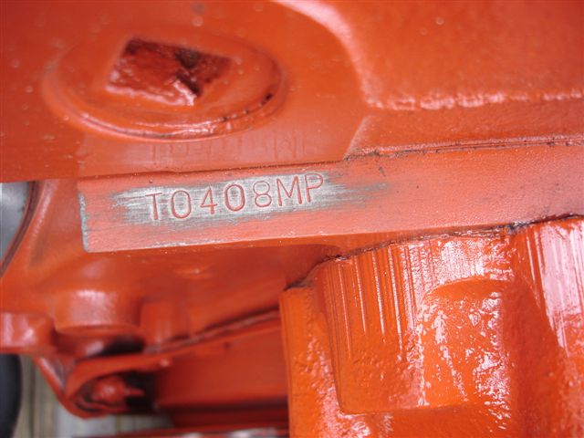

Well,
I guess I just got the opportunity to put my money where my mouth is!
I just bought this 69 COPO (chevelle) engine:
To go into this:
my original car from high school as found in a junkyard that I just bought and will be starting a restore on this winter!
Now I just need the tranny and rear!
Rich
Rich Pern
69 Camaro COPO "Tin Soldier"
  #83
Old 09-30-2007, 09:42 AM

What happened to the plug in the rh head?

Looks like paint over grime? It was picked up yesterday by one of my employees and will be here sometime tonight then I can make a proper assessment.

[/ QUOTE ] Actually it normally protrudes from the head 1/8 of an inch or more. The fact it is recessed or ground means you should inspect the block a bit better before purchasing to ensure it wasnt alterted so the block could be stamped with the head still on. They also break alot,just might be a coincidence. Check the exhaust manifold side to make sure it isnt restamped, so hard to tell by the pic but it looks a bit smooth on one end of the pad

That´s the engine that was for sale at SCR9. The experts said it was a restamp.

It'll be here in a few hours, so I can get some better pics, so far a few respected people (based on the pics I had) said that it looked pretty good. I was told that it has been in central Texas for some time? Of course, as allways, won't know until I get it here and get some close ups to Jerry and Kurt!
Best of all, even if it is a just 512, I got it for a great price, if it is a real MP, then I got it for a smokin' deal.
What was the VIN on the 427 at SCR9 ?

looks like you will have to pop the head and confirm the faint broach as real or not.

It just got here. I paid right around $6,000.00 for it, which if it is a real COPO is a smokin' deal, if it is just a restamp 427, then as a running motor, only .10 over, fully rebuilt and complete, than that is OK too.
It will probably be next week before I can pull the head, crusin the coast started today, and I am heading for Mississippi tomorrow.
I guess we can start with is there anything that precludes this from being a Chevelle COPO motor (ie VIN vs dates, any other external clues?)
Cast 3963512 P
GM 4 HiPerf Conv
Cast Date C 11 9
A
Heads 840's C 27 9 and C 28 9
Suffix T0408MP
Vin 19K465533 (I think)
Rich Pern
