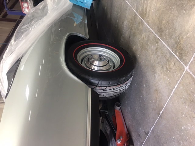

What size are the drag radials and what size wheels are ou putting them on?

They are 275/60/15's on a 8 or 9" rim I don't recall. When i mount them i will confirm rim size

Please measure the backspace on the rims while you're at it.

You can do a 15x10 with a 5.5 back space and use 295 tire or a 15x8 with 4-4.25 b.s.

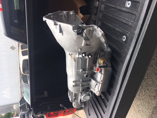

Just picked up my 400 trans from FINISHLINE today not only does it look good it will handle the 700 ftlb of torque!

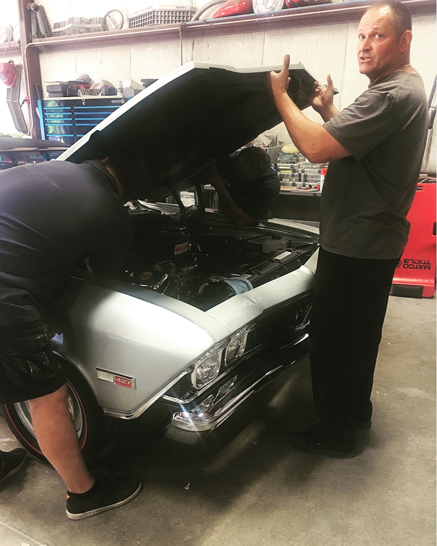

Like to say a BIG THANKS to all the guys at NOSTALGIC AUTO BODY today for all there help! A
