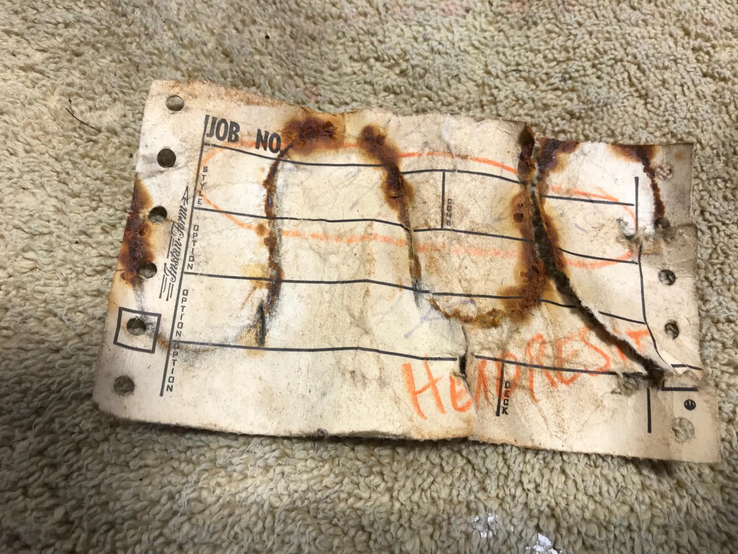

Looked today for build/broadcast sheet no luck but I did find this tag in springs of driver side bucket.

Awesome. Interior Broadcast Sheet!!
I’d need to see it up close to decipher the hand written codes I can barely see but no matter. It’s a Birth Certificate

I see 13817 in the upper left corner. You can actually make it out better in pic than in person. I’ll try to get better look and write down what it says.

Within that orange circle to the right it looks like 7_3 S can’t make out middle letter cuz of spring imprint. But interior code is 763 S which is black bucket with headrest code
