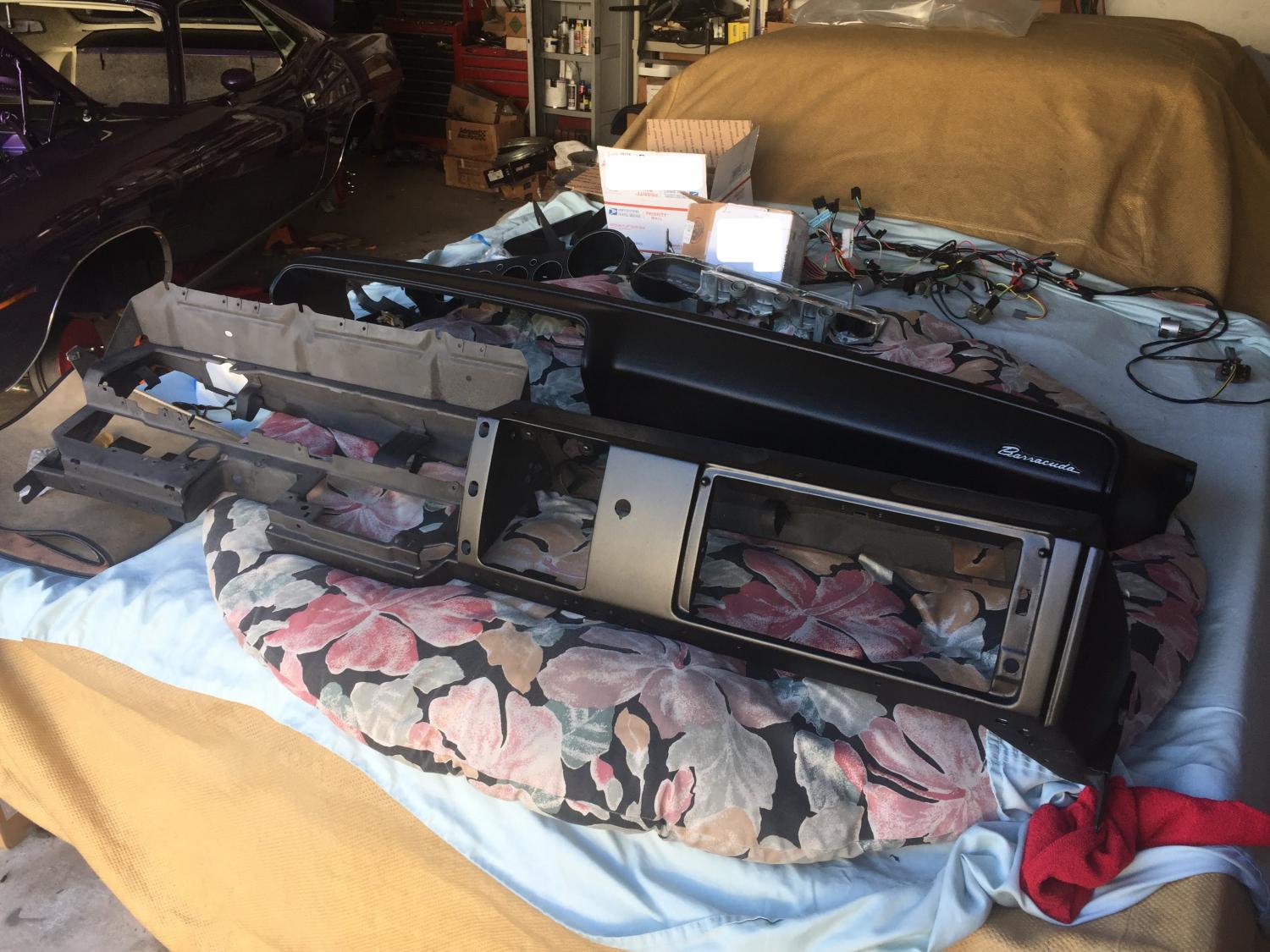

I also decided to reuse the original dashpad since there were only two minor cracks by the front speaker grill screw holes - a common occurrence. Since it is around $800 plus $200 core charge to get a reproduction dash... and none are available now, I decided there are better things to spend my money on...like vintage mag wheels.
I wound up using some JB-Weld epoxy and gently pushed it in to the cracks with a tiny screw driver. Once it was filled, I waited for it to cure and then sanded. I then sprayed the entire dash with SEM Landau Black interior dye (I LOVE that paint - I put that s@$& on everything!). Here's the results.
Not bad from a foot away or so and now I don't have to mess with transferring the vin tag to a new dash pad (Stupid Chrysler design - lets rivet the vin to a removable part!!!)

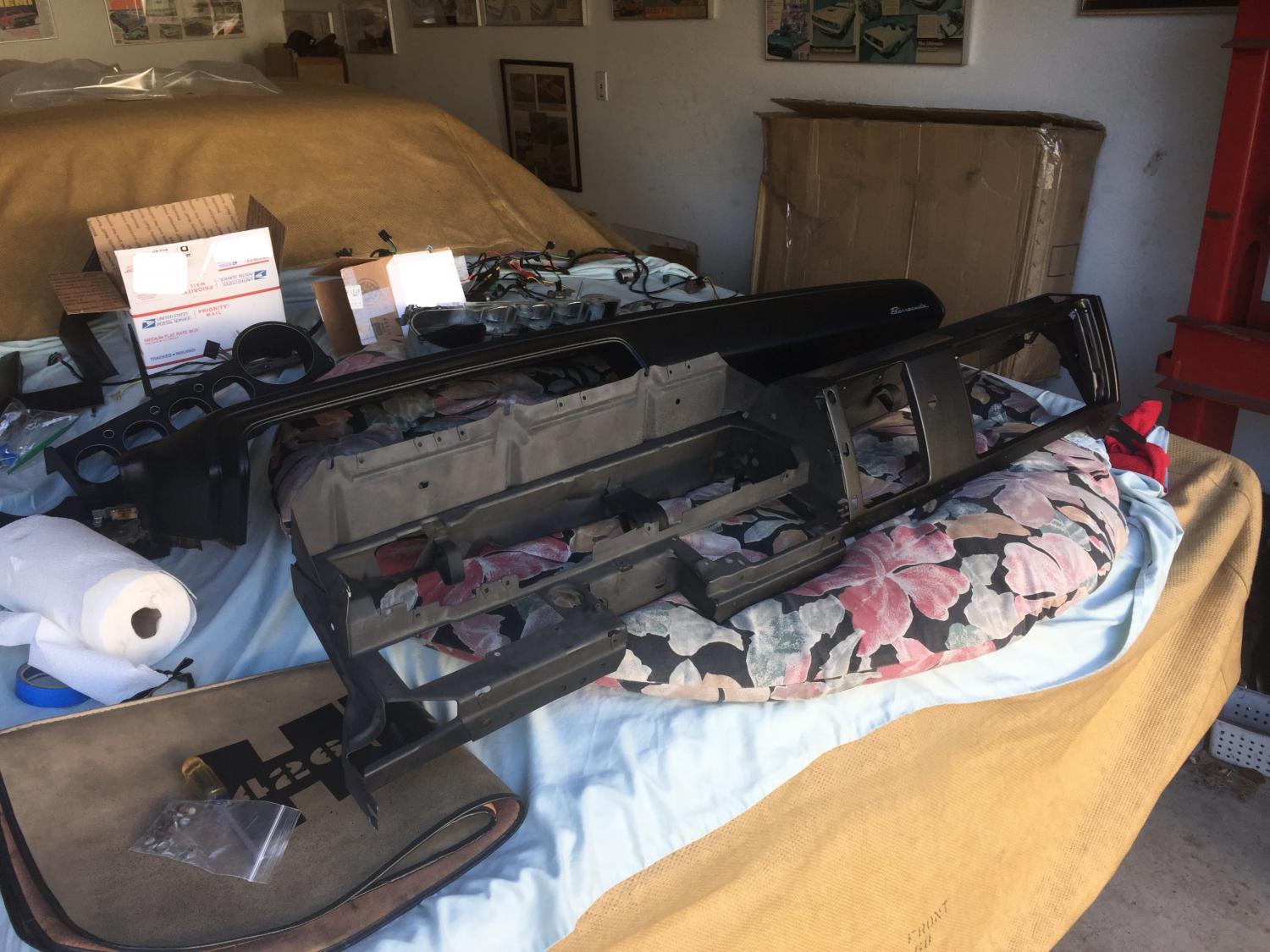

I also got the dash carrier assembly disassembled. There was a lot of crustiness on the underside so I rigged up the pool cover siphon pump and a short hose and have it circulating the Evaporust solution via a spray tip, onto the dash frame. It all drains in to a sheet of plastic that ends at the bottom of a 7-gallon bucket. The siphon pump has to be fully submerged to work, so you want that at the bottom of the bucket inside the plastic sheet which acts as a funnel to direct all the runoff back to the bottom. I got the aquarium heater in there too. The kiddie pool is there as an emergency backup in case it all springs a leak.
