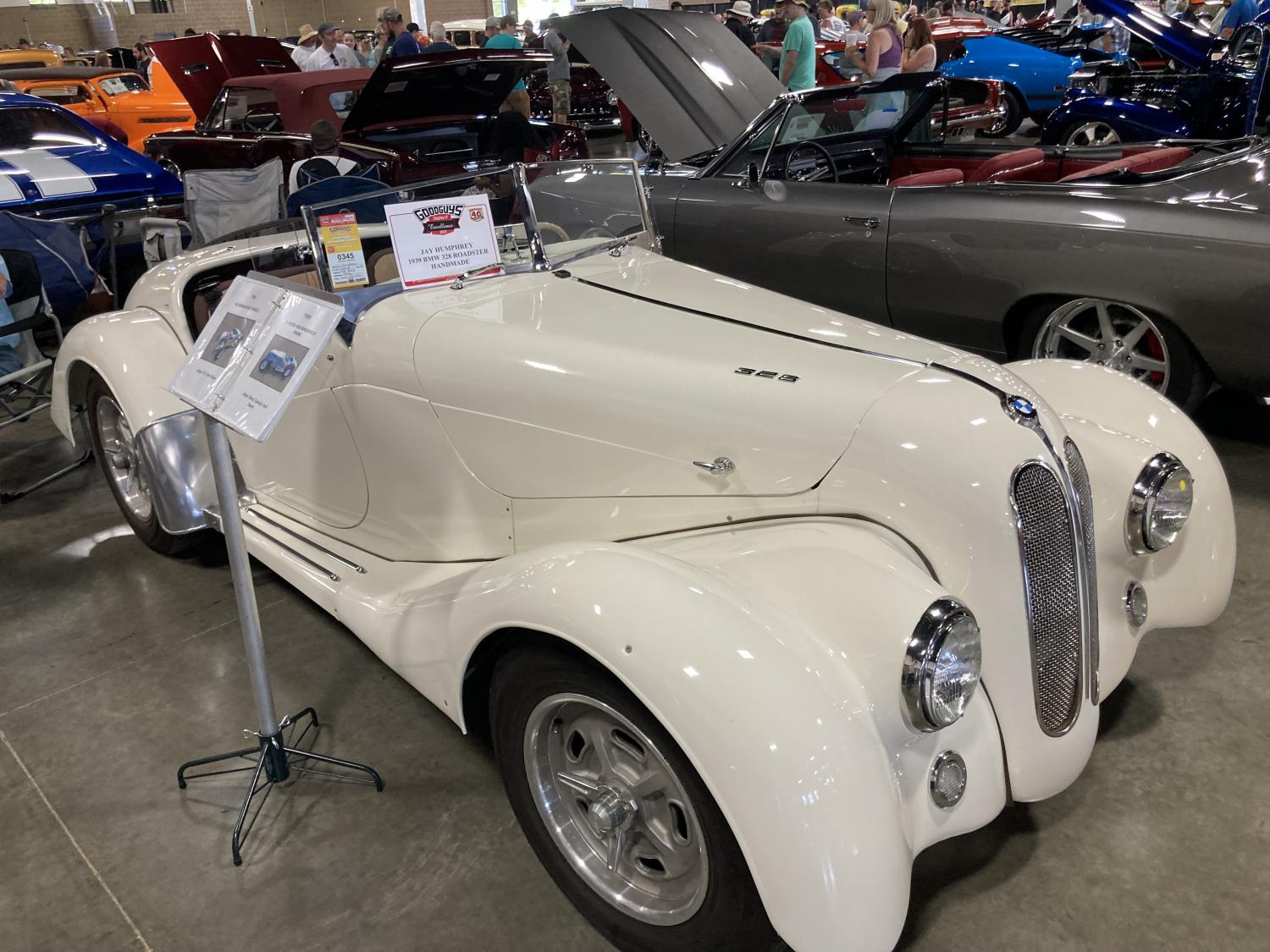

I was at Goodguys today and showed a nice older gentleman pictures of your build. I thought he would appreciate it since he decided to recreate a ‘39 BMW 328 out of thin air for himself! His uses a drivetrain out of a ‘70’s 2002.

Thanks, guys! Wow, Tom. That’s slick! It does resemble the Sbarro 328 replicas based off the 2002s. That might be one since it's based off the same platform. There’s far more 328 replicas floating around than 507s. Looks like he did a nice job on that one!
