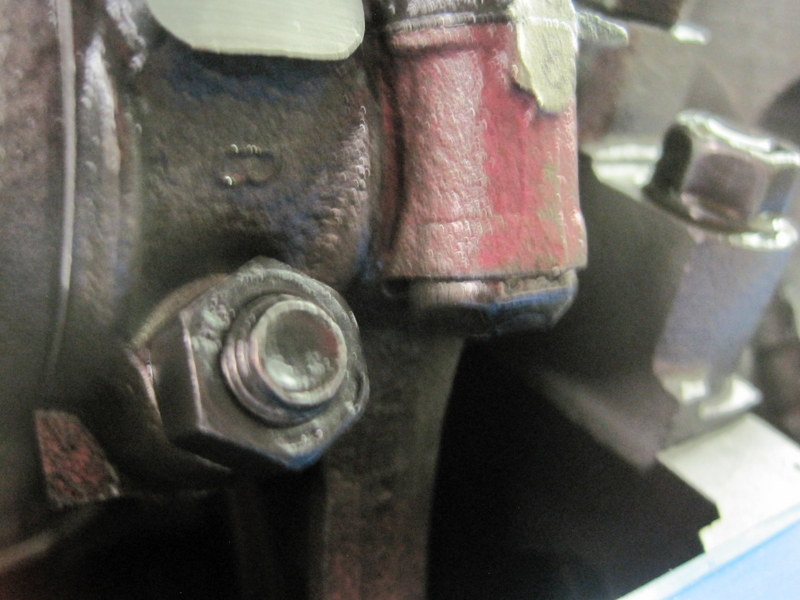

If your engine parts are original and the machine shop hand cleans the connection rods, they should be pink rods.

They are pink, however I would have assumed they were full floating rods but they are pressed pins... I have a couple of extra sets full floating 69 Z rods however we just used the originals.

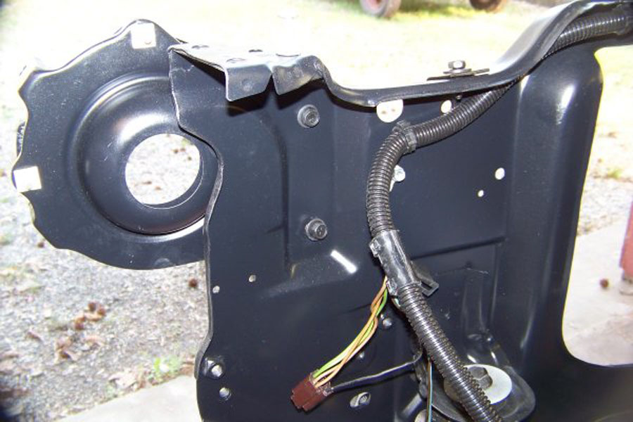

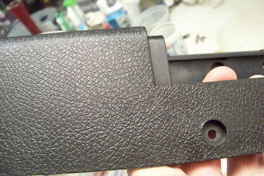

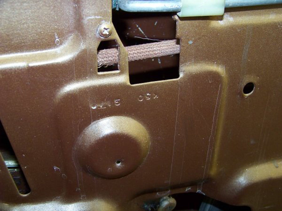

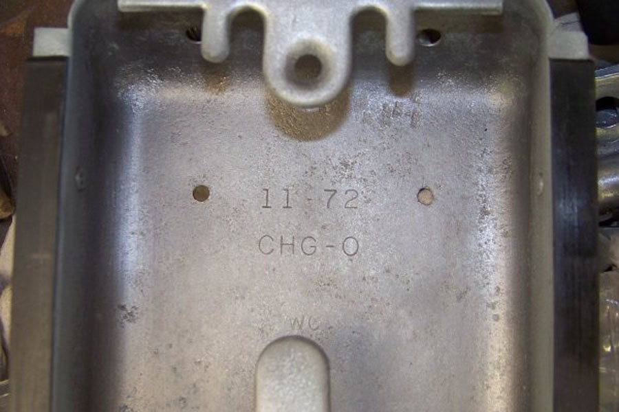

Door Dates - Quarter Dates-
Original wire harnesses corrected removed plugs, cleaned terminals, threw the plastic in the dishwasher and then refitted all the plug's and connectors after replacing missing and wrong wires, colors, & sizes then re-wrapped or re-sheathed in plastic conduit.
NICE Original dash plastic with Argent Trim -
Replated the ash tray -after cleaning realized it was the dated original - 11-72 unbelievable.
~JAG~
NCRS#65120
NUMEROUS Lemans blue Camaros,
& a Chevelle or two...

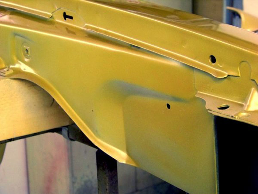

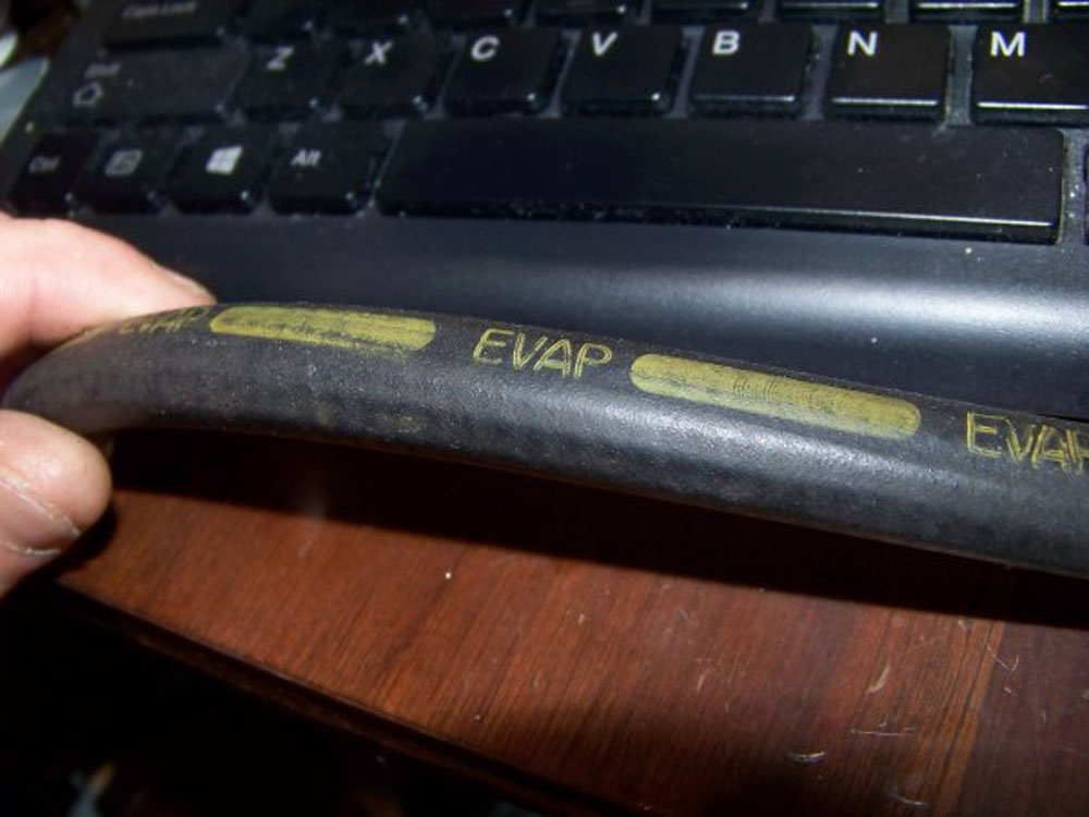

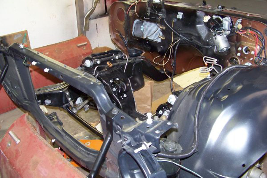

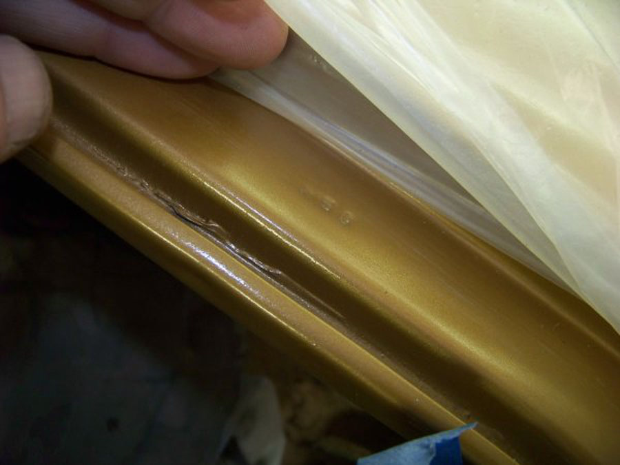

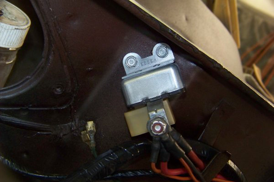

Emissions evap duct?

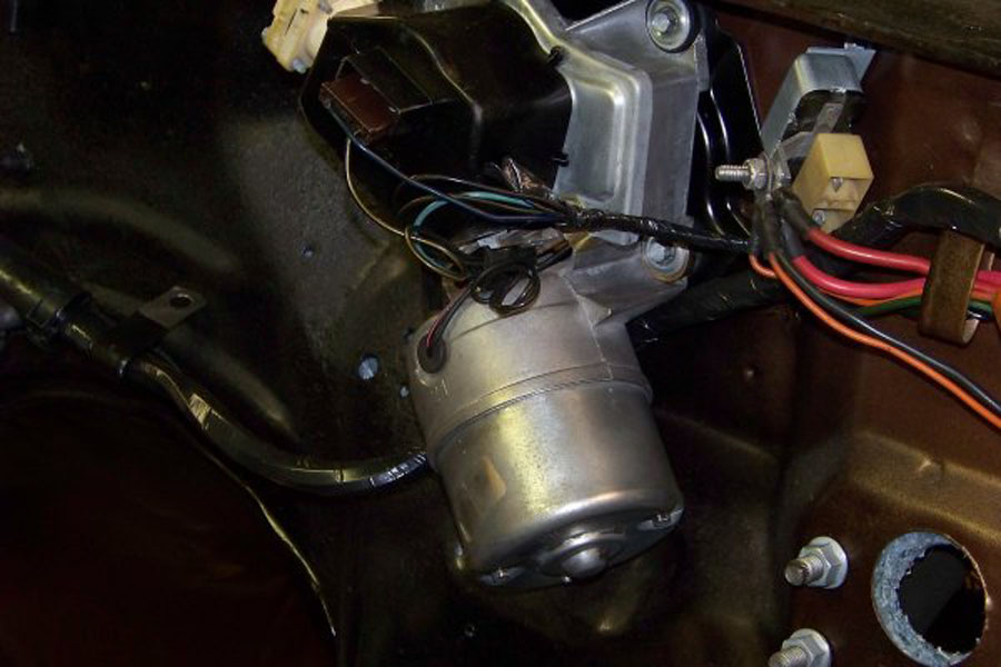

Horn Relay - replated cover and stud
Wiper motor - replated screws and washer brackets

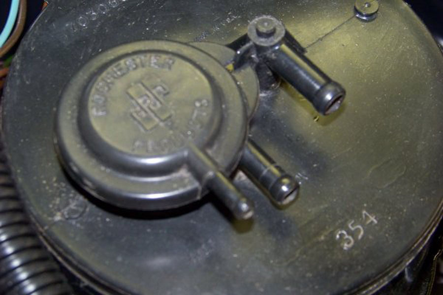

Original Evap canister... is 354 the julian date?

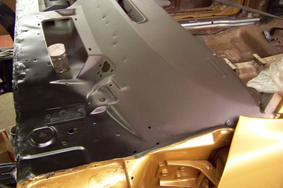

Core Support
detail of light overspray down the fenders - from being on a buck with small gap between fenders and hood.

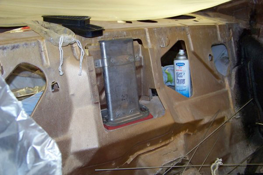

Firewall and front end

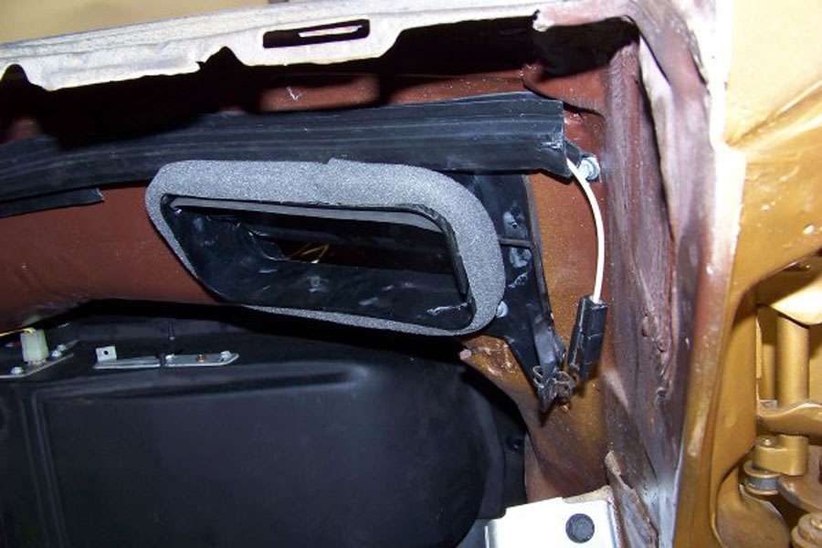

Interior Ducting and seals

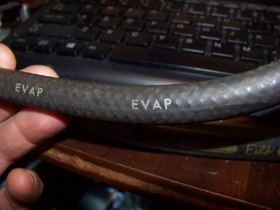

The original EVAP lines - white lettering - and Yellow Lettering Yellow Stripe.

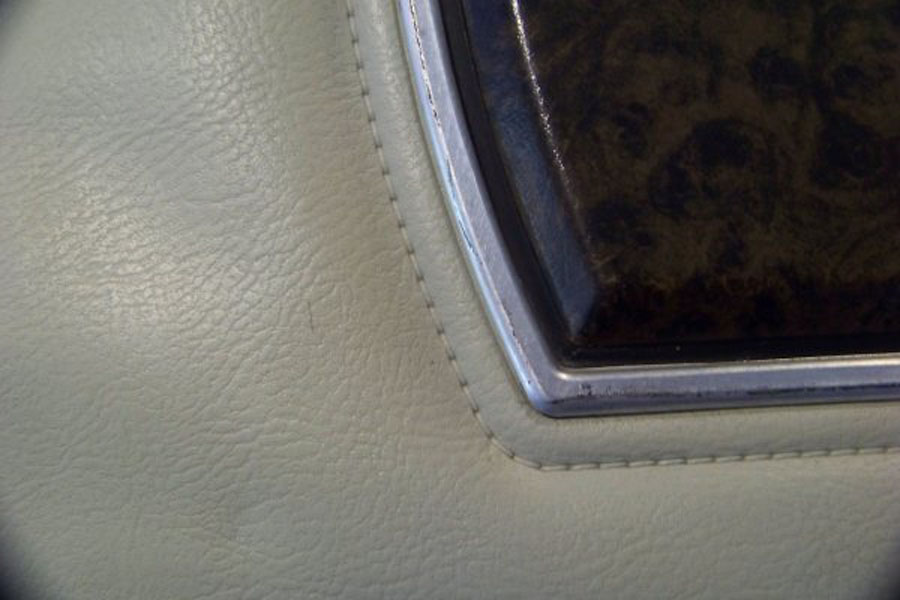

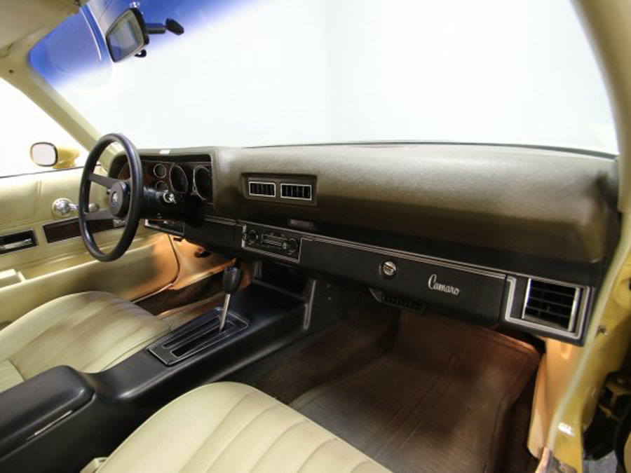

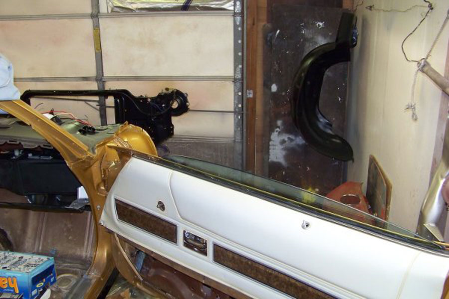

I am looking for any REAL Neutral Comfort weave material that anyone may know about....
I believe early 70's
First two are the original door panels which had been MARHYDE painted black, I cleaned them with a tooth brush and Goof Off, it took over a half gallon to remove the Marhyde.
The second two are an ORIGINAL low mile Neutral Comfort Weave interior - code 788 - I can only hope the interior turns out anywhere close to this nice....

This project sure does inspire me to finish my '73... (working on it slowly, but finally making some progress).
On the evap canister date code question... You made me go look at mine.
Yours: 354 with an 01A car body.
Mine: 039 with an 02A car body.
Appears to be a date code as you suggested...
Keep up the great work !
Charlie
Thanks... that pretty much confirms it as a julian date.
