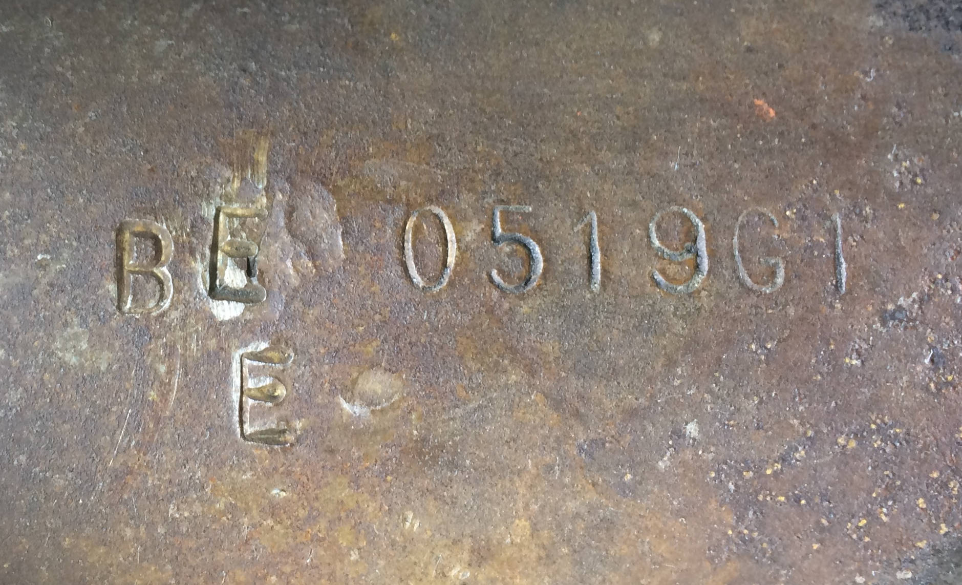

<div class="ubbcode-block"><div class="ubbcode-header">Originally Posted By: 70 copo</div><div class="ubbcode-body"> What I will say is that the obliteration marks are consistent with a known manufacturing plant correction technique as recalled to me by the spring and axle line workers. It is troubling that segments in hobby keep calling most everything with a stamp deviation that does not fit a narrow interpretation fake. </div></div>
You make a good point Phil. With as many inspections that I do every year it has almost gone the other way. When the stamps look too perfect I start to worry. I wrote off a CRV 3.31 rearend as being a restamp about 2 years ago and actually bought it and put it into my inventory. I thought it was fake as you could clearly see that the face had been hastily ground off and restamped in the stamp area of the axle tube. Fast forward 2 years and I get another LS6 in the shop. While inspecting it I see the same exact thing while forgetting about the other rearend. I was going to write it off as a restamp as well but something kept nagging me. I finally remembered the other rearend and bingo, almost identical and within 5 days of the car in the shop. I conferred with Chris White who also confirmed that he felt it was real. Never say never! This is also why documenting these types of anomalies are so important.

My low mile LS6 also had a ground axle stamp area, not typical thats for sure. I will post pictures of the BE in question after the paint was stripped. The oxidation is very consistent in all the stamps. I think it is just a non-typical stamp, especially since it has a very difficult to find dated BE posi in it.

Here's a better pic. It is not an 'anomaly', IMO.
If the collective wants, I will stop giving opinions on stamps. It's low pay anyway....

<div class="ubbcode-block"><div class="ubbcode-header">Originally Posted By: camaromb</div><div class="ubbcode-body">My low mile LS6 also had a ground axle stamp area, not typical thats for sure. I will post pictures of the BE in question after the paint was stripped. The oxidation is very consistent in all the stamps. I think it is just a non-typical stamp, especially since it has a very difficult to find dated BE posi in it.</div></div>
So, you're saying the internals are COPO ? The carrier internals &amp; R&amp;P are correct ?

This rearend in question has a E 9 J dated posi with correct side gears, round spring plate, etc. The gear set is not original, Richmond.
