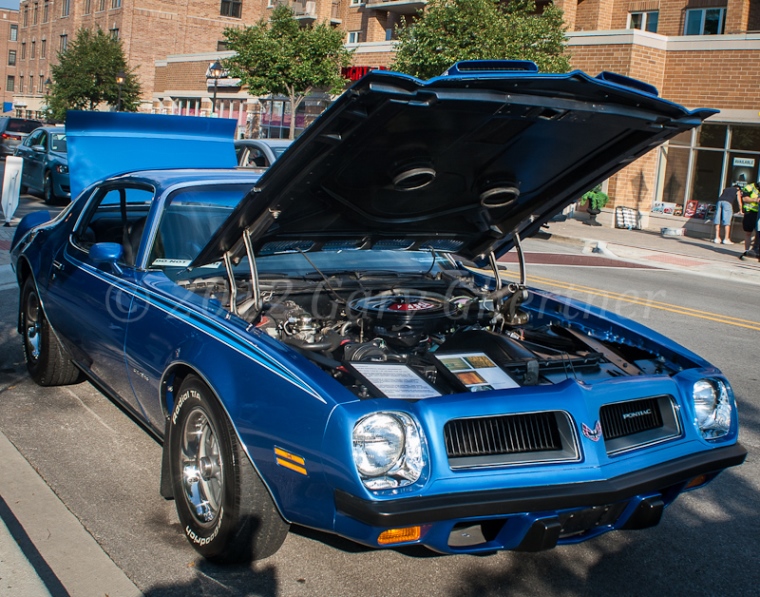

I just found a photo of a blue 74 with the stripe! I like it!
