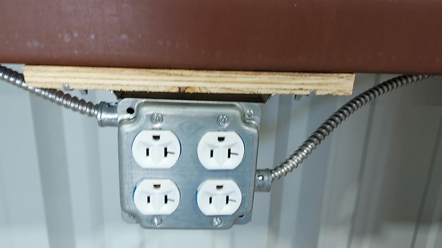

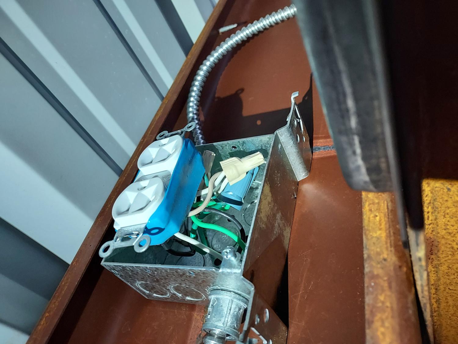

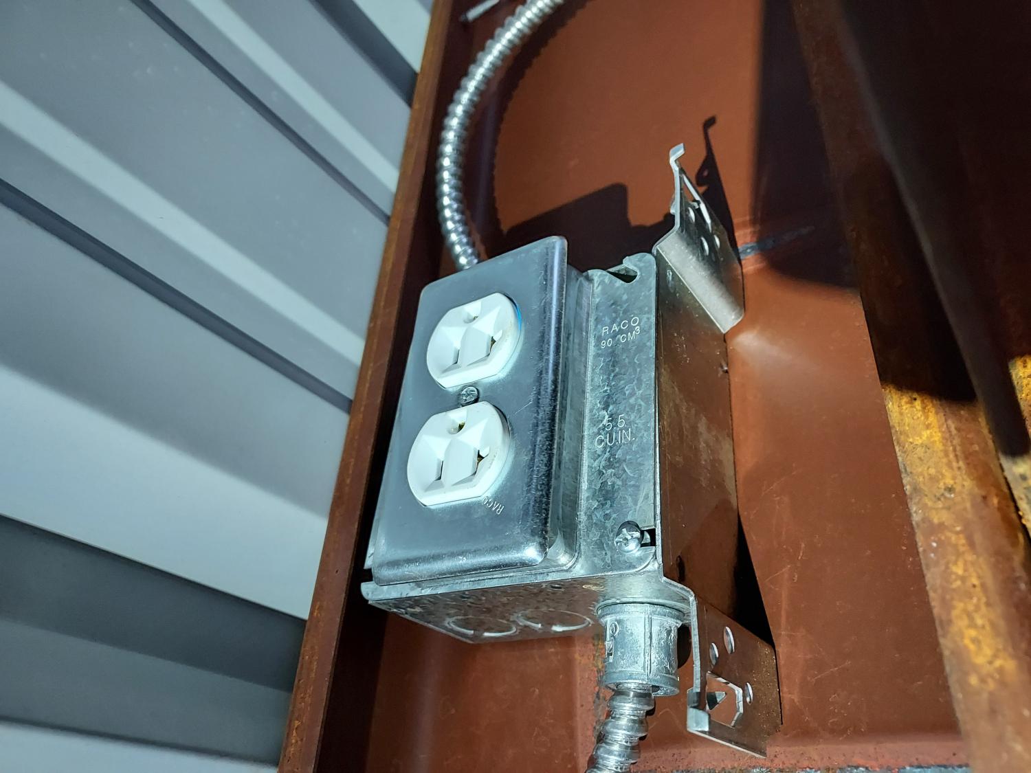

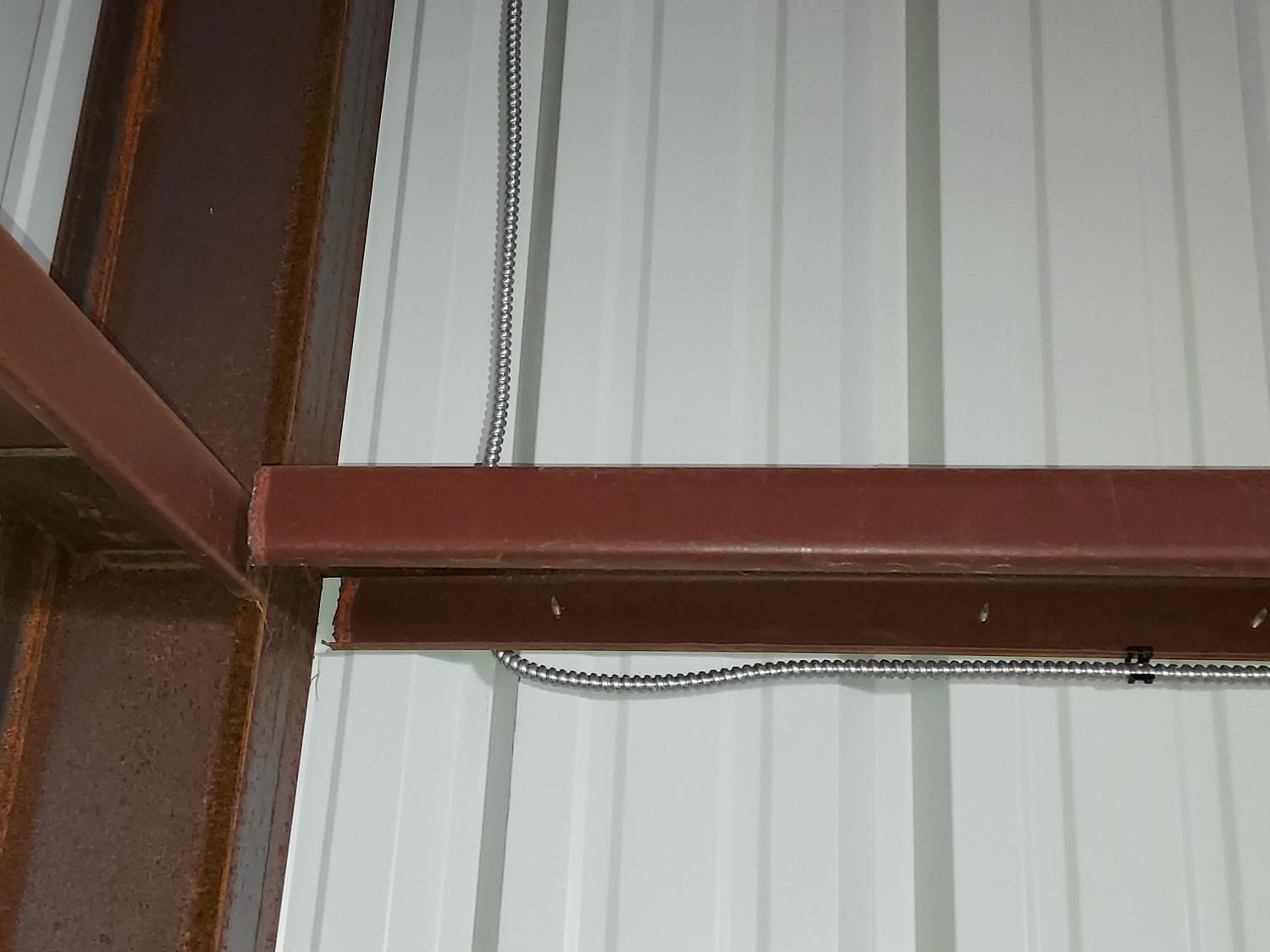

Getting started running power. Touch working off a 10' ladder. Pulled MC cable around to the man door. Getting a box ready with 2 switches. One for inside LED's and outside door light. Someone gave me a $500 roll of 12/3 in 1986. FINALLY have a place to use it. Probably cost $80 back then...LOL Came out of the man door box and up to mount 4 boxes for the lights. All 8 on one circuit will work. Got 3 done, last one today. THEN I can plug all the lights in and take down all the extension cords. ALL outlets 20amp. Even the switches are heavy duty 20amp. There will be no 14-gauge wire or 15amp outlets. I used full gang boxes with single outlet for more room in the box. Makes things a little easier in the air. I use the blue rubber protectors around the outlet, especially in metal boxes. Just an added safety thing. D

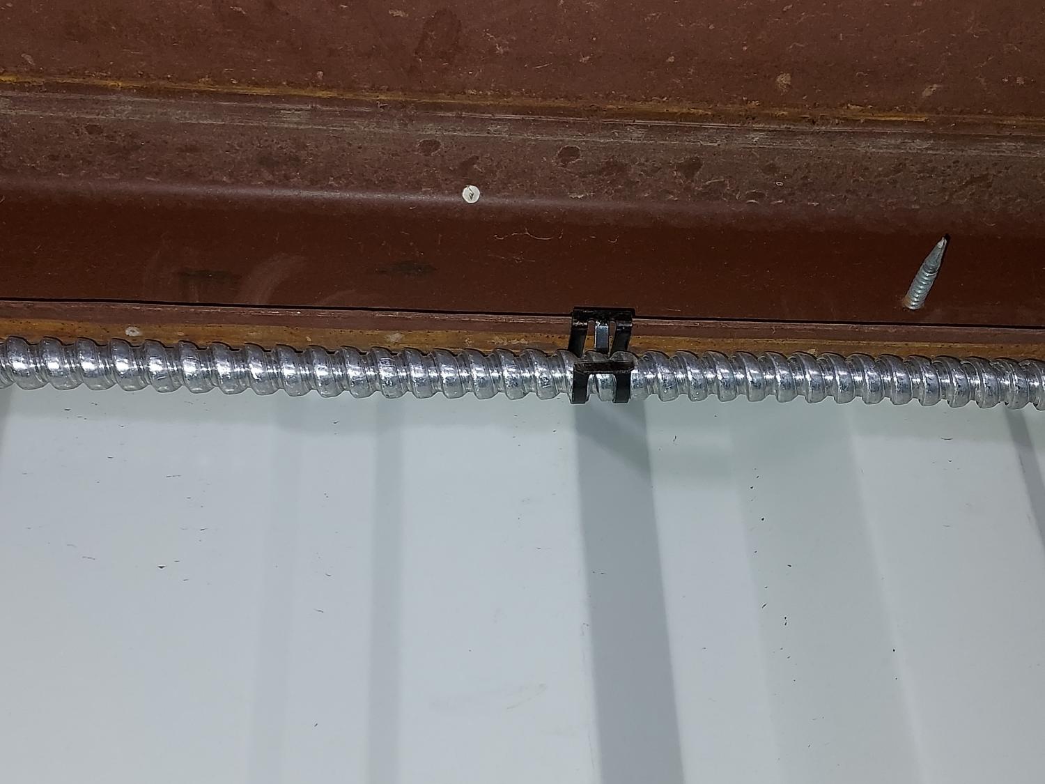

These little clips are slick. I bought an old dusty box, it had 95 in it. The counter guy said he had never even seen them before. I could buy the box now, or the new price updated would be $185 for the box. So it cost around $140 for the box. $1.44 each and worth every penny! D

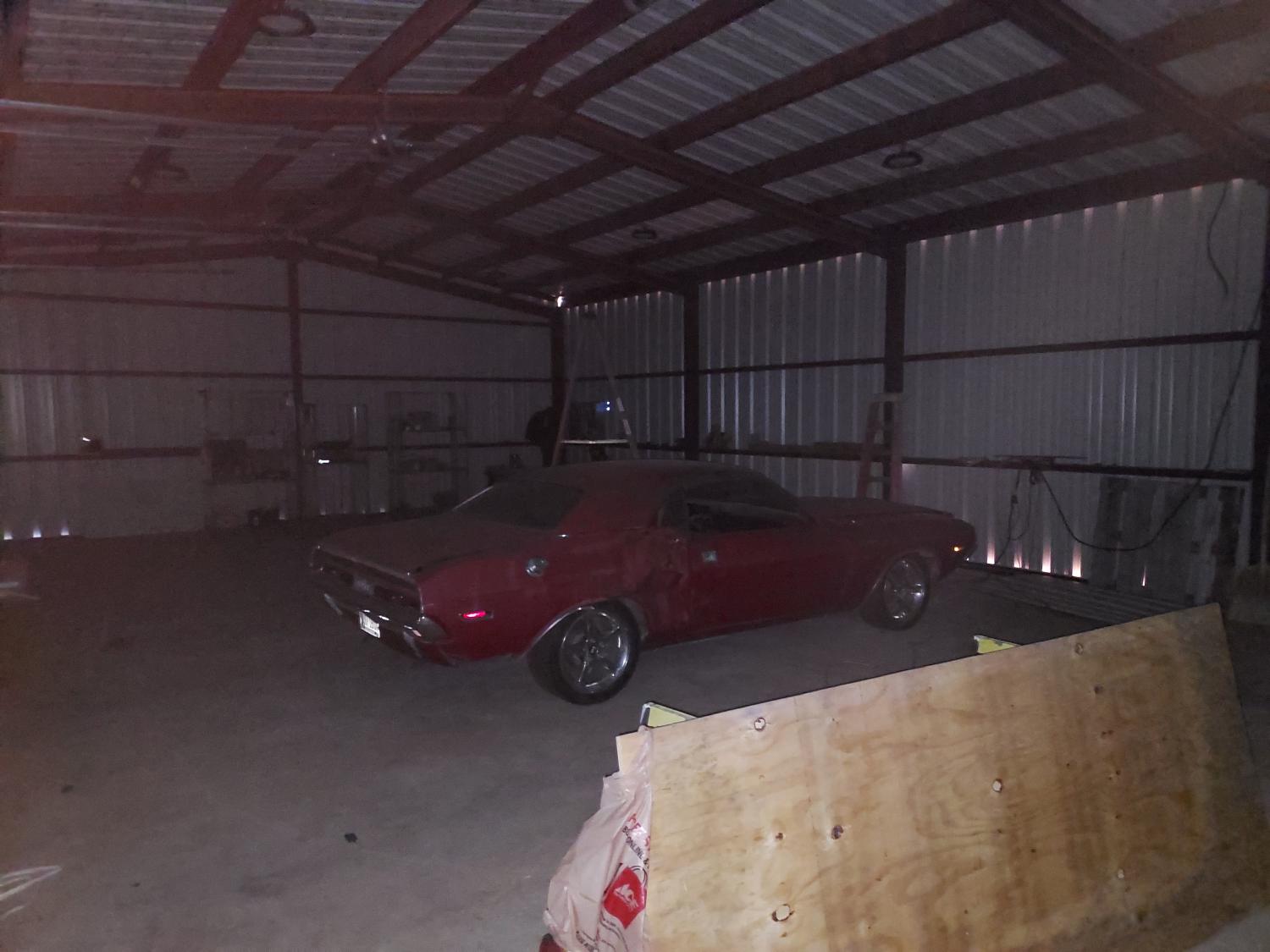

Finished wiring all light boxes, got them all plugged-in, and hit the breaker. BAM!! Almost good enough for surgery.
8 - 2,400 Lumens. First picture no lights, second picture with camera flash. Third picture with all 8 lights. No more headlamp. Time to start wiring outlets, lifts etc.... D

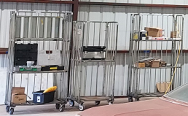

Saw one of these heavy-duty racks by a bunch of dumpsters. I asked if they were dumping it, the lady said yes. So I strained my balls and got it in my truck. Next thing I start seeing them out there every couple days. So my girlfriend and I started loading them. I ended up with 7 total. They are SLICK! They hold thousands of pounds. And roll like butter. Some are 3 shelf, some are 2. I organize tools on one, and materials on a couple others. I looked them up and they are 800 to $1,000 EACH! I wheel them around as I move around the shop. WAY better than a table. D

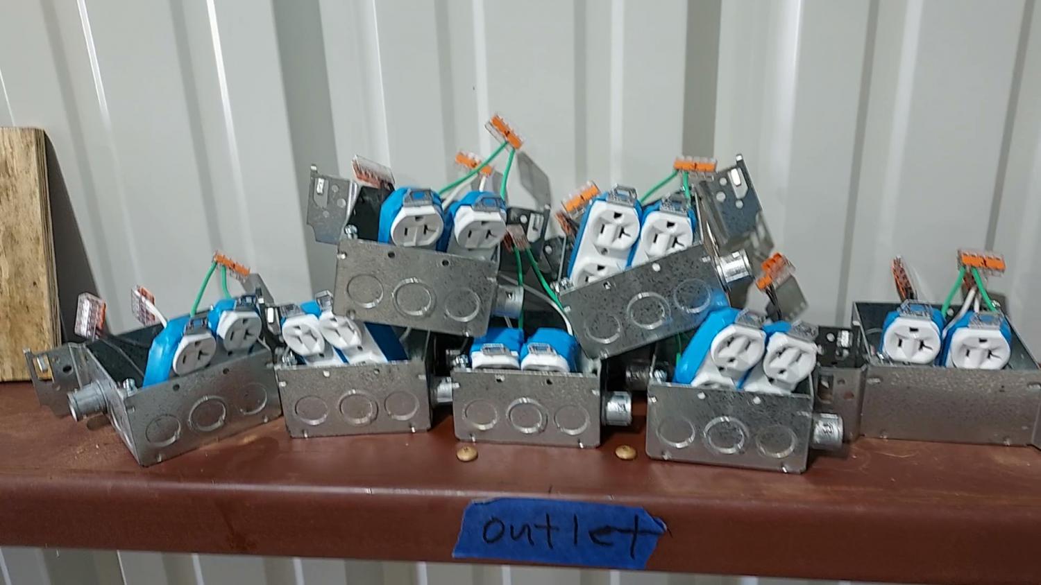

Got 12 boxes trimmed out and tested, all good. Now ready to start the other 12. Prefabbed up a bunch to get a jump on assembly trim-out.
Yes outlets are upside down, ground up on purpose. Anybody guess the reason why? Danny
