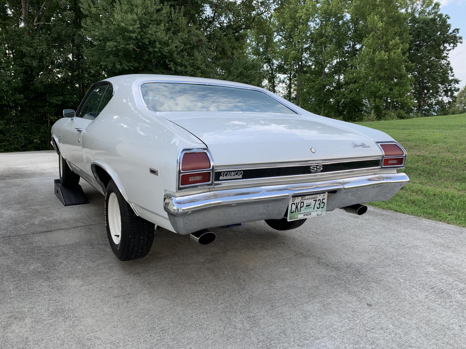

Car is coming along fine, if a little slow (I'm old). I've got all of the rear end back together. I put the rebuilt 'boxed' control arms on as everything was coming together also.
Things are looking good, I have a transmission pan that is leaking so I will fix it next, then on to the engine compartment.
