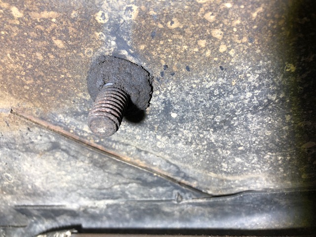

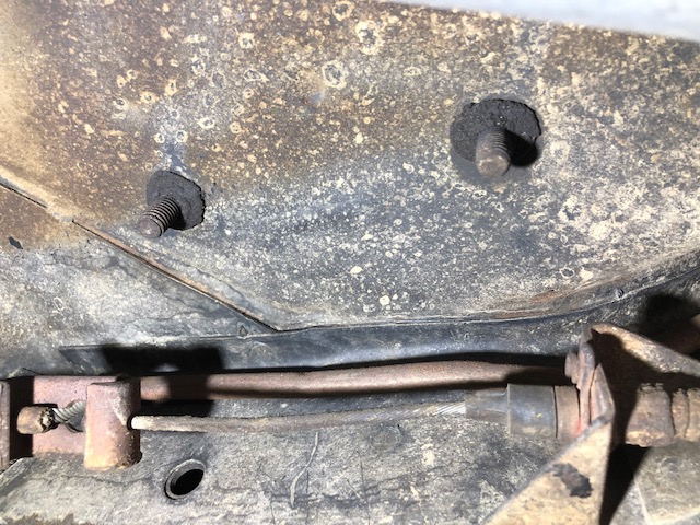

Is the front bracket for the bar there or just the two studs sticking through the floor?

I don't think powerglide cars got the bar.

No indication it ever had the bar.

Looked on camaros.org when I first saw the pictures.
camaros.org/radiusrodl
CRG says brackets were installed on cars that never got the bars. Many of the glide cars being among them.

I doubt if this car ever had the bracket.

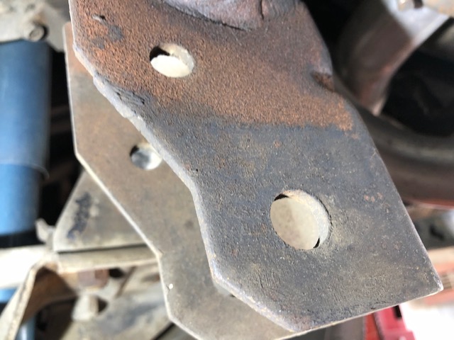

Charley, my '67 RS SS (350) with a powerglide looks exactly like yours regarding the radius rod brackets. The 2nd design axle bracket welded to the axle and no bracket installed on the underside of floor, just the 2 bolts coming thru the floor and of course no radius rod. My car is an 01D Norwood car.

CRG has seen quite a few of these cars with no bar and no front bracket and it was obvious neither were ever there.
