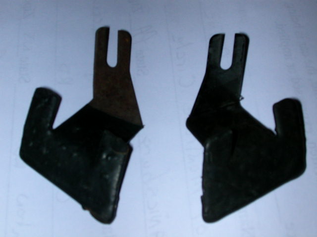

Jason, I have a used set if you need them.

Default Re: My new 1968 Nova L79 project.
I may need them.I will let you know. Those kind of look like the ones I have but have a notch on the top side. Is there a coating on them? After I posted I went back up to the garage and looked at another piece of trim with the original clip on it. I don't think I had the clip in far enough on the trim so the angle was off. So the clip wasn't lining up with the bolt. So know I have to bend that clip back because I tried every other option before walking away. I will try again tonight. I will figure it out.

Jason, These do have the ruberized coating on them, these are off a 69 Camaro.
