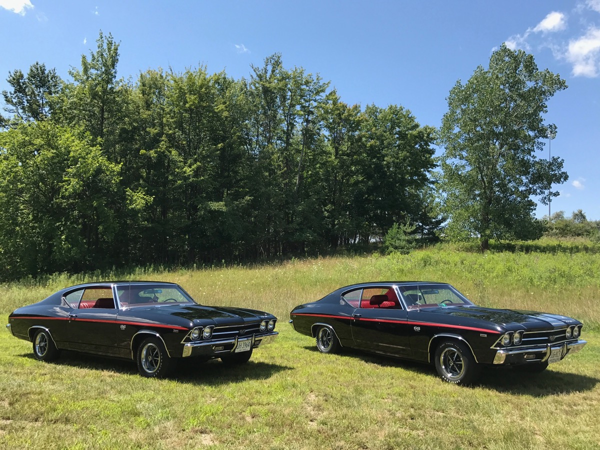

Super time at NOCC show!! Great people, neat cars, good grub! Finally got the "twins" together and they felt very comfortable for having never met before! Woj's is an INCREDIBLE specimen! Now time to prep for MCACN this fall. I asked Bill Schultz (Rita's hubby) to do another caricature like he did for my Deuce a few years back. True to form, he knocked it out of the park! The details of his art work should give you a clue to some of the day2 transformation that my Chevelle will under go.
Big thanks again to Grady for gittin' me there in style!!!....
Sam...

Nice to see both of you guys Sam and Phil.
Also nice to see these great survivors together:-)
The Day 2 plan is exciting, especially as your car was day 2 ed back in the day:-)
