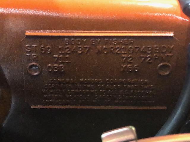

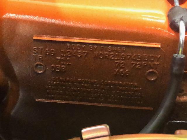

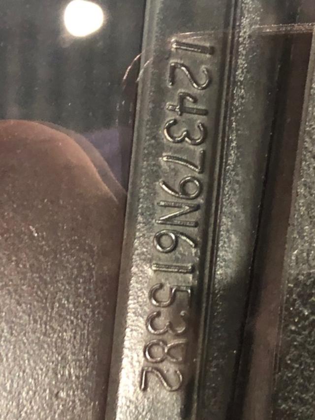

here are the VIN and TT pictures from the car today.

That's a pretty fresh TT

I know the guy who bought it sure looked happy. So other than the VIN tag how much of the original car did he actually buy? I never saw any pictures of the original car in racecar form when it was purchased in 2007, but apparently there were photos of at least one of the hidden VIN's. At that time the entire drivetrain was gone and I believe it had a fiberglass frontend. The car at Kissimmee appears to be the same car that I saw for the first time in 2005 at Mecum Chicago. Both cars existed at the same time so it's not like they can say the racecar was restored and this is it.
Are there any known Yenko's after the first 50 that were X66 cars from the factory? I know there are a couple of 02D cars that are supposedly X66 cars, but I have never seen their trim tags.

Please note the Yenko community has questioned the authenticity of Yenko Camaro YS9637 because several years ago two different cars claimed to have serial number 124379N615382. Early in this car’s life it was competitively drag raced. After retiring from racing, the car was placed in storage. Over the years, some major components were sold to different people. During the car’s most recent restoration, the all pertinent components were reunited. This correctly-restored Hugger Orange 1969 Yenko Camaro represents the pinnacle of performance that emerged from the muscle car era.

this Yenko was a racecar then parked. Parts were sold off and someone made a second car with the same VIN. AT THIS LAST RESTO, ALL THE PARTS HAVE BEEN REUNITED ON THE ORIGINAL RACECAR BODY???? Now I know from this site that is NOT the case, but that is they was I see it being represented. I think the $$$ are should that it's a rebody too.
I would say more than a bit misleading as they never stated that this is a rebody or NOT the original racecar shell restored.
