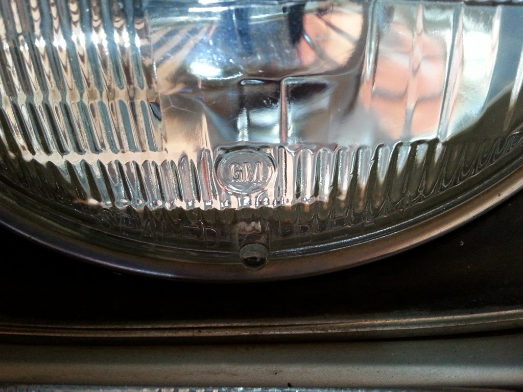

The lenses can be cut off burnt T3's and glued to modern bulb insert style headlights (with the plastic lens cut off). I did it but broke one of my set and haven't turned up a matching T3 lens to replace it... I put the repops in.
Thin cut off wheel working very slowly around diameter will cut off the lens... patience.
Glue the lenses on with clear silicone.
