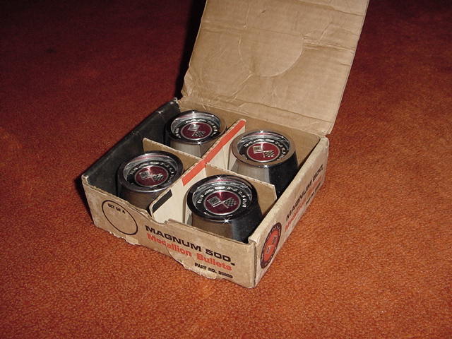

When Don Yenko installed the Magnum 500 14X7 wheel on the 1970 Deuces,did he use the Bolt on Center cap #3956770,or the later design spring clip cap #3983323?
Actually, neither of those are correct. the part number Yenko ordered was 35859, it was not a GM part number, but rather a MotorWheel part number, as the caps were purchased direct from them rather than through GM. Yenko bought these in complete sets of 4 in a box. He then added his own "Y" center decals over the Magnum 500 logos. Some cars didn't get the Y's originally, and were sold new with caps as shown below.

Old 10-19-2004, 01:44 AM
YENKO DEUCE REGISTRY's Avatar
Posts: 13,103
Thanks: 731
Thanked 376 Times in 147 Posts
Default Re: Yenko Deuce wheel question
Yep, and he bought those little boxes by the case

Old 10-19-2004, 01:47 AM
camarojoe's Avatar
Join Date: Sep 2003
Posts: 5,307
Thanks: 239
Thanked 273 Times in 121 Posts
I think it was mentioned in another post awhile back, but its also interesting to note that they didn't bother to remove the Magnum 500 logos, and the thin foil "Y" decals allowed the raised Magnum 500 logo underneath to show through.

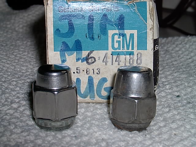

The 70 Camaro Z-28 15" (and possibly the Camaro/Nova 14" Rally) Wheel used a Stainless Jacketed Steel Lugnut. The 2nd Design sold by Chevrolet with same part # is a different shape than the 1970+ 1st design......just adding this reply for those that might possibly be interested...
1970 Originals had TALLER Crown....see pic !!!
Chuck Sharin

Old 10-19-2004, 02:58 AM
Posts: 13,103
Thanks: 731
The taller crown version is what came on the deuces, except in chrome. As you can see in Chuck's pic, the two nuts are very different. Is that tall crown nut in the pic chrome by chance? If it is, then that's probably what we need. We were believing that Yenko used aftermarket lugs of the day, which is why we could not find them!
Marlin
Old 10-19-2004, 05:05 AM
camarojoe's Avatar
Join Date: Sep 2003
Posts: 5,307
Thanks: 239
Both of the nuts pictured are stainless steel capped. I would bet Yenko bought chrome ones from the tire shop across the street, and wasn't buying them through GM.

Old 10-19-2004, 07:24 PM
Posts: 13,103
Thanks: 731
That's what I was afraid on the nuts Joe, but was hoping that the high crown one was a chromie - bummer! I'm back to thinkin that Don got aftermarket lugs locally.
