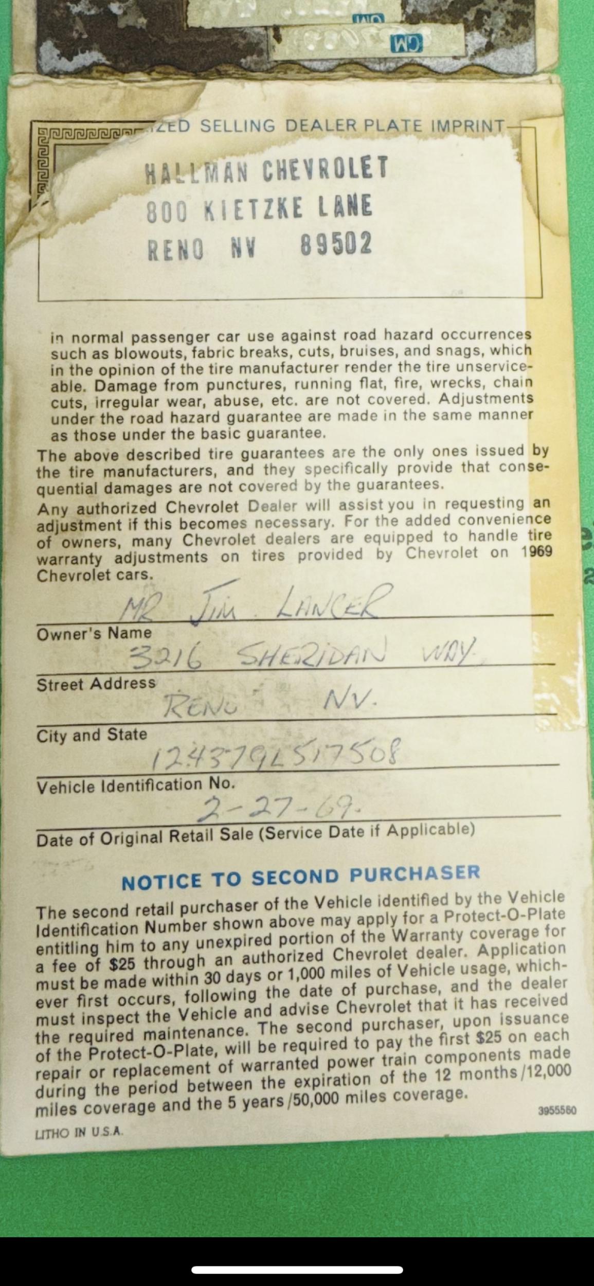

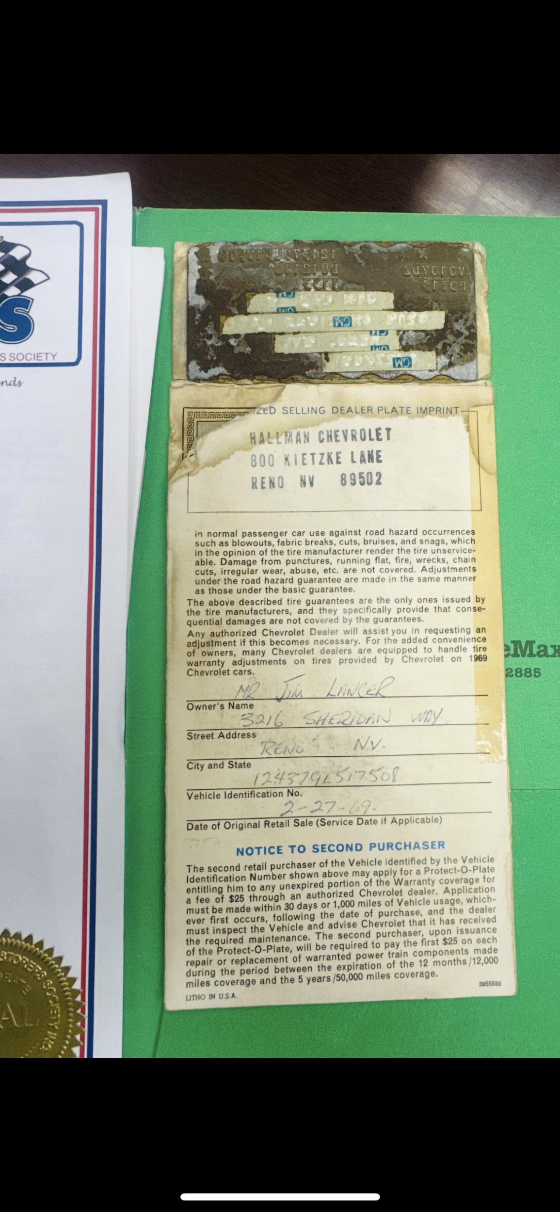

Hmm. I just came across a 69 Z28 that was fake as can be and it had this POP that was aged and faked, look at the handwriting on this one and the one above. It looks the same or am I seeing things?
The dealer ink stamp can be easily made up. Fraud is so rampant now.

Here’s the POP from same z28 out of WV

Go to Zillow and type in that address. It does not exist. The fakers RARELY use a valid address. The really good fakers find someone who is deceased, and make sure no relative lives in their old house. Then they create a fake story with a real address and the actual name of someone who lived there. That was the case with the made up 69 L89 Camaro down in Florida a few years back. The guy went to great lengths to create a story, use a real address and fake all the docs, POP, dealer contract etc.
When the car was exposed on this site, he even had a shill come on here claiming to know the original owner. All pure BS. The car brought $200k plus at a Mecum auction.

On the POP that Jonesy posted above, I'm thinking that two-letter state abbreviations were not yet in common use in 1969, which would support the theory that it has been faked.
